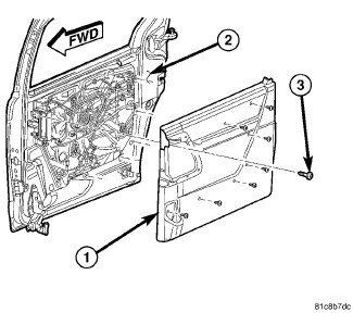

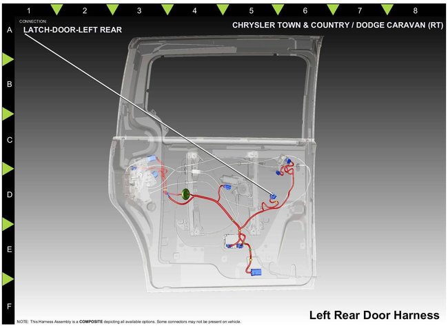

The power lock works on all doors except the rear passenger sliding door. I tried to lock an unlock using the remote but it does no work. What must be the problem? Thanks
Feb 22, 2018 at 6:27 PM
STEVE W.
  • 15,351 POSTS
If you do not hear it operating inside the door but the manual button works then it is likely to be either a bad lock actuator or the wiring harness that feeds into the door. To test which you need to remove the inner door trim panel and use a test light at the lock actuator itself.
If you find power at the wires to the actuator when you hit the controls then it is the actuator itself. To verify that you could use a simple nine volt battery jumped to the actuator connector itself, one direction would lock the door reversed will unlock.

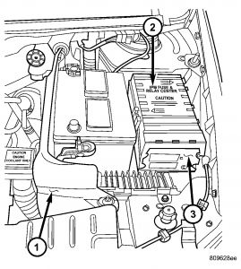

power locks not working and do not see fuse in engine compartment, help
Oct 3, 2020 at 3:12 AM (Merged)
ZACKMAN
  • 4,202 POSTS
Left front of engine compartment, inside the integrated power module (#2), check fuse 19 (40A) and fuse 14 (20A).

The main power supply for the power door lock control is via the #19 (40A) fuse in integrated power module located at left front of engine compartment.
The power lock system receives non-switched battery current through a fuse in the Integrated Power Module (IPM), so that the power locks remain operational, regardless of the ignition switch position.
