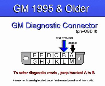

some pre1995 are OBDI and some late 95 are OBDII compliant.it should be a sticker under the hood.
let make it simple,
run a jumper wire or paper clip between A and B
https://www.2carpros.com/forum/automotive_pictures/46384_obd1pinout2_1.gif
Next turn your key on but don't start. Watch your check engine flash the code/s.
EXAMPLE: CODE 12: one long flash and two short flashes
CODE 13: one long flash and 3 short flashes.
If you make mistake reading the codes,my diagnosis will also be wrong.
Tell me what you got?

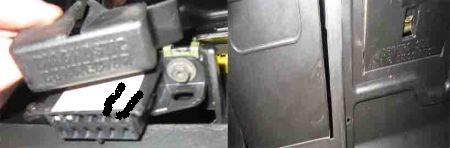

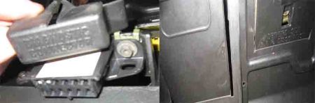

DERICKSEN
  • 8 POSTS
Well that's where I searched and here's what I found there's just some wires in those two pull down parts and the diagnostics connection
https://www.2carpros.com/forum/automotive_pictures/510510_Diagnostic_connection_and_panels_1.jpg

MATHIASO
  • 1,209 POSTS
https://www.2carpros.com/forum/automotive_pictures/46384_510510_Diagnostic_connection_and_panels_1_1.jpg
connect paper clip or jumper wire , follow the instruction above and come back with result.

DERICKSEN
  • 8 POSTS
Tried it and nothing happen I took the picture up side down but I also tried it in every other hole and nothing just the seat belt light flashed about 45 times because I wasn't wearing it.
