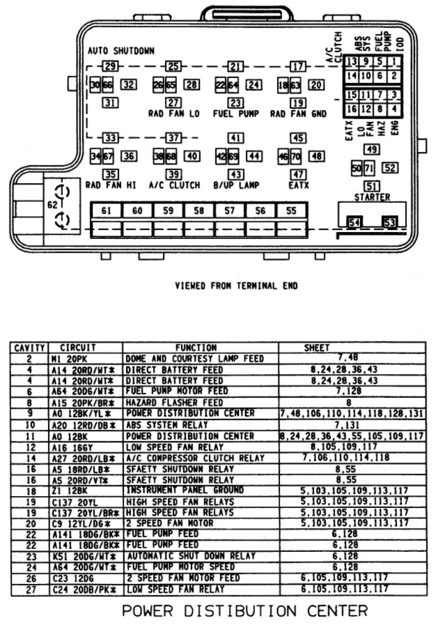

My 1995 plymouth grand voyager died going down the road with no warning. Replaced fuel pump. Checked fuses. Checked for fire. No fire. Replaced coil still no fire. What's next?

This sounds like the ASD relay has stopped working which is common on these cars.
Here is an guide to help you check the relay once you find it from the diagrams below

So good, that did the trick thanks for your help I love this site.
