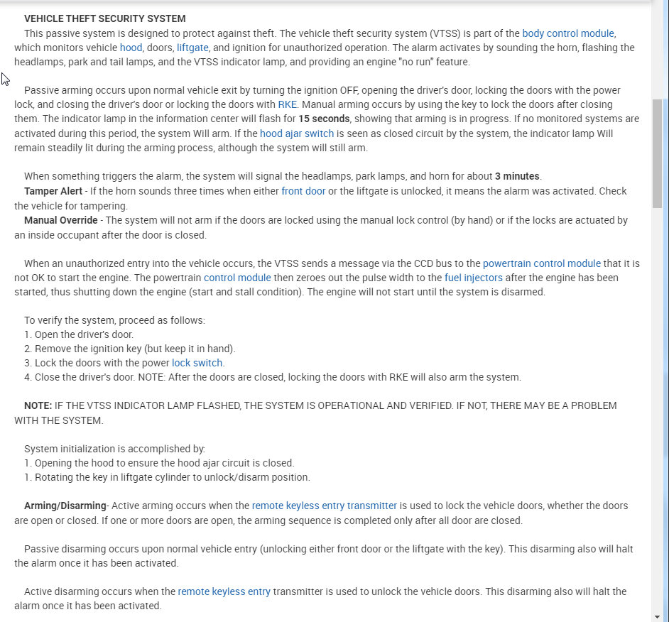

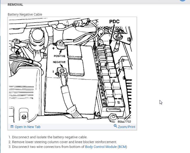

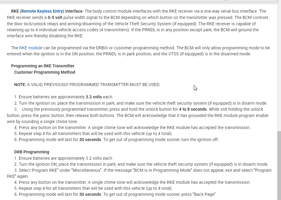

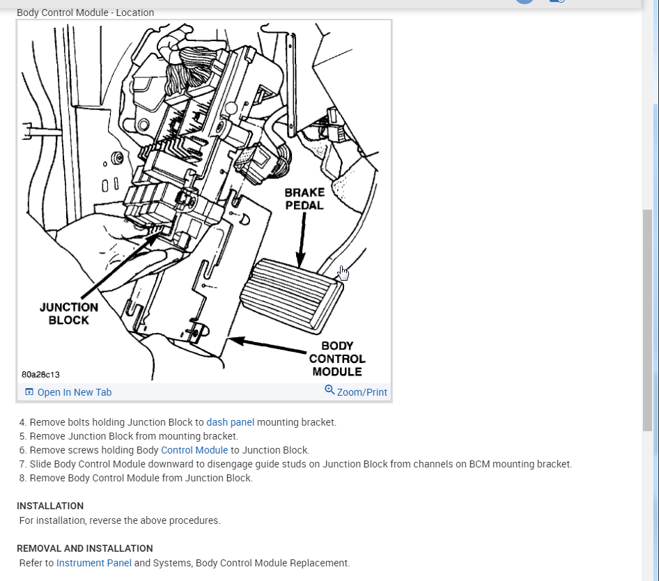

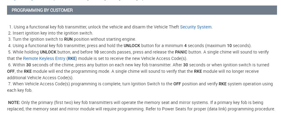

MJBEEVE
I am having the exact same problem with my 1999 Voyager. Replaced the BCM and all other functions worked (door locks, etc.) But the van would not start. Put the old one back in and it started but same issue with gauges and lights going out then after the 4th day, intermittent starting again. Ordered a new BCM and gauge cluster and is being worked on now but still the same issue. When it wont start, it's because it's not registering the security to shut off when hitting the unlock button on key fob so it allows it to start but quickly shuts off because it's not disengaging the security. Its has been a royal pain and still not getting ahead with anything. Any advice is welcomed!
May 21, 2020 at 8:09 AM
Okay. When putting the BCM in you need to program the vehicle theft system. You can try to run through this process that I attached but if that does not work then you will need a scan tool to scan for codes and see if there are issues. If no codes then you can use the scan tool to disarm the system.
Let us know what they are doing to program the theft system after replacement and we can go from there. Thanks
