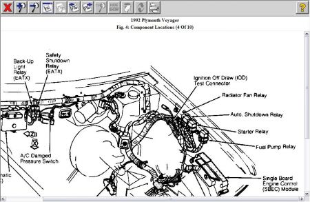

I have a 92 grand voyager it turns over just fie but wont start. It feels like there id either no gas getting to the engine or no spark I unpluged the BCM and pluged it back in and checked all thr relays and fuses and it still wont start. Like I said it turns over just fine but that is it. Any ideas. :X

Disconnect a sparkplug wire ground it to the engine and also listen to the injectr/s -do yo have spark and injector/s clicking. If not investigate the ASD relay this is the one that powers the coil/injector/s and fuel pump.

Where do I find the ASD relay when I open the hood. I am sorry I am a R.N. And not a car mecanic at all. Thanks. I think it is a 3.3L v-6.

Get a helper to turn key while you touch the ASD relay it should click-don't worry it doesn't bite-no click could be the computer not energizing the relay.
https://www.2carpros.com/forum/automotive_pictures/12900_asd_relay_1.jpg
