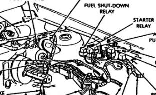

JDL
  • 16,098 POSTS
https://www.2carpros.com/forum/automotive_pictures/170934_starter_relay_1.jpg
If you think the problem might be the starter circuits, you could do some testing at the relay. Looking under the hood, driver side strut tower, second relay from left. The wiring colors on the connector should be black--brown--red--yellow. The black wire is hot all the time, the yellow wire goes hot with the key in the crank position.
Did you try cranking in neutral? Battery has full charge? Battery cables/wires all clean and tight on both ends?
Friday, July 24th, 2020 AT 6:21 PM (Merged)
