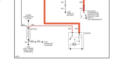

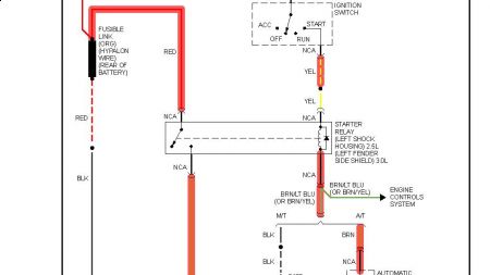

DESCHUTES606
I was hoping someone could help me out with my 1991 Plymouth Acclaim will not start. I turn the key over and it makes no noise but the check engine and oil lights come on. The windshield wipers still come on but the car does not start. Please help me! Thanks for your time.
Jul 24, 2020 at 6:20 PM (Merged)
  • CERTIFIED EXPERT
  • 75,992 POSTS
Hi deschutes606, Welcome to 2carpros and TY for the donation I turn the key over and it makes no noise Start by making sure the battery condition and connections are good. If okay check and test the orange fusible link at rear of battery,starter relay and ignition switch. See Starting system EWD below
https://www.2carpros.com/forum/automotive_pictures/12900_s1_42.jpg
https://www.2carpros.com/forum/automotive_pictures/12900_s2_39.jpg

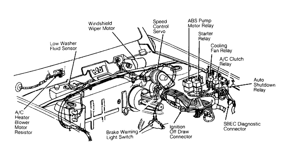

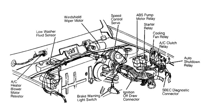

I don't have 12v at the coil before during or after cranking. Someone told me it could be a maxi-breaker? There are 5 Maxi-breakers on the wheel well. I don't know which is for ignition. Any Ideas??
Jul 24, 2020 at 6:21 PM (Merged)
JDL
  • CERTIFIED EXPERT
  • 16,098 POSTS
Below is the location of asd relay.
