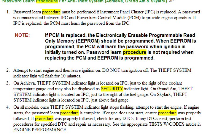

WALTER LARSEN
  • 6 POSTS
I figured it out. Just had to leave key turned to on position for 10 minutes, then turn off and start car. Was the passlock system.
