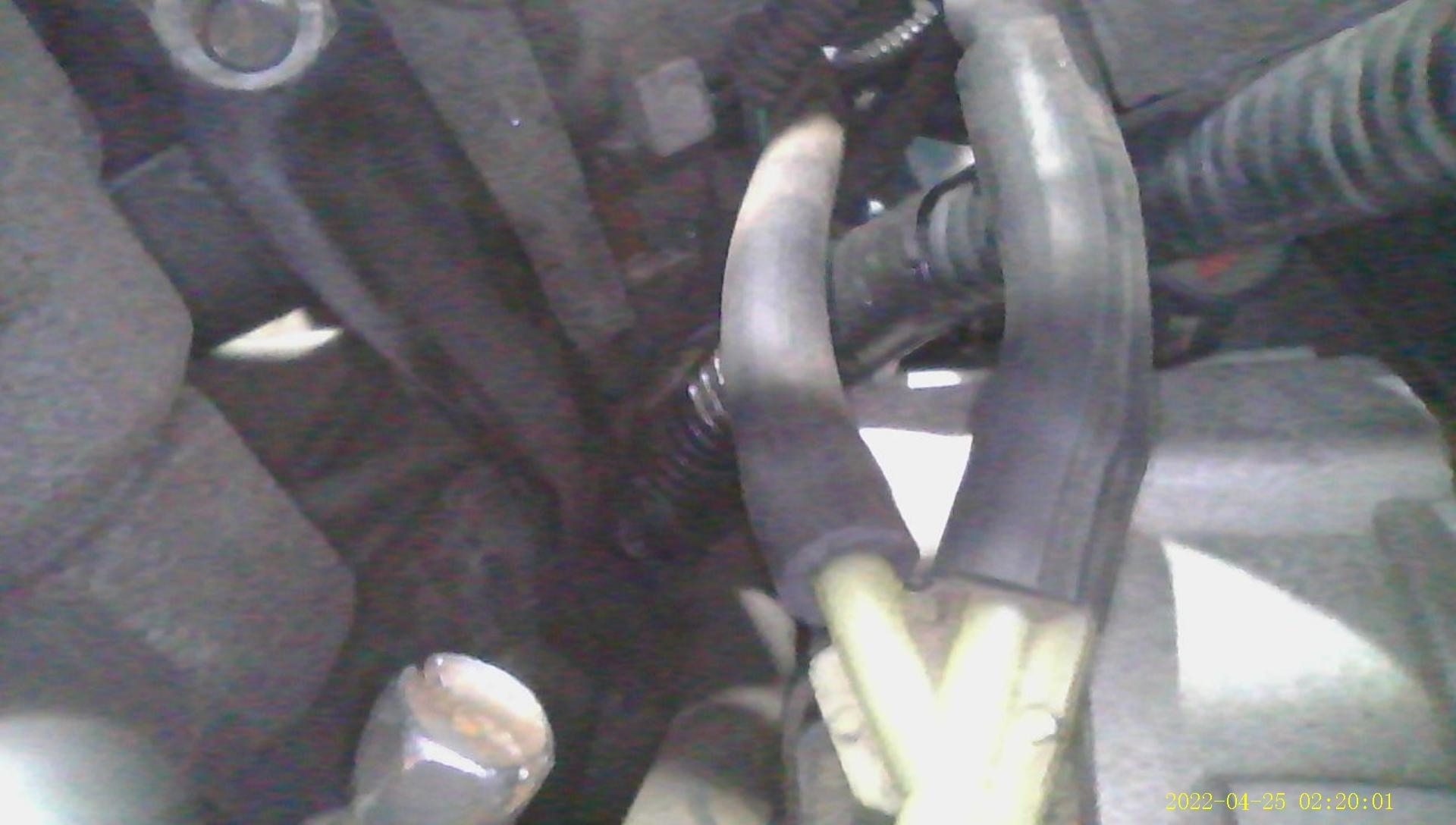

Also, if you could, take a pic or two of the vacuum hoses that you replaced so I can determine if there is an issue there. It doesn't make sense that it runs worse.

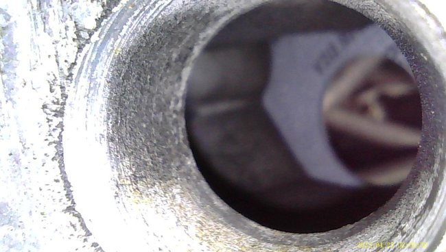

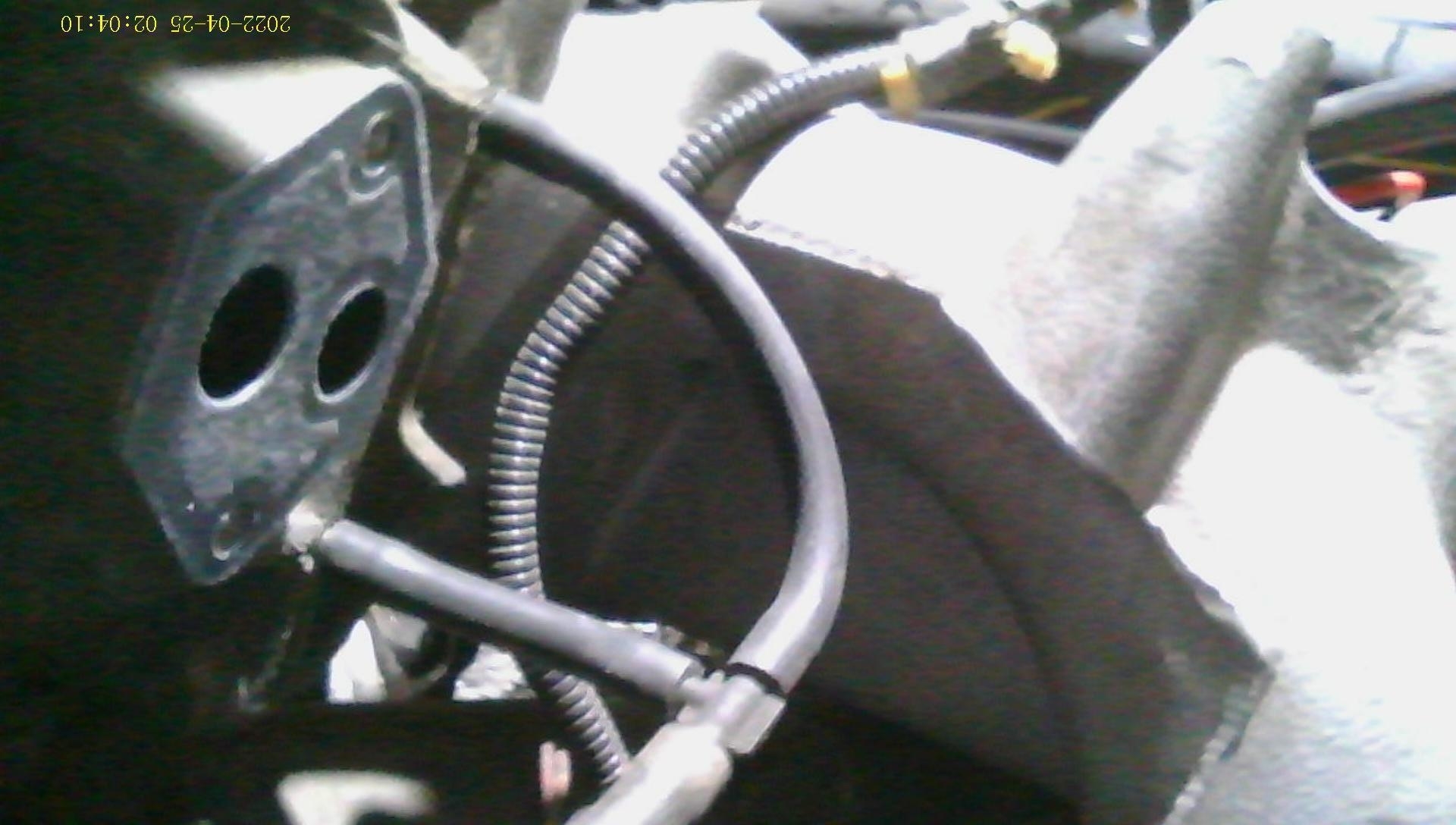

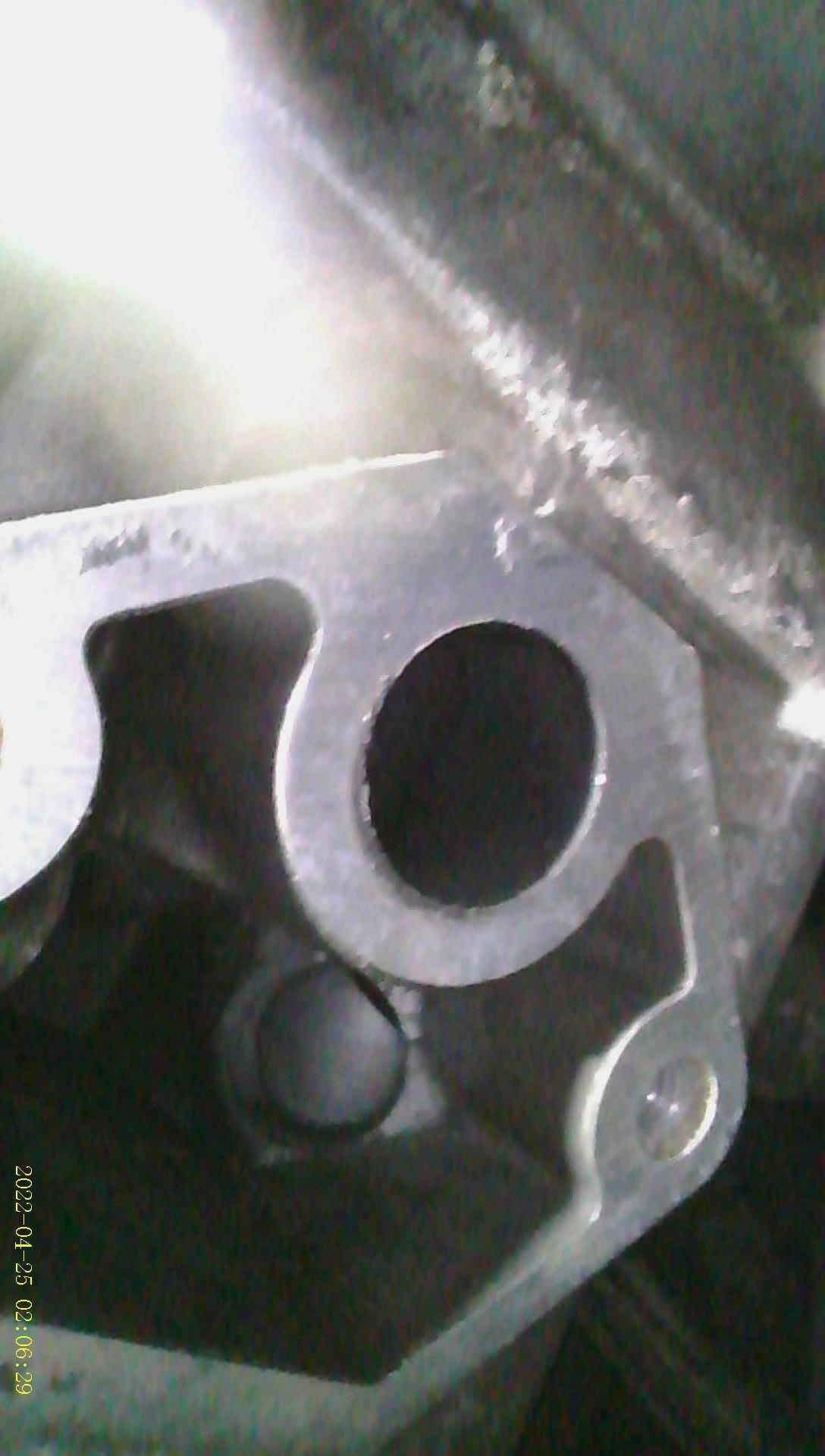

Hey Joe, I took off the IAC valve and inspected inside with a borescope. I can't see anything. I've attached some pics of this and of the vacuum lines I replaced. They are from the vapor canister (starting at a Y fitting) to upper and lower ports on throttle body on the driver side.

Wow, I think that's the cleanest one I've ever seen. LOL And there are still no codes related to the engine? Just for curiosity, how many miles have you driven the vehicle since the PCM was replaced?

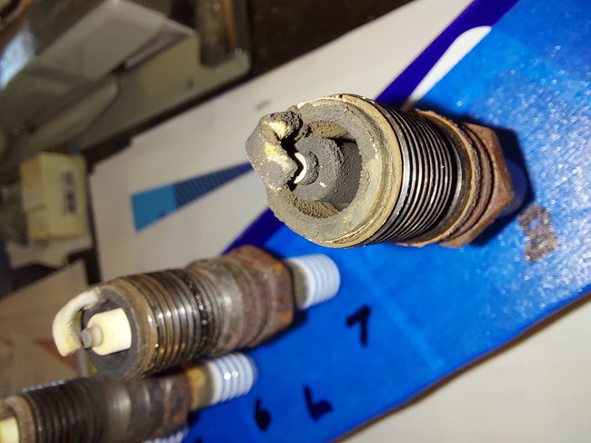

No change. Since the roughness seems rhythmic and not random, I'm leaning toward a plug, wire, cap or injector. I pulled all the plugs this time and seven look good, only one (cylinder 8) seems fouled. I'm attaching a photo. Let me know your thoughts.
Also, the plugs I pulled, Motorcraft AGSF 32C, are not the correct plugs for this 5.8l motor. Per my owner's manual they are supposed to be ASF 32C. While they are both copper electrode plugs, the threaded ends look to be different lengths. At least what a photo of the correct plug shows. I ordered a platinum tip Motorcraft replacement SP-501 which is supposed to be an upgrade to the ASF 32C.

In the picture, I see two plugs. The cleaner one looks normal. The corroded one has me a bit concerned. That appears to be either oil-fouled or coolant-fouled. Did you ever notice any blue smoke from the exhaust or if the coolant gets low?
Take a look through this link specifically at step 2. Read through it and let me know your thoughts.
https://www.2carpros.com/articles/how-to-check-for-ignition-spark
Keep in mind that cylinder 8 is one of the furthest back from the water pump. As a result, they tend to run hotter. This can cause wear to occur faster than in the forward cylinders.

All the other plugs look the same as the one good one in the photo. The carbon fouled looking plug was not wet, although it hasn't been run in a while.
I have never seen any smoke from the exhaust or smelling gas or coolant.
I don't have a coil on the plug ignition system, as demonstrated in your linked video and test procedures. I can't swap any plugs now since I broke 2 getting them all out. I
had such a hard time getting them to turn. I thought they were seized. They have been there for about 15 years (30,000 miles). I had to use a 1/2" impact through the fender well on two, hence the breakage. I should have the new ones tomorrow. I'll also try and scope the cylinder.
