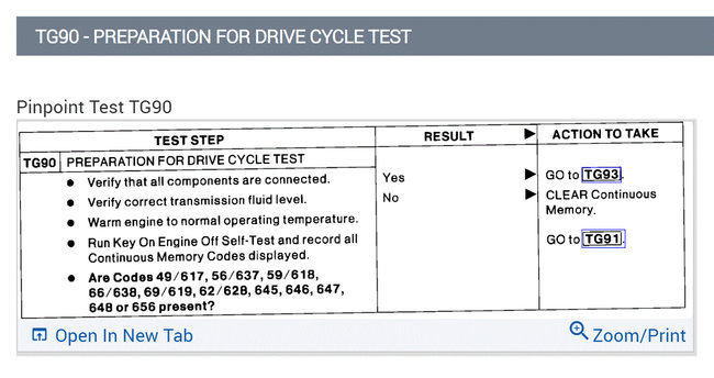

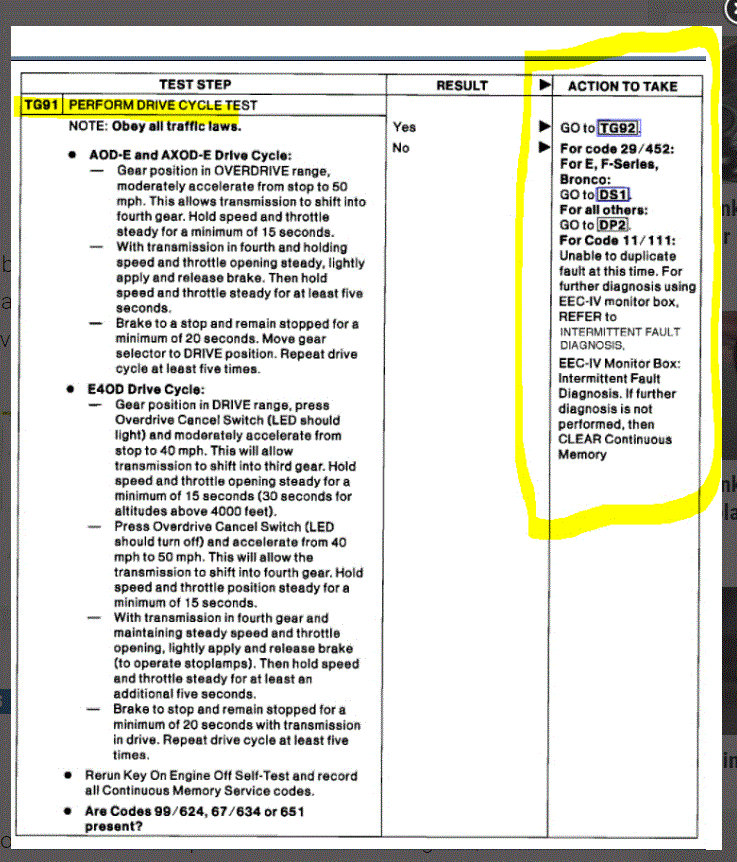

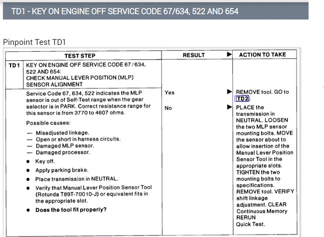

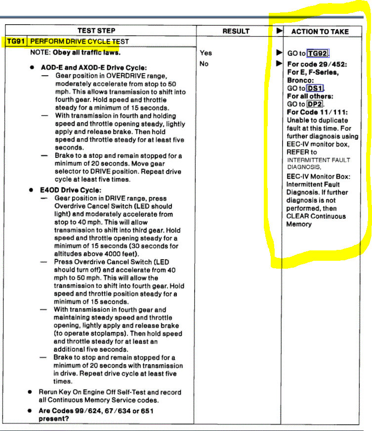

The codes you have (111 indicate everything passes), 628 excessive converter clutch slip, 634 is specific to the MLP (manual lever position) switch. It is on the side of the transmission and changes resistance signals to the PCM based on gear selection. The code is specific to a variation in signal resistance when in park, so I don't think that is the cause. Pic 1 below provides the diagnostics and possible adjustments.
The excessive clutch slip has a list of diagnostics. However, I don't see how that is causing a rough idle.

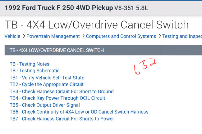

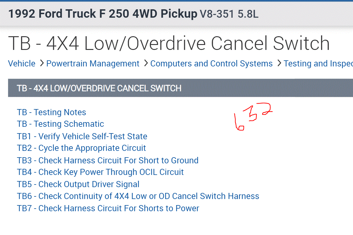

Regardless, starting with pic 2 are the diagnostics related to the 628 code. Here is the issue. The steps have you check something and based on the results; it takes you to a different test. I was able to get you through the first two because I know what you have already told me. However, after that, I need to know the results of test 2 so I take you to the next correct test.
Take a look and let me know your thoughts.

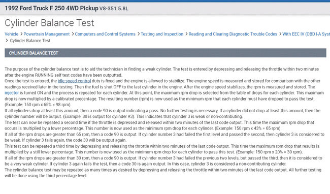

According to my Innova code reader manual, one test the ECC-IV can perform is what is called a cylinder balance, where the computer shuts off each injector to see if there is any noticeable change and will identify the cylinder, but I can't get it to do it.

Your instructions for the cylinder balance test are the same as the ones I've been following. When the KOER test is run, I get all the way through until it shows 111, then I get a code 10 and I press the acc. pedal. There is no rise in RPM where and when each injector is supposed to turn off, etc. Some procedures say to lightly press the pedal and my Code reader says to push it to the floor. I've tried it both ways many times, but still nothing.

When the cylinder is shut down, it should lower RPMs. Also, code 10 should be related to a cylinder 1 issue or a wide-open throttle issue. Pull cylinder 1 spark plug and let me know what it looks like.

The code reader manual says that a 10 is not a fault code. It is only a separator between tests and stored continuous memory codes.
I watched a YouTube video of the cylinder balance test. The engine rpms rise to about 2000 then the computer starts shutting off each cylinder and you see the RPMs drop. It's very obvious. But I can't get it to do it.

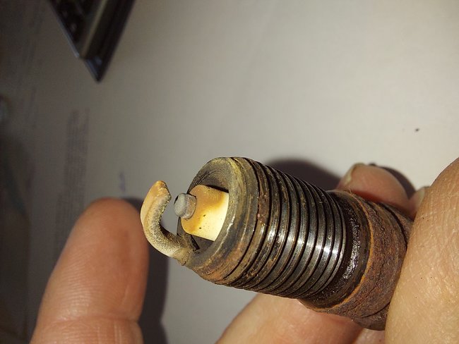

I am attaching a photo of the spark plug.
Mar 10, 2022 at 4:53 AM
  • 110,251 POSTS
The plug appears normal. The only other thing I can think of is if there is an intermittent issue or there is a timing issue. You checked compression, correct? In reality, this doesn't even seem like a possibility based on what led to it. However, either we are missing something really simple, or something was changed when the pan was off. Which again, really makes no sense.

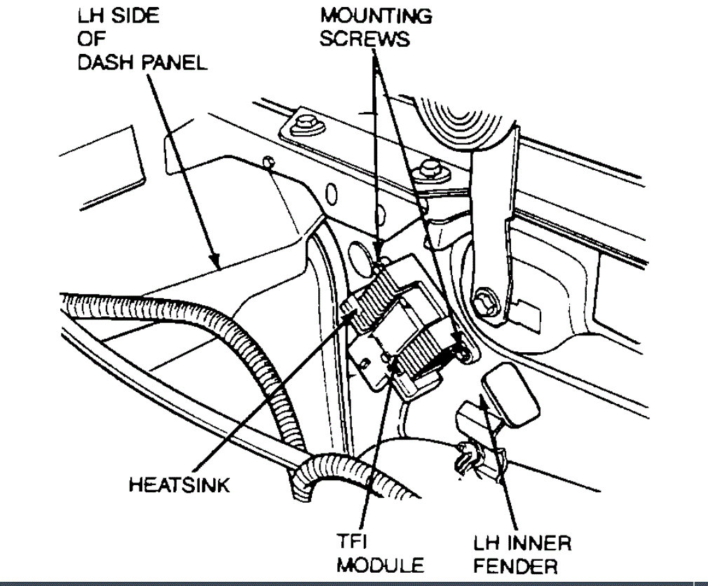

Tony, I'm sorry to hear you are still dealing with this. Not being there makes it difficult when you don't have codes. Have you checked the ignition control module connector to make sure nothing has come loose and confirm where it mounts (ground) to the body isn't corroded?
See pic 1 below for the location.
See pic below.

The ECM and heat sink look fine.

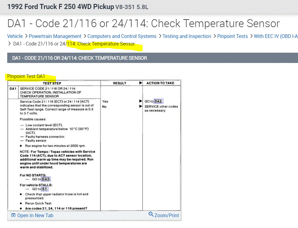

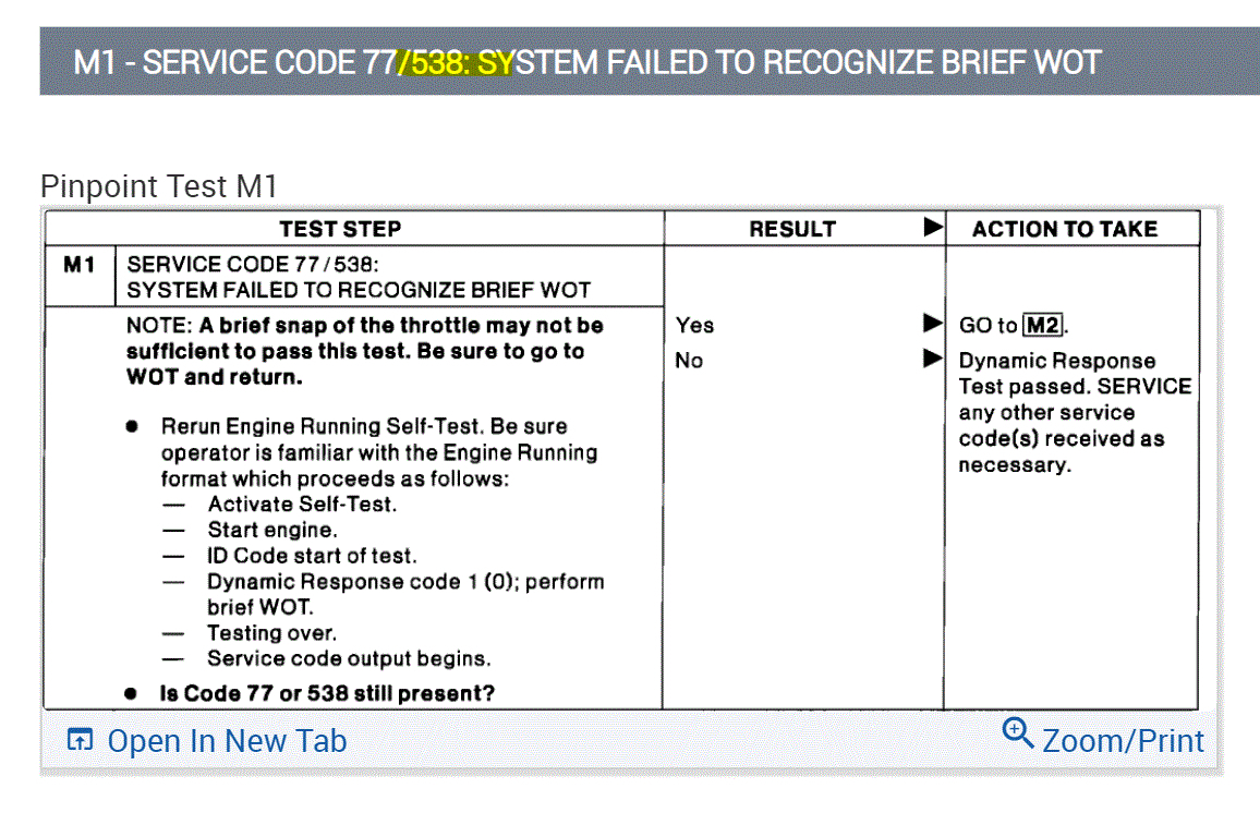

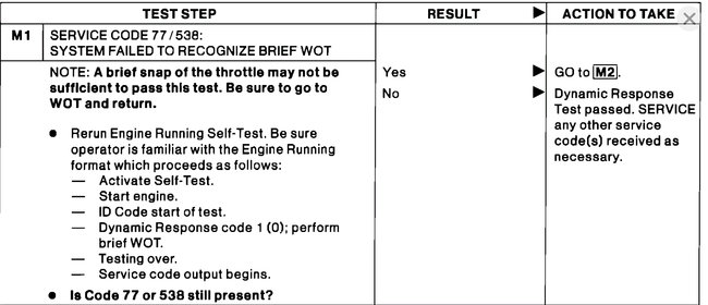

The codes appear to all be related to the dynamic response test. Take a look at pic 1 with the new code.
Here is what I suggest: I need you to perform the test in pic 2 and let me know the results so I know which direction to go next.
Let me know if you are comfortable performing the test.

I think we went down this road before. According to my Innova Codes, there are two listings for code 538. One is for the issue you are referring to and one is labeled (Trucks Only) "Invalid cylinder balance test due to throttle movement during test". And I never touched the throttle.

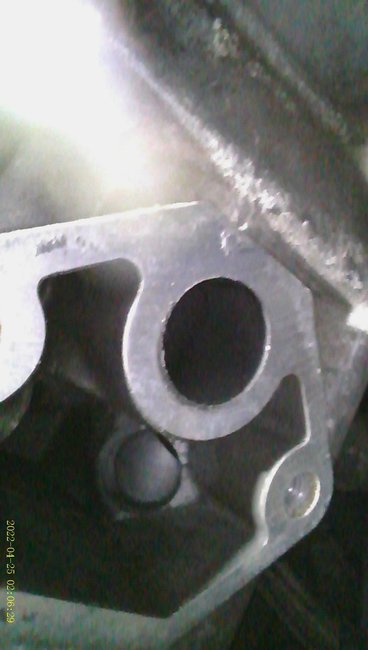

When you had the IAC off, did you inspect where it mounts on the throttle body to make sure there is nothing causing a restriction?
Also, are there any new codes since it started running worse?
Apr 21, 2022 at 9:33 AM
ANTHONY ALOI
  • 58 POSTS

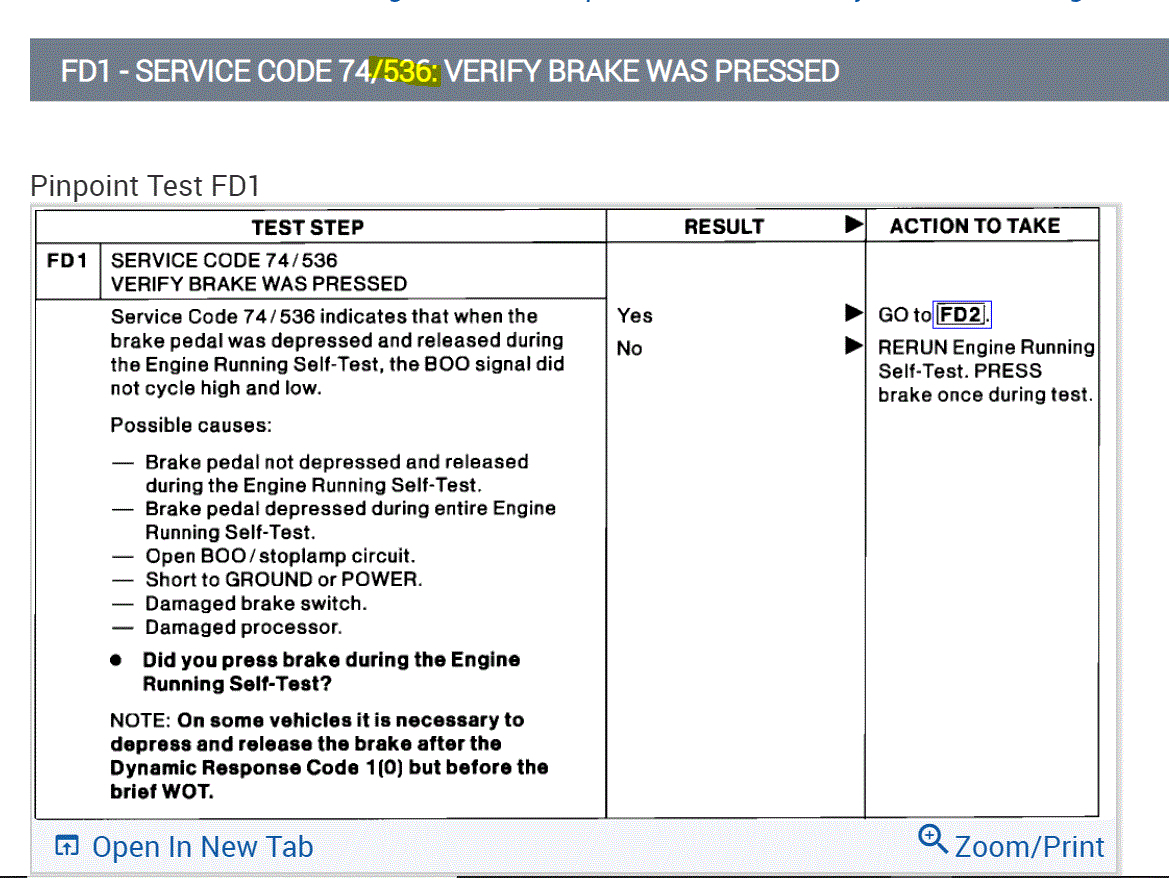

Joe, I didn't look into the TB. And no Codes except when I run the KOER test, I still get a 538 on the first test and not on any subsequent test. Could this be an injector issue and not throw a code?

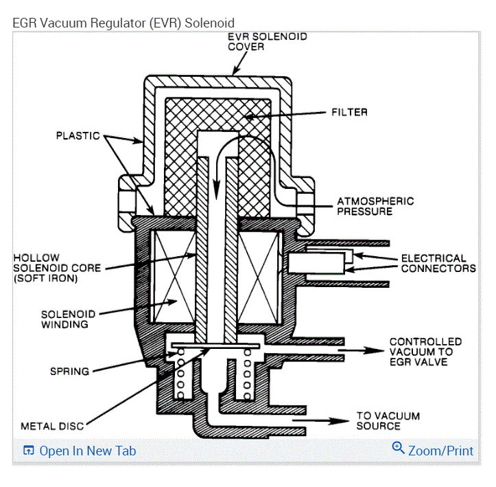

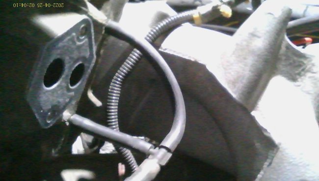

Also, if you could, take a pic or two of the vacuum hoses that you replaced so I can determine if there is an issue there. It doesn't make sense that it runs worse.
Apr 22, 2022 at 11:18 AM

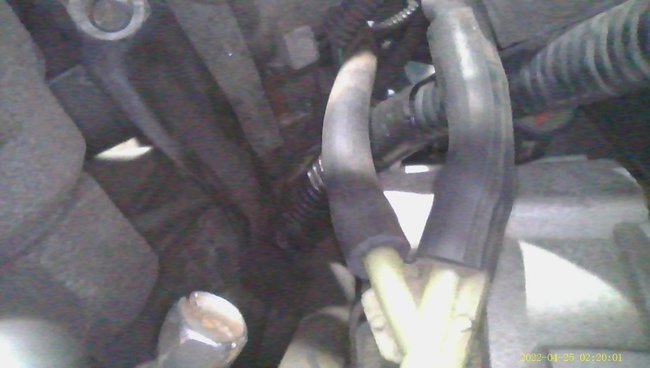

ANTHONY ALOI
  • 58 POSTS

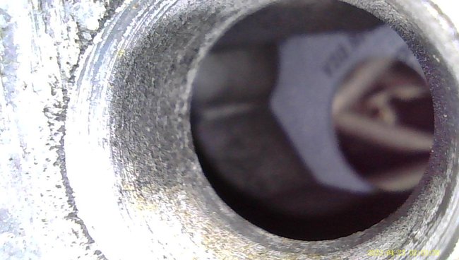

Hey Joe, I took off the IAC valve and inspected inside with a borescope. I can't see anything. I've attached some pics of this and of the vacuum lines I replaced. They are from the vapor canister (starting at a Y fitting) to upper and lower ports on throttle body on the driver side.
Apr 25, 2022 at 6:17 AM
  • 110,251 POSTS
Wow, I think that's the cleanest one I've ever seen. LOL And there are still no codes related to the engine? Just for curiosity, how many miles have you driven the vehicle since the PCM was replaced?

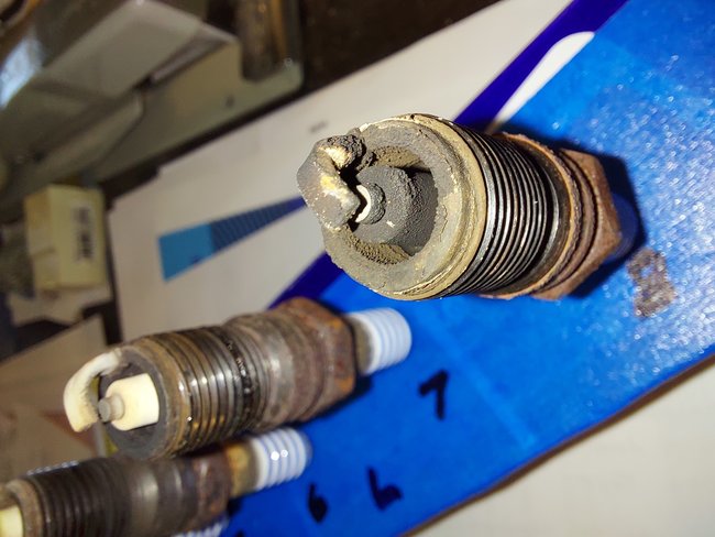

Also, the plugs I pulled, Motorcraft AGSF 32C, are not the correct plugs for this 5.8l motor. Per my owner's manual they are supposed to be ASF 32C. While they are both copper electrode plugs, the threaded ends look to be different lengths. At least what a photo of the correct plug shows. I ordered a platinum tip Motorcraft replacement SP-501 which is supposed to be an upgrade to the ASF 32C.
May 4, 2022 at 6:44 AM
  • 110,251 POSTS
In the picture, I see two plugs. The cleaner one looks normal. The corroded one has me a bit concerned. That appears to be either oil-fouled or coolant-fouled. Did you ever notice any blue smoke from the exhaust or if the coolant gets low?
Take a look through this link specifically at step 2. Read through it and let me know your thoughts.
https://www.2carpros.com/articles/how-to-check-for-ignition-spark
Keep in mind that cylinder 8 is one of the furthest back from the water pump. As a result, they tend to run hotter. This can cause wear to occur faster than in the forward cylinders.
Regardless, let me know your thoughts.

All the other plugs look the same as the one good one in the photo. The carbon fouled looking plug was not wet, although it hasn't been run in a while.
I have never seen any smoke from the exhaust or smelling gas or coolant.
I don't have a coil on the plug ignition system, as demonstrated in your linked video and test procedures. I can't swap any plugs now since I broke 2 getting them all out. I
had such a hard time getting them to turn. I thought they were seized. They have been there for about 15 years (30,000 miles). I had to use a 1/2" impact through the fender well on two, hence the breakage. I should have the new ones tomorrow. I'll also try and scope the cylinder.
