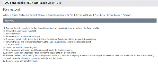

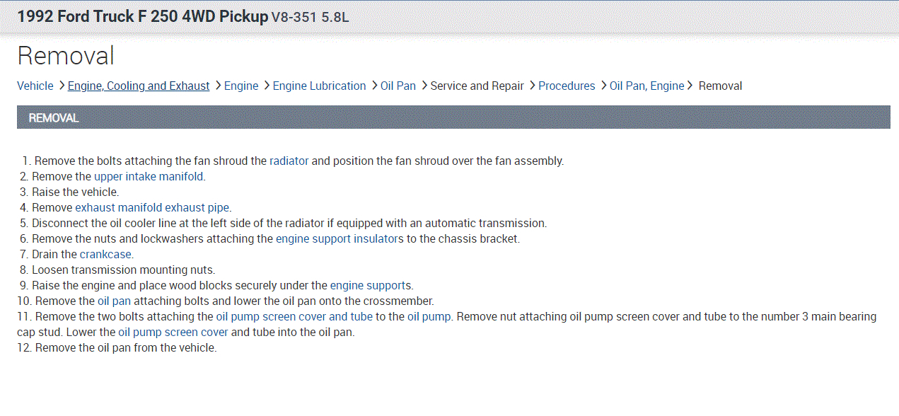

Did you loosen the trans mounting bolts? Is a cooler line hitting?
Do me a favor. Take a look through the pic below. Those are the directions from my manual. See if there is anything that was missed.

Thanks Joe. I did loosen the transmission mounting bolts. There are a few extra items on your list (trans cooler lines and upper intake manifold), but they don't seem to be the problem. What I could see is the bracket that holds a bunch of items that are part of the air injector emission system. It was bound under the wiper motor. I finally got that disconnected along with some of the hosing along the firewall. The intake plenum doesn't seem to be hitting the firewall, yet, but there is a protruding flange/boss which is part of the trans converter housing which is hitting the underside of the firewall on the driver side. I looked at removing the intake plenum, but I can't even find most of the mounting bolts. And there seems to be way more things to disconnect than the book states to get it out. By the way, another thing no one seems to mention the emission items and bracket I mentioned above and that the power steering pump return line, which I found out the hard and messy way had to be disconnected. I'll look again at the plenum. The engine is now shifted left and only has one lifting bracket (driver side). I'm thinking about putting a fabric sling under the whole thing and try and shift it over. Also, I don't know if you remember or received the replies, I tried to send you under the heading "Loss of Power", but upon removing the oil pump I saw that the pick-up screen was mostly clogged. I'm guessing that was the oil pressure problem.

That would certainly cause low pressure. As far as the issues with lifting the engine, if possible, take a few pics of what is hitting. It seems they make nothing simple anymore.

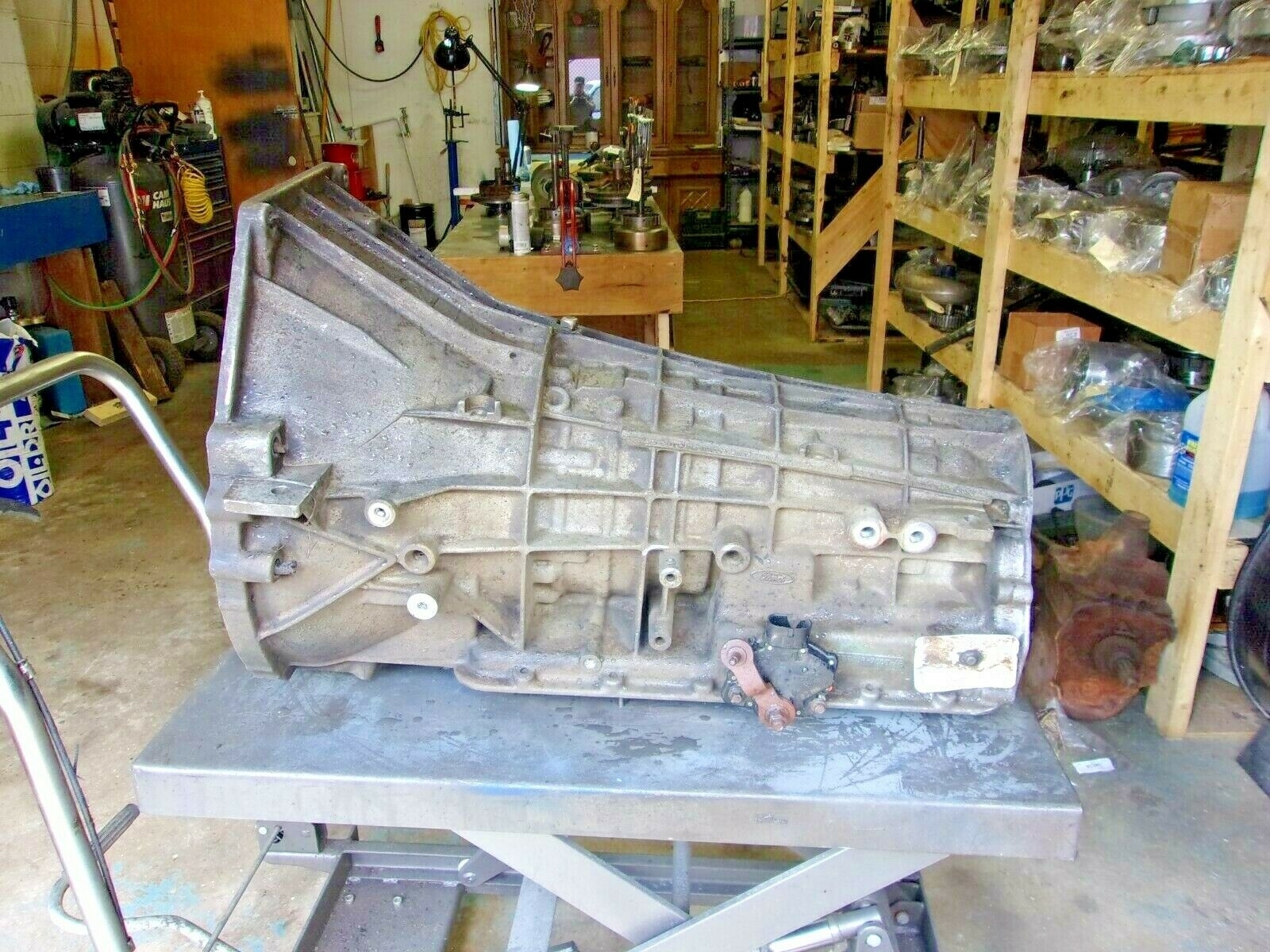

Tony, I believe those are for production. They are certainly in the way. At this point, if you are not going to be able to clear those tabs, I would unbolt the transmission and separate it from the engine block.
As far as the intake. The manual indicates it needs to be removed. When I deal with something like this, I try to see if there is enough clearance to make it work without removal. If there isn't, then I remove it.

All those emission pipes along the back are seemingly my problem. I got a few off and got the engine higher but it's still not enough. But it's so close. It looks like the plenum will have to come off in order to remove all that emission piping. I'll start on that and see what happens.
As for the tab on the transmission, I might just cut it off if it serves no purpose anymore.

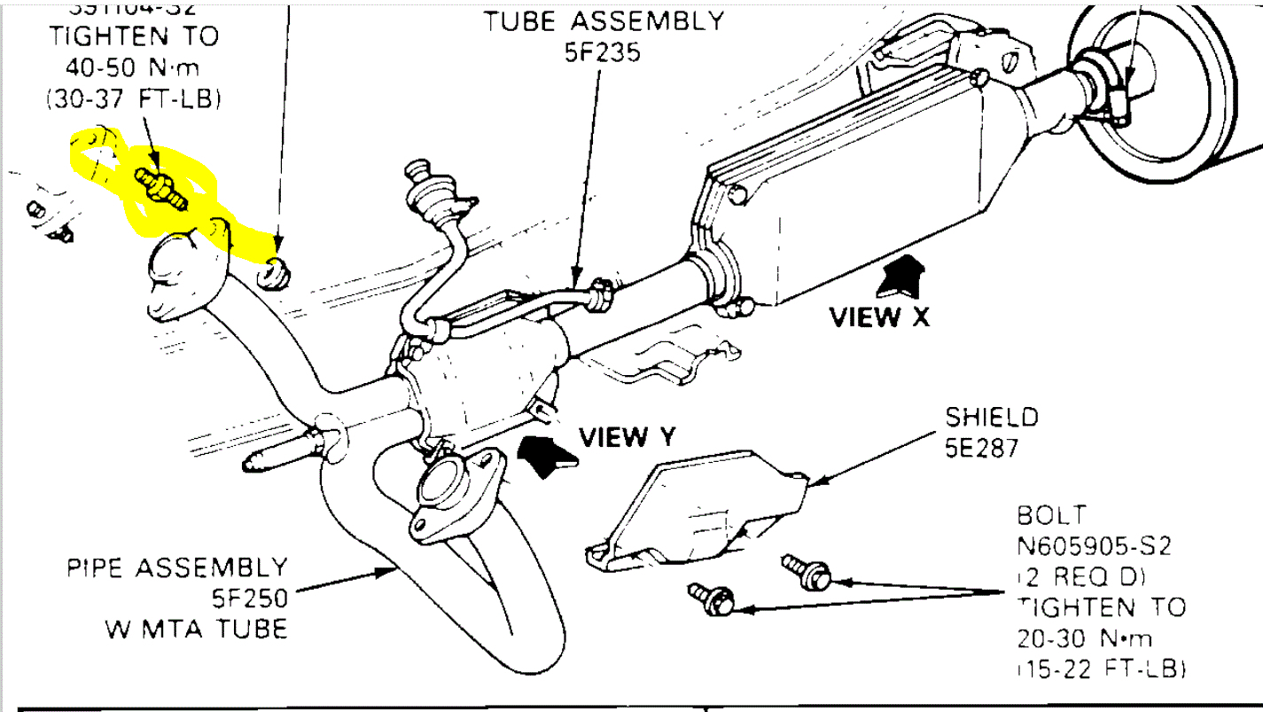

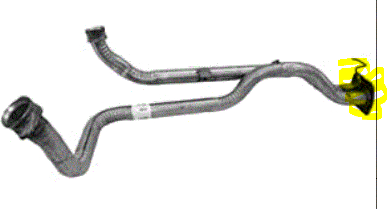

Thanks for the update. If you look at the pic below, is that where you had to cut the bolt? If so, to the best of my knowledge, that is threaded. Do you have enough left to get an extractor on?

That's one of them. I know that's threaded. The others are the four that connect the inlet flange of the cat. to the down pipe.

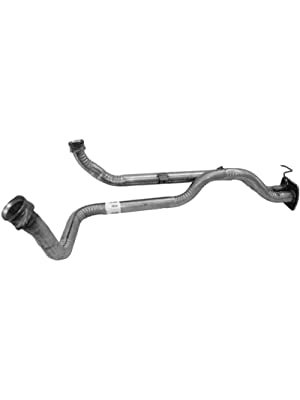

That looks like an aftermarket part. If the highlighted part below is where you are referring to, is it possible just to drill them out and use a nut and bolt to attach the converter?

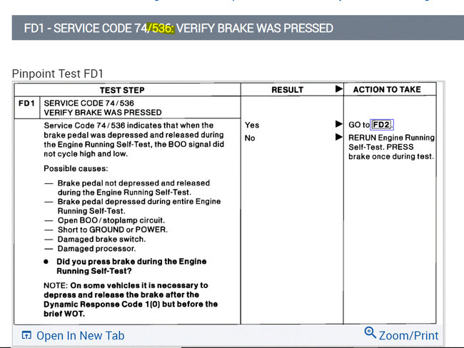

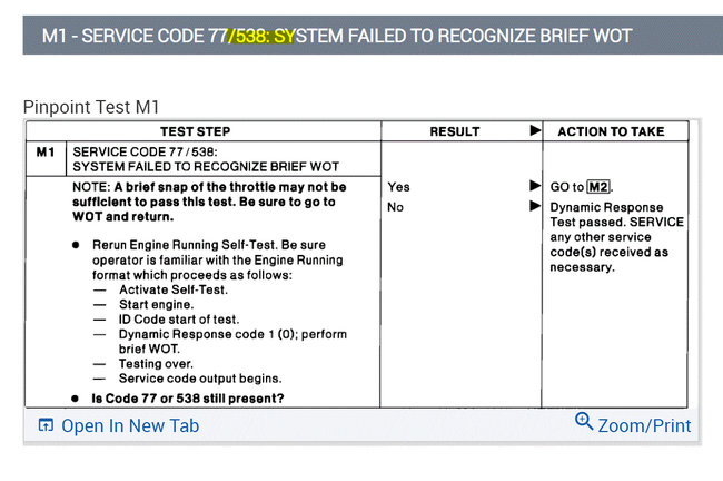

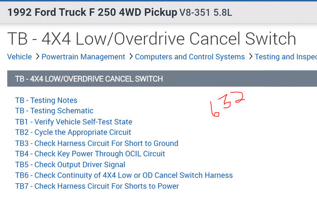

I ran through the codes (see below).
111 Systems good
114 ACT / Air Charge Temp sensor
536 Brake issue
538 Dynamic response test
632 OD cancel switch

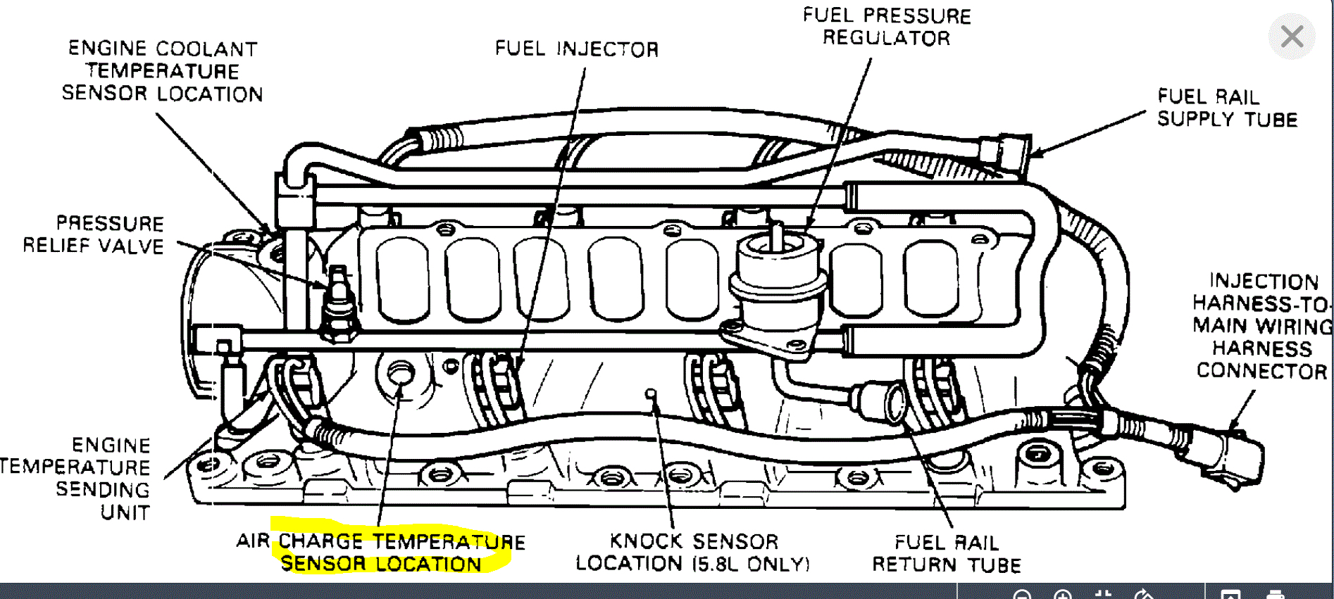

Of the codes provided, the only one I feel could be related to the running issue is the ACT code, 114. The sensor plays a role in the air/fuel mixture so that certainly can be causing this type of issue.
I attached a pic of its location below. Inspect it to make sure the wiring wasn't damaged, it's fully connected, and a good connection is being made.
Let me know what you find.
See pic below.

I checked the sensor, and it looks 'dirty', as if it was never touched even after I removed and reinstalled the upper intake. Since I don't know if this code existed before the work, I guess it's difficult to say if this was a problem before. Seems odd the truck ran fine before and was just sitting for an extended period.
I failed to mention that there never was a check engine light on the dash either before the work or now. Does the KOEO test (which passed) just check switches and relays, or does it check these sensors also?

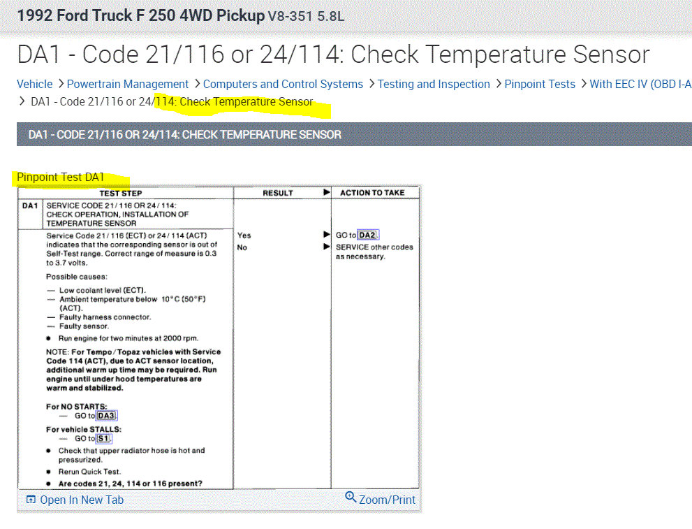

The part may have never had a chance to set the code or light. Since it sat for a long time, it is possible that it deteriorated enough to no not work.

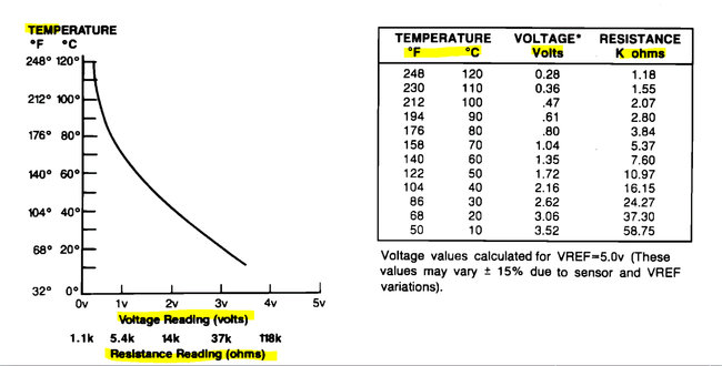

I attached a chart below showing the voltages/resistance that you should find based on temperatures. The sensor receives a 5v reference for power. On the opposite end, which is changed based on temperature.
Is this something you are comfortable checking? Also, at least this will help us eliminate it as a problem if it checks good.
As far as what you mentioned above, it isn't uncommon for the CEL not to turn on with the OBD1 systems. Until companies moved to the OBD2, things were still somewhat primitive.
Take a look below and let me know your thoughts. Hang in there. We'll get it figured out one way or another.

I had to wait a couple of days until the garage got above 20'. This was a bear to get to.
Ambient air temp is 37' F, Voltage at connector is 4.7 VDC and resistance of sensor is 97K Ohms.
Tony

The resistance seems a little high. If you press slightly on the throttle, does the engine then run smoothly?

The change in RPM is normal. I didn't realize that is how it was happening. The readings you provide are good.
I'm back to the 114 code. There has to be an issue with a temperature reading/sensor. Do me a favor. Take a look at the attached pic. Let me know if you are comfortable performing it. Also, if you do, let me know the results so I know which flow chart to go to next.

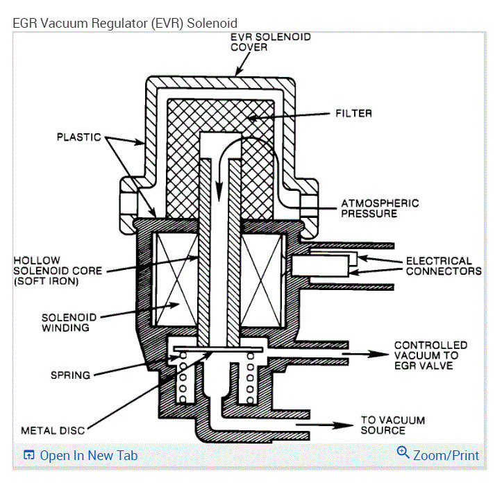

It sounds like there is a leak. I'm basing that on the vacuum readings you provided above. When you indicate the lower vacuum between the EGR vacuum and the source, are you checking it before the EGR vacuum regulator? See pic below.
Here is what I based that question on: "I checked vacuum at the EVR solenoid. I get 10" vacuum on the supply line from the intake. (I don't know why it is lower than manifold vacuum of 16.7" unless it's because of the other components tapped off the same vacuum source), and I checked vacuum at the EGR, engine idle, of about 1/2". I revved the engine some and there was no change in the reading."
If the supply hose only produces 10 inches of vacuum and the engine is producing 16.7", either the supply hose is plugged or it's leaking.
See pic below.
