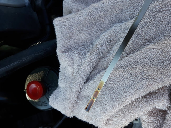

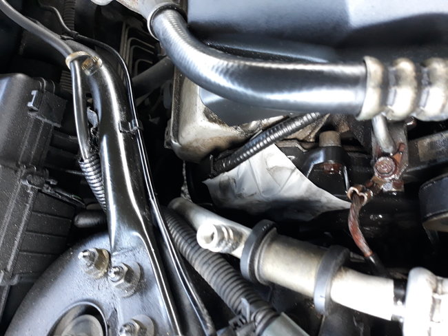

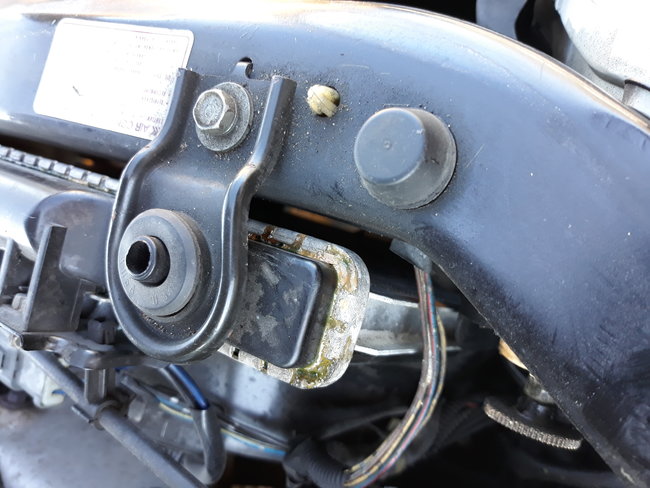

I noticed oil all over the passenger side bottom of engine. As i inspected to see where it could be coming from, i noticed a circle rubber seal popped off the side of the engine. It was ripped so i couldnt reattached it. I got some sealant auto tape to cover it but i looked online and in my owners manual to figure out what this seal is called with no luck. Then a metal attachment above the engine has a slow leak coming from it as well. Help

Hello and welcome to 2CarPros. With that many miles on the car, there are basically limitless possibilities as to what could be leaking. So let's start with getting some pictures uploaded. If you could get pictures of the seal in question, where it came from, the metal attachment that you see leaking, and (last but not least) stick your finger in the oily crud and take a picture of your finger. Then come back here and upload the pictures to this thread using the "Add image or video" button that's below the text input box. Then I'll be able to much better guide you through the diagnostic process.

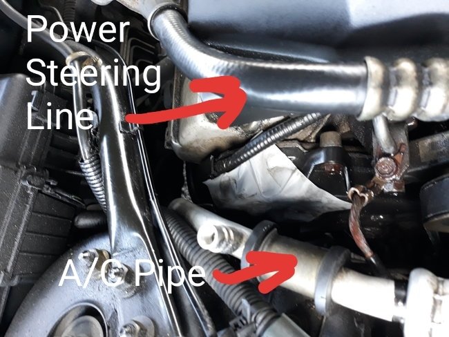

I have one photo for now. I can't do the finger thing until morning. The grey patch is where the quarter sized hole is. And the curved metal pipe/tube thing is rite in front. I had a rebuilt engine, new radiator and radiator fan put in last year around October. I honestly don't know how many miles is on the rebuilt engine. I didn't ask. I was just glad my car was fixed. And it wasn't something i even thought to ask when it was done.
Apr 10, 2019 at 7:19 AM
ADOSPOY
  • 9 POSTS
More about the picture, the black hose where it meets the goldish metal is where one of the leaks are besides where the grey patch is (quarter sized hole) and the seal that broke off was all filled in like a quarter, not like an o-ring.
Apr 10, 2019 at 7:21 AM
HARRY P
  • 2,292 POSTS
Okay. The black hose there is a power steering fluid line. It's under pressure when the car is running. It's not uncommon for them to start leaking where the rubber hose meets the metal fitting. The leak would only happen while the car was running. The leak would be really pronounced while turning the wheel all the way. So you might observe that hose while someone else turns the wheel all the way in one direction and holds it there.
The other line there is an A/C line. They can get pretty cool when you're running the air, resulting on condensation building up and then falling or running off. This can create the appearance of a leak, so you have to check around and see if it's just water that's leaked down and gotten all greasy and cruddy looking before it got to the ground .

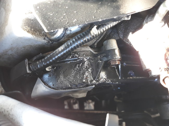

I think i am totally screwed now. I took my daughter to school and i saw smoke coming from underneath the hood. When i got a chance to look, i now have antifreeze all over the place.
Apr 10, 2019 at 10:56 PM
HARRY P
  • 2,292 POSTS
Not necessarily screwed. There's probably a coolant hose somewhere nearby that blew. It must've been leaking just a little. But since it's under pressure, a little leak became a big one. If the car didn't overheat, then that's going to be a small and relatively cheap fix. Poke around and find that leak.
All you have to do is borrow a cooling system pressure tester from the local parts store. When the car is cold, open the hood and refill the cooling system. Then connect the pressure tester, pump the pressure tester, and look for the leak. Take a few pictures and post them here. I'll give you through the process of fixing it yourself if possible.
Try that and we'll go from there. Good luck!

So i didn't get to the auto store yesterday because my son stayed home from school. I just got back from Advanced Auto and they told me that pressure test thing is $259.00 to rent. I don't have that at all. We only survive on my sons disability check so funds are limited. But since the car has been sitting since last Thursday I didn't experience any smoking from underneath the hood probably because i didn't run the car long enough to get hot, i am guessing. But still the other leaks and i took a picture of where there is dried antifreeze. My oil was still full and i had to add power steering fluid when i got to Advanced Auto and my coolant was still at the level it was when i parked it last Thursday. So i don't know what to do next.

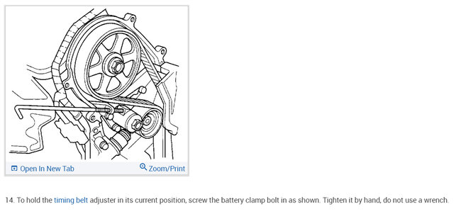

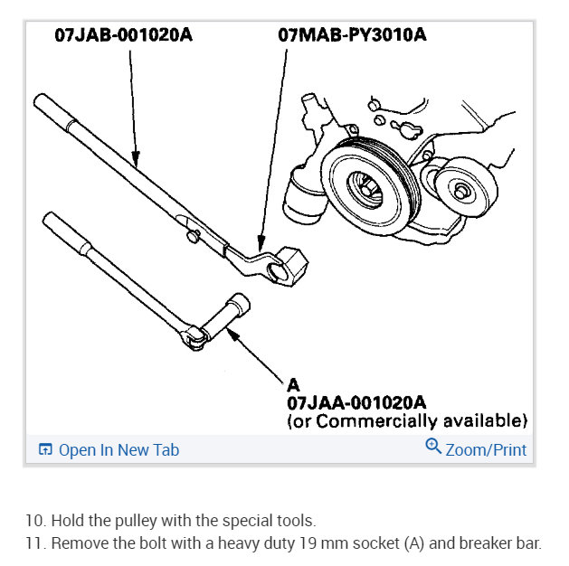

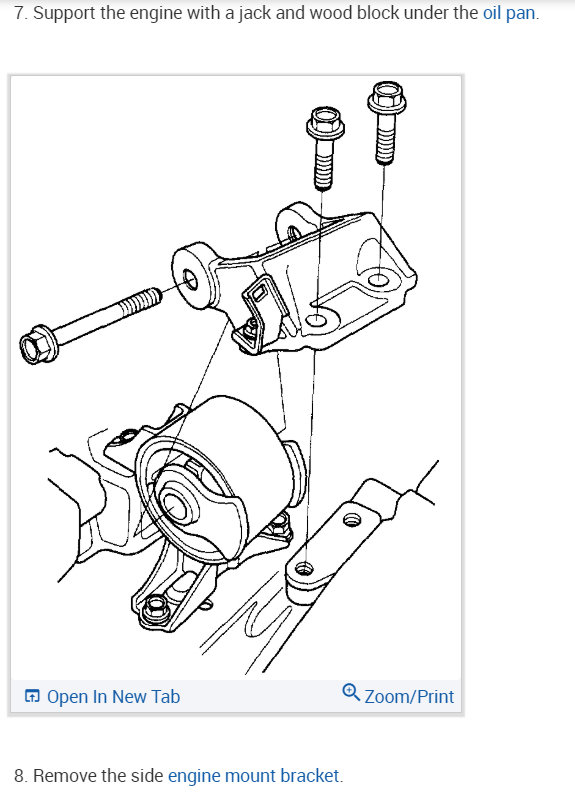

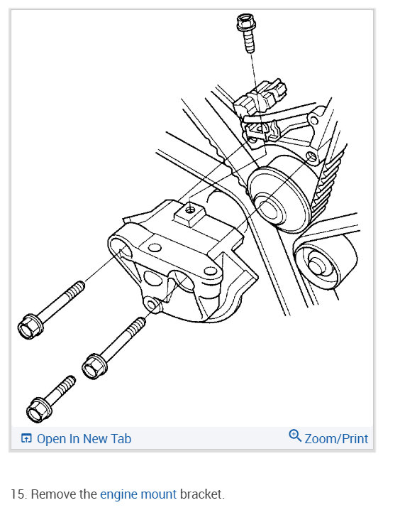

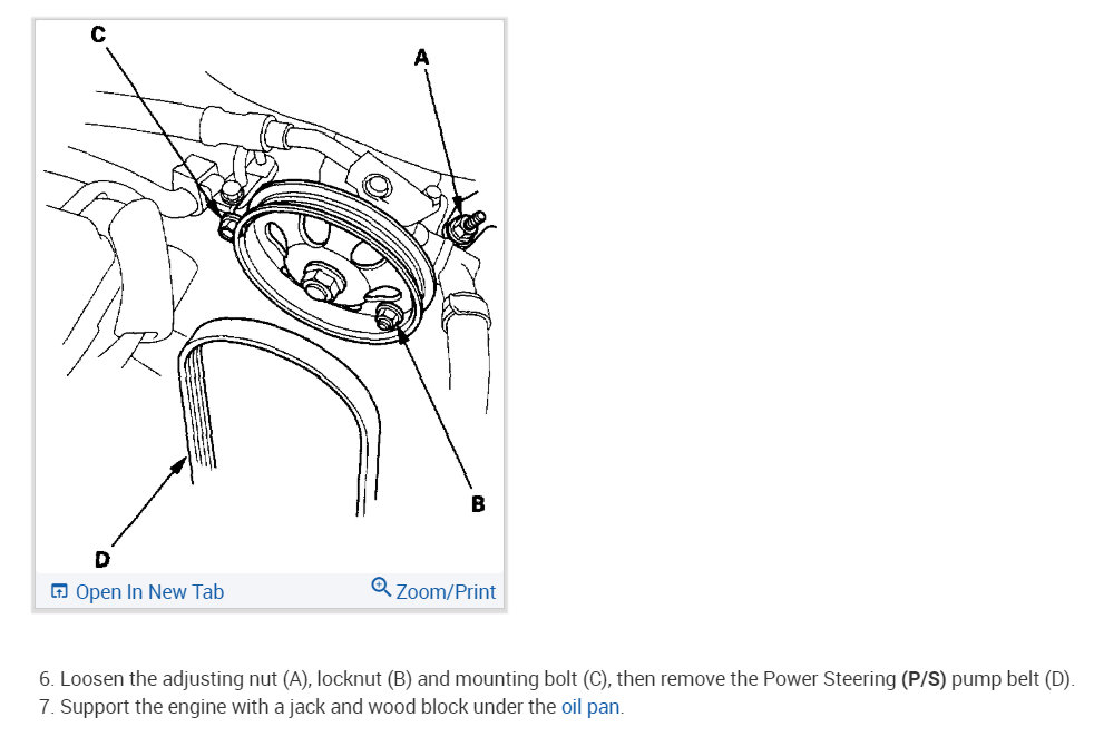

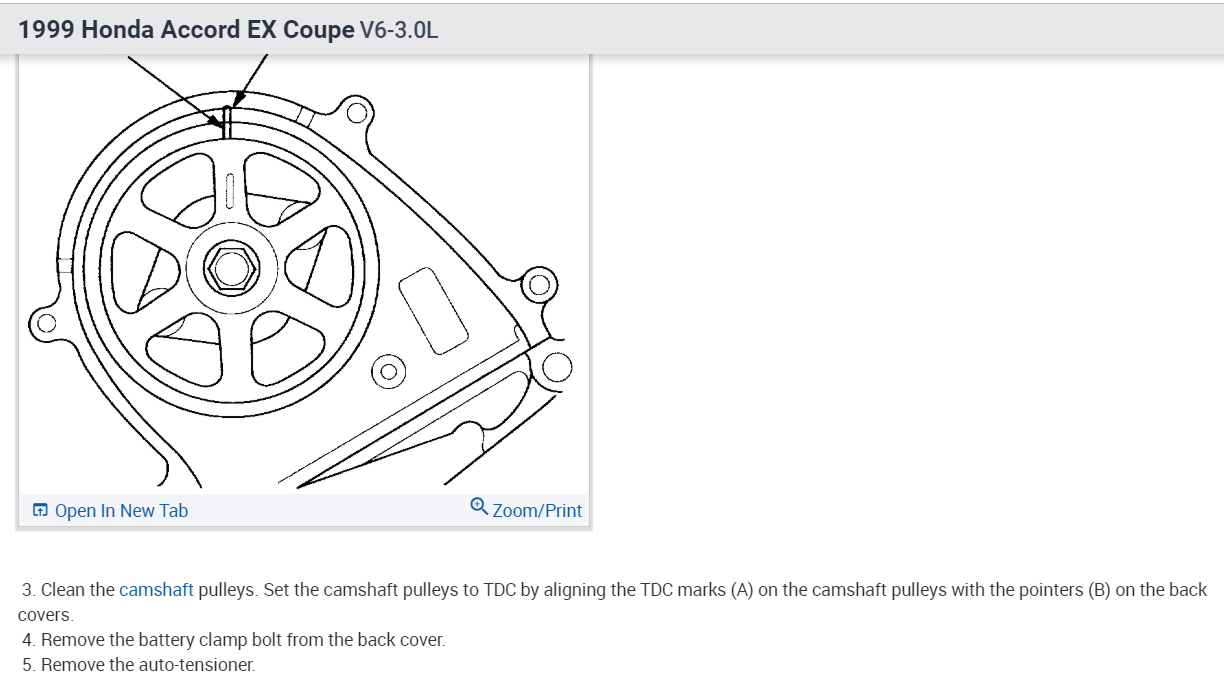

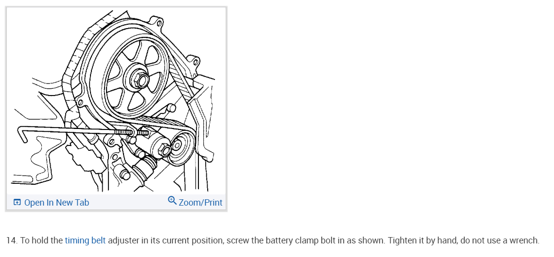

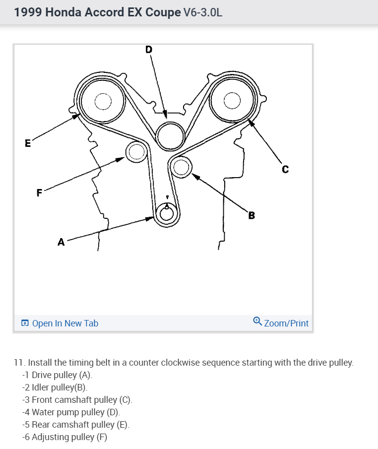

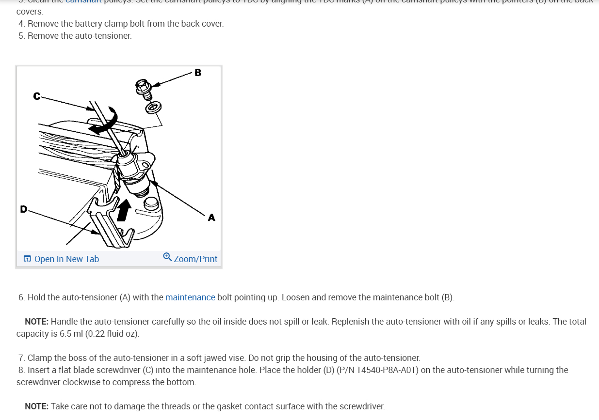

Apr 16, 2019 at 12:12 AM
  • 55,399 POSTS

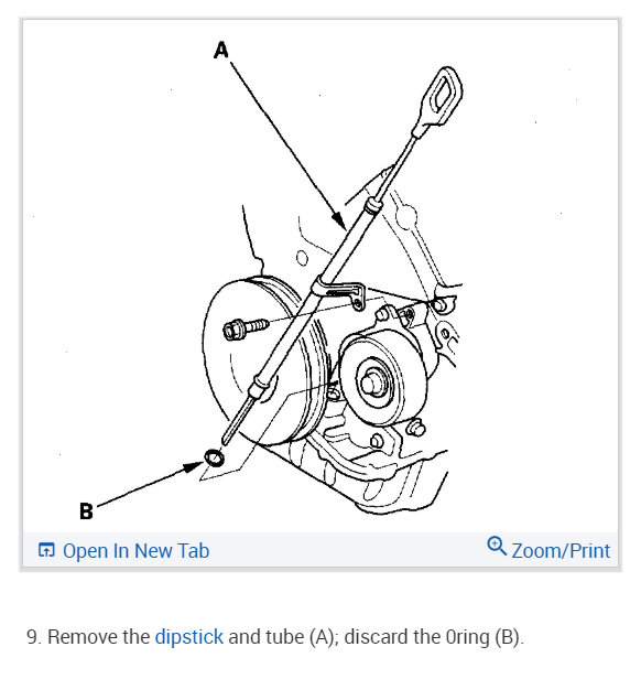

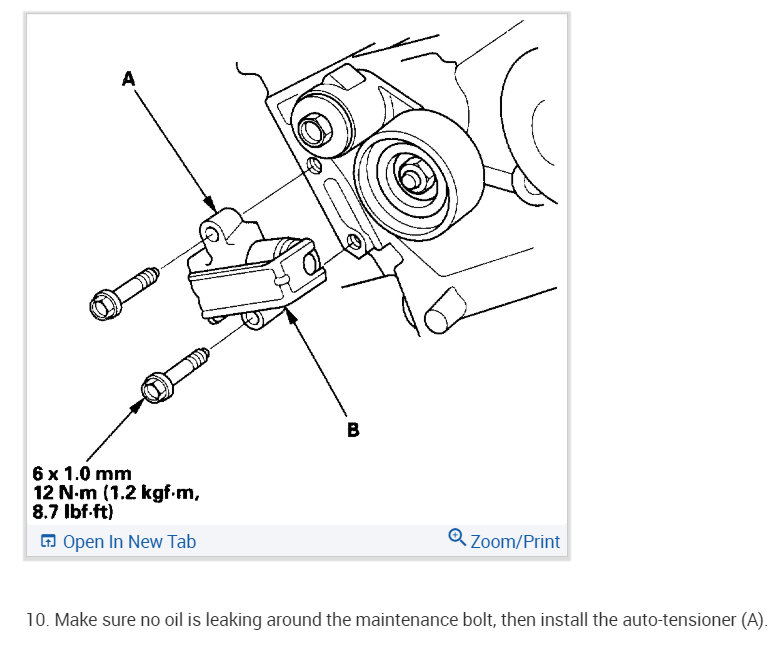

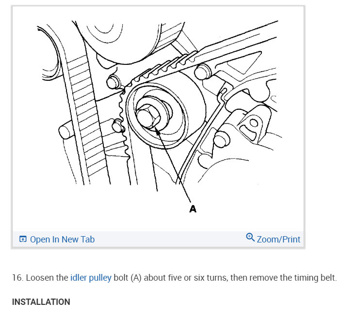

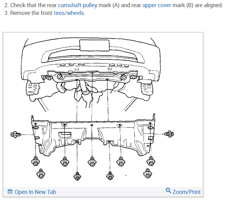

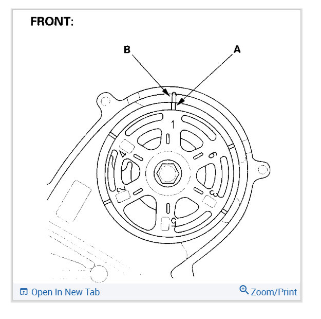

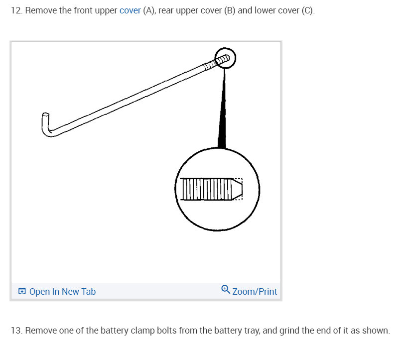

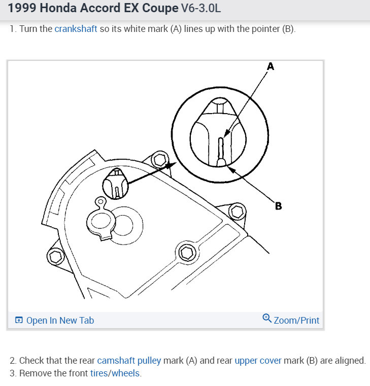

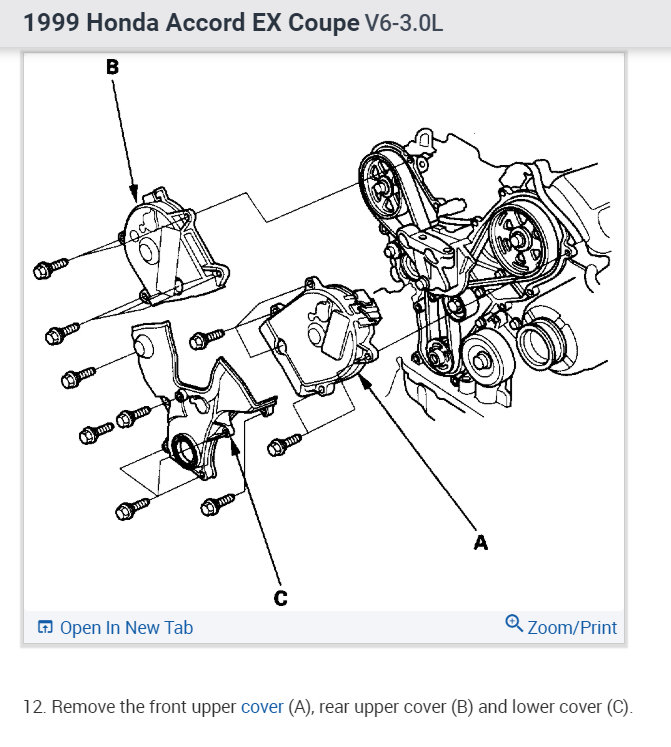

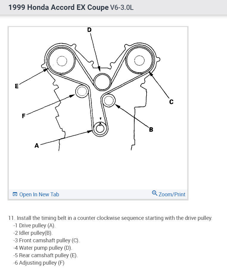

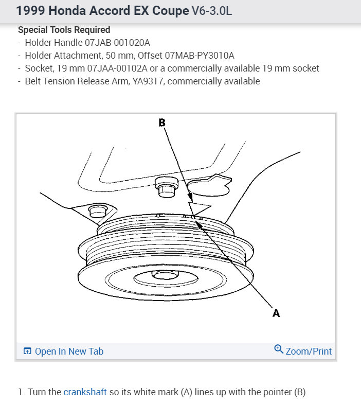

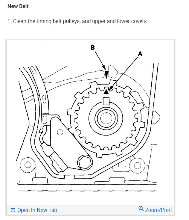

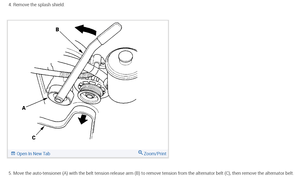

It looks like the radiator is leaking and you have a seal that is out in the front of the engine in the timing belt area. Also the oil is too full which can push the engine seals out and create the leak. Here is a guide to help walk you through the radiator replacement and diagrams below to help you take the front of the engine apart:
https://www.2carpros.com/articles/how-to-replace-a-car-radiator
I would do the timing belt and water pump while you are in there. Do all seals as well. Check out the diagrams (below). Please let us know what you find. We are interested to see what it is.

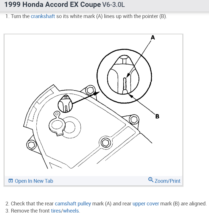

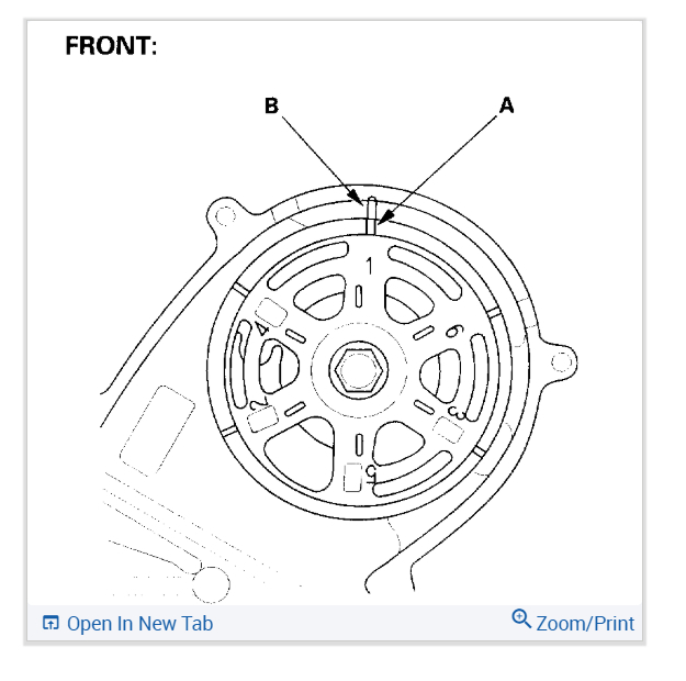

I have an oil leak from behind my distributor housing, my current manual (I only have one of the two) does not cover anything on the ingnition system. I'am tempted to pull it replace the O ring behind it, but where do I shine my timing light after this task?? I do not see the same old rubber cover cover like my older Accords had in the transmission housing. I can't find the timing port hole!! Does my car have one?? Any Help? Thanks in Advance!!
Tony
Aug 25, 2020 at 4:39 AM (Merged)
KHLOW2008
  • 41,814 POSTS
Hi tony,
The timing mark is found on the crank pulley.
One trick that you can use is to mark the mating points of the distributor and head with a scriber and when reinstalling, it goes back to the same position.

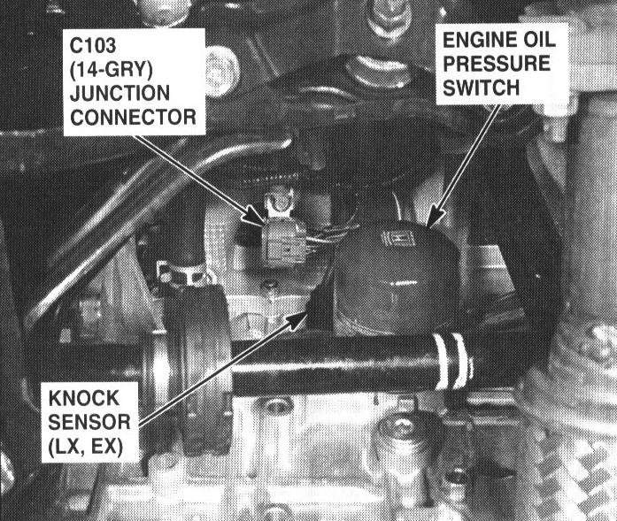

LX model. Engine oil is dripping from engine near oil pan. Problem developed rapidly. Entire rear surface of engine is covered with oil. Leaking two to three quarts a day. Replaced valve cover gasket and distributor o'ring that were leaking. They are not leaking anymore. Leaking occurs (from somewhere) when engine is running. Where is the oil pressure sensor located? Are there any other external oil lines or sensors? What other areas could be the source of such a severe leak?
Aug 25, 2020 at 4:40 AM (Merged)
  • 110,241 POSTS
The oil pressure switch is near the oil filter behind the engine. I attached a picture of its location. Check that first. Also, make sure the oil filter isn't leaking. It is easy to double gasket the filter and it will cause a leak. Last, check to make sure oil isn't coming from the oil pan or crankshaft main seals.
Let me know what you find.
JIMB4606
The area shown in your picture looks like where the oil is dripping. This problem came on suddenly about three weeks ago. Last oil change was three months ago. So the two events may not be related, but will check. To me, it sounds more like an oil line, hose, sensor or fitting came loose or cracked, I'll check oil filter, drain plug and sensor tomorrow. Can main seals go bad suddenly (and leak two or three quarts a day) or are they more likely to wear out gradually?
  • 110,241 POSTS
Welcome back:
The main seals usually slowly get worse. However, the pressure switch is another story. It is plastic and steel crimped together. Often times the crimp will come loose and oil will leak.
Let me know what you find. There are no oil lines or hoses related to the engine oil on this car. However, that doesn't mean someone hasn't installed an aftermarket oil cooler or something similar.
I have a feeling it's the oil pressure switch. Let me know. I'm interested in knowing if that is correct.

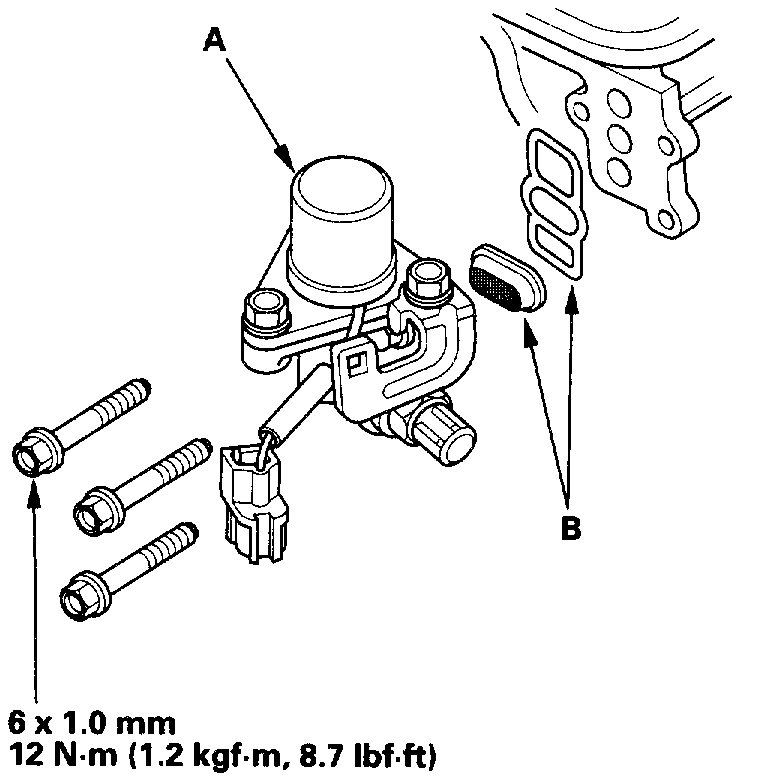

This morning my son and a mechanic friend discovered oil rapidly dripping from the vtec (VVT) valve or solenoid at the gasket(s). We'll replace both gaskets tonight. The engine is running great, so we are assuming the vtec valve is operating correctly and does not need to be replaced now. However, I read that there are screens inside the vtec valve that may get blocked. We will look for that and clean with brake cleaner if needed. Do you have any concerns about this plan?

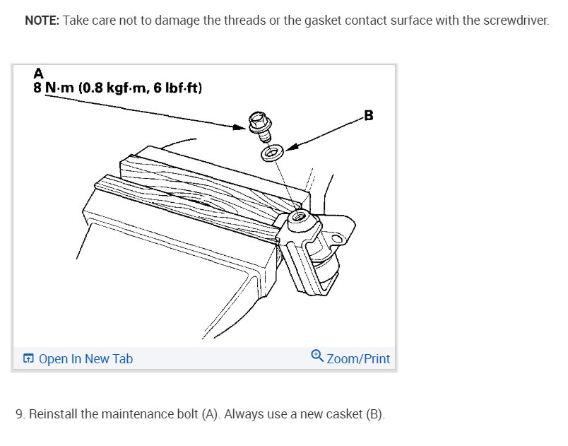

  • 110,241 POSTS
Welcome back:
I attached a picture of what I feel you are referring to. Please confirm it is correct. As far as a filter, letter B in the picture shows its location. Be very careful cleaning it. Brake cleaner may be a bit aggressive, so be careful.
If the screen isn't plugged, leave it alone. On the other hand, if it is, after cleaning, change the engine oil and filter.
