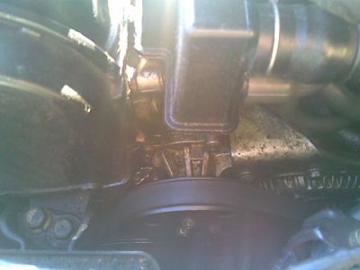

1991 Honda Accord. We have a MASSIVE oil leak at the front end of the crankshaft that started a couple of days ago. About 4 seconds after starting the engine a stream of oil an 1/8 inch thick comes out of what looks to be a small vent just above the oil pan under the front of the crank at a rate of about a 1/3 cup a minute. Is this a totally failed crank front oil seal or something else?

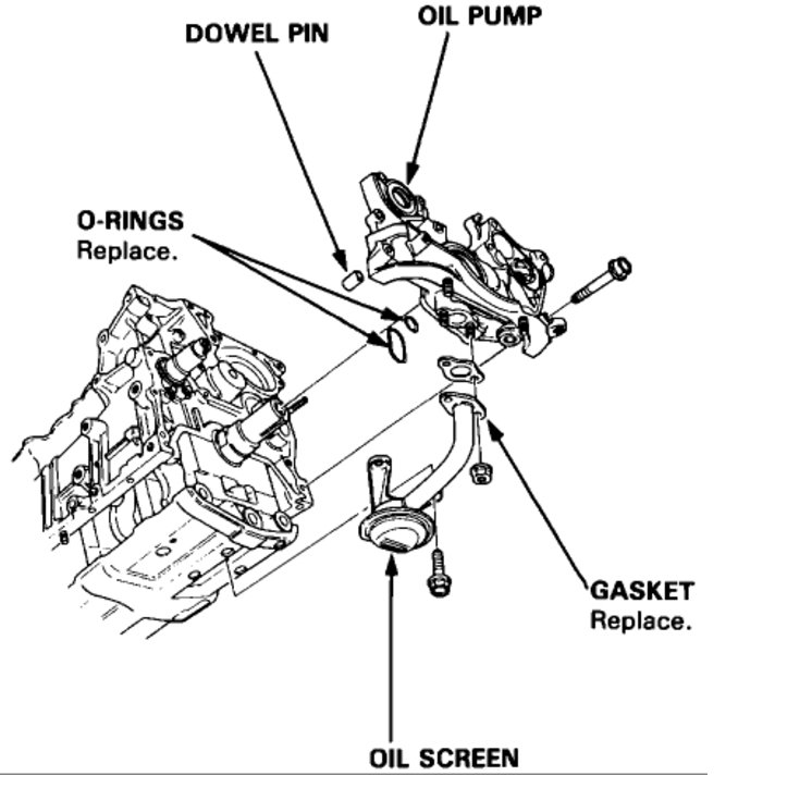

Could be the front crankshaft seal or an oil pump housing seal/gasket-inspect This guide will help us find it

It is hard to believe that even a totally missing crank oil seal would leak that much oil. It's not drip drip drip but a steady stream of oil coming out of the vent at the bottom of lower timing belt cover at idle. Where is the oil pump on this engine and would a leaking oil pump housing gasket leak into the space between the engine block and the timing belt cover?
Dec 12, 2009 at 10:15 PM
  • 75,992 POSTS
The oil pump is in front of the engine block and its behind the front cover of the engine where the crankshaft meets the crankshaft pulley thru the cover.
Dec 12, 2009 at 10:46 PM
JERBES

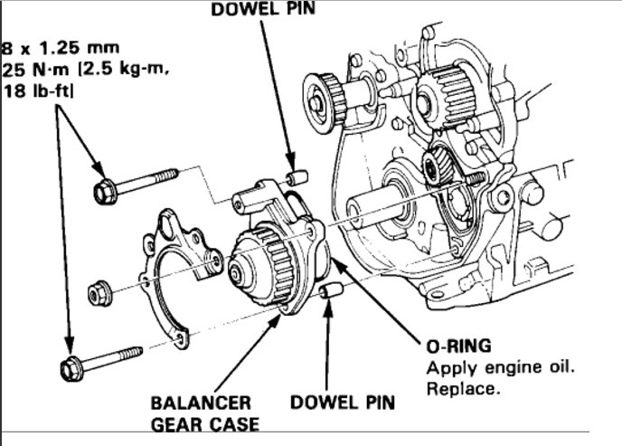

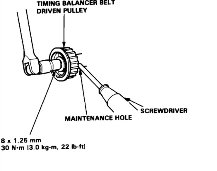

Well, we got around to fixing it now that the weather is tolerable. It wasn't the front crankshaft seal and it wasn't the oil pump housing seal gasket either, so both your guesses were wrong.
It was the seal on front counterbalance shaft that caused the massive leaking. The seal had popped out from the oil pressure behind it and was riding on the shaft. There was no seal retaining fork installed, which I now understand was a recall on later model Accords. We replaced the front counterbalance shaft seal along with a seal retainer fork, the crankshaft seal, the timing belt, the countershaft belt and put in a new water pump just in case.

At the front of the engine, there are :
1. Camshaft oil seal.
2. Crankshaft oil seal
3. Front balancer oil seal.
4. Rear balancer oil seal and O ring.
5. Valve cover gasket.
Any of the above can cause the leaking and the most likely condition is that one of the seals has popped itself from its seat.
You would need to remove the timing belt cover to check the source and the job would depend on what needs to be replaced. With so much oil being dispensed, I believe the timng belt and related parts needs to be replaced as well.

These vehicles had a tendancy to pop their balancer shaft seals.This is under the timing belt cover.

There is an oil pump o ring seal that sits in the front of the engine just behind the timing belt. We see them leak from there all the time.
Here is a guide and some diagrams to help you get the problem fixed.
https://www.2carpros.com/articles/engine-is-leaking-oil

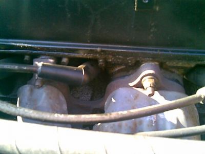

her is to picks i took (((number one is the driver side of the car)))) (((number two is the valve cover))))
https://images.2carpros.com/forum/automotive_pictures/64040_pick_of_oil_leak_2.jpg
https://images.2carpros.com/forum/automotive_pictures/64040_valve_cover_2.jpg
Aug 25, 2020 at 11:58 AM (Merged)
BRUCE HUNT
  • 3,754 POSTS
Get a valve cover gasket and pull that head off. Check the valve train assembly for any loose items and any foreign materials floating around.
