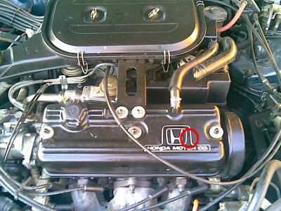

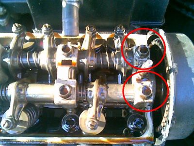

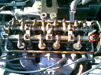

UPDATE: i check the belt area like you said all was fine on the other hand i took the vlave cover off and found the two bolts not wanting to tighten snapped some pics for you and used the screw driver to find where the sound was coming from on the valve cover
pic 1 was before touching it the bolt was just sitting there
pic 2 is just the same but closer as i tryed to tighen them just turning for about ten min
pic 3 is where the sound is coming from
and please tell me this is not real bad news also the i pulled the bolts there was no breakand the thread was fine im guessing that down below is the problem

If the bolts are loose and the similar ones on the valves are not I know you have found the problem. The problem is more serious that just using loctite. I would remove the bolts, see if the bolts are stripped or if the threads in the hole are stripped. Then you either replace the bolt or tap the hole a size bigger and tighten down. Be careful as the last great mechanic over tightened them before.
