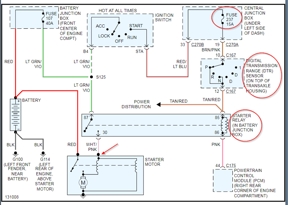

Good afternoon,
Do you have a volt meter or test light to do some tests at the starter relay?
I attached a diagram for you to view.
Friday, March 27th, 2020 AT 11:45 AM

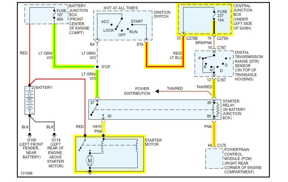

So I assume you have no power on the control wire but do have power on the 12 volt from the battery? If so then check the fuse, relay, and the range sensor to see if we have power coming from it.
Basically the PCM is in control of the starter so we need to find out where we are loosing voltage so we can see what the issue may be.
Basically we need to just test voltage at each of these locations when you are turning the stater to see where we have voltage. So follow it through from top to bottom on the wiring diagram to see where the voltage stops.
Let me know if you have questions and we can figure out how to answer them. Thanks

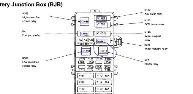

Have power to neutral safety switch power, to starter. Relay clicks under hood but no power on wire going to solenoid.
Saturday, March 28th, 2020 AT 9:38 AM
  • 52,797 POSTS
Check for power to pin 87 on the relay with the key in the on position.
Saturday, March 28th, 2020 AT 12:06 PM

You need power to 85 with the key on. That comes from the park. Neutral switch.
Saturday, March 28th, 2020 AT 12:41 PM

  • 52,797 POSTS
Okay, you said there was power through the park/neutral switch which means if there is no power to the pin 85 then you have a broken wire between the park/neutral switch and the relay.
