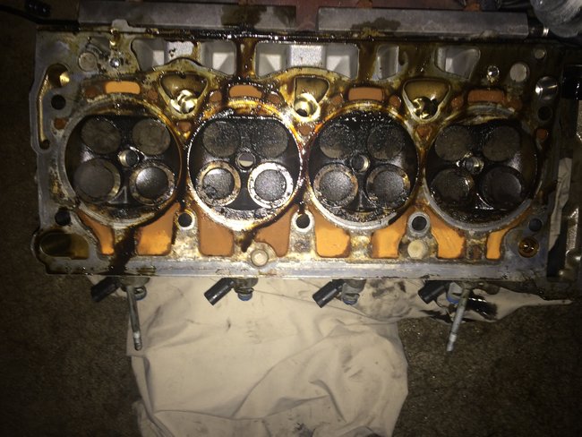

The way I would proceed if it was my engine: First I would remove both cams from the head after marking all the parts and taking a few pictures. Then I would do a leak down test of each cylinder to verify that it does have some bent valves. (it would be incredible luck for there to be no damage, about like walking out the door and finding a stack of gold with a sign with your name on it)
The leak down test shows that there is leakage past valves in two cylinders. Next step would be to drain the coolant and pull the head off. Then look for the telltale marks of the valves hitting the pistons. I have seen them just scuff the surface and I have seen them go right through the piston tops and everything in between. IF it's just minor scuffs and it didn't hurt the lower end I would then have the head rebuilt. If it is more severe I would either replace the engine with a used one or get a remanufactured engine.
It all depends on what the damage is and how bad. But it would start with the leakdown test. With the cams out it would be easier. Just connect a good air supply of about 50 psi. to the spark plug hole, gently apply air and let the piston go to the bottom of the bore and listen at the intake and exhaust for air. Then turn off the air and rotate the crank to bring that piston to the top and lock it there and test again.

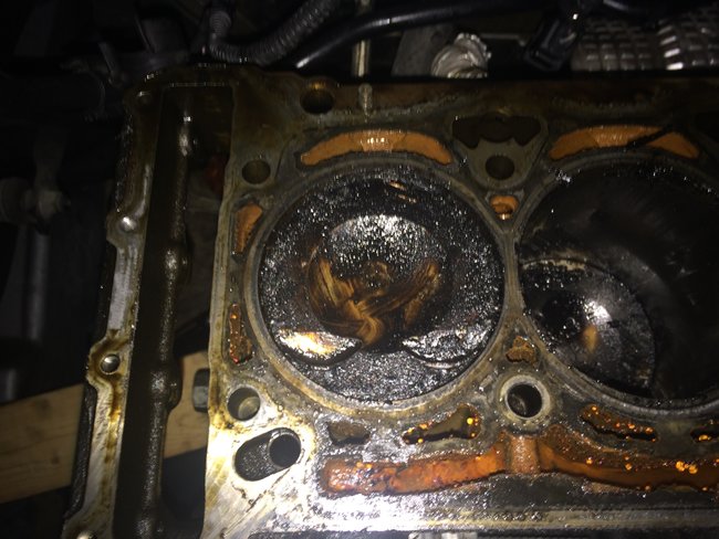

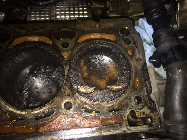

Feb 13, 2017 at 1:24 PM
Clean the piston tops with some carb/choke cleaner and a plastic scraper.
Then where the valves tagged the pistons on the lip of the relief use a small file or similar to remove any sharp edges from that mark. That will help eliminate a possible stress riser and hot point. Inspect the pistons for cracks once you clean those areas, From the pictures it looks like you should be OK, but clean them up and look close just to be sure.
While you have it open you could run some flexible brushes through the coolant passages and oil passages to clean it up some.
Feb 21, 2017 at 12:46 PM
I was just more worried about the indent it's pretty deep but not through or that deep you run our finger over definitely feel it
