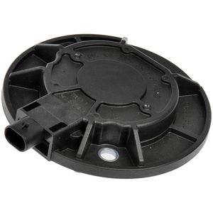

In this case check the camshaft adjustment valve. (Adjuster for the cam timing) Be sure it has power first, battery voltage key on. Then unplug it and check the resistance across the terminals (5-9 ohms) if not in spec replace valve. If you have proper voltage at valve, proper resistance across terminals and good ground. Test the signal wire from the ECM to the control valve, 1 ohm or less resistance in that wire. If that all checks out the ECM has a fault.

The camshaft timing valve is a solenoid that controls the cam timing. If it goes out of whack the cam timing will be way off. The engine doesn't run because the cam and crank are way out of time. Some will run if they are bad others won't.
Run the tests on it and see if it's bad.
Tuesday, January 17th, 2017 AT 6:39 PM
RVAHRENHOLD
  • 47 POSTS
The problem is I have the timing cover off the top part now and I think I am tdc and the lines are not equal on both cams. The lines for the back of the sprocket line up though. Do u have insight on what I need to do to verify timing is spot on?
I also do not see the valve onlything I see remotely like that is the magnetic plate on the outside of the cover and that controls the oil.
Tuesday, January 17th, 2017 AT 6:42 PM
STEVE W.
  • 13,576 POSTS
The solenoid that controls the oil is the part that changes the cam timing and the phasing with the crank. If it is bad it will throw the cam timing off, which is why the marks don't seem to be correct. It is the part that you test to be sure it is actually changing the cam timing. The ECM looks at the cam position relative to the crank. If the cam is supposed to be fully advanced at a certain point relative to the crankshaft but that valve isn't working, you get the P0016 code.

Can I jump it to see if the valve pin pushes in or out if I turn it the pin goes in and out. And the part on the cam I can press in and out freely so that's not stuck
Wednesday, January 18th, 2017 AT 4:47 AM
STEVE W.
  • 13,576 POSTS
To test ohms - Set meter to ohms. Touch the probes to the contacts on the valve. Read what the meter says in ohms. 5-9 ohms is good. Lower or higher is bad.

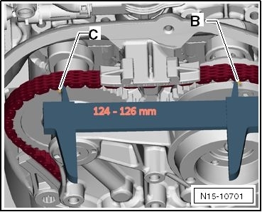

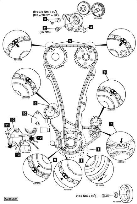

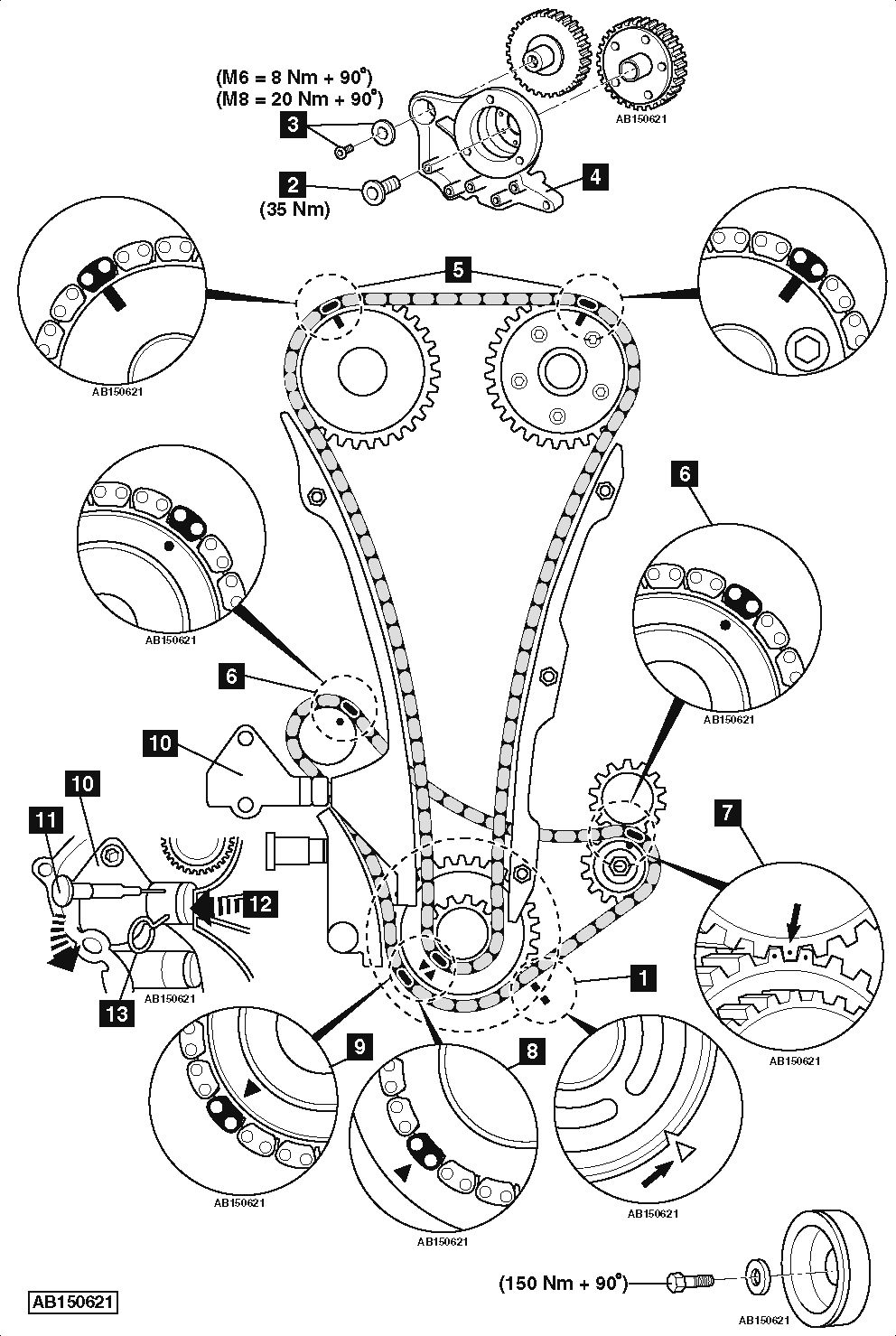

Timing marks are not line up marks. They line up with colored links on the chain. Like the attached image. Find the colored links and line them up with the marks on the cams and crank.

The colored chain marks do not line up with the cam marks not even close like at all but was told by a vw tech that its only like that once installed and then they move once the engine is ran. And I conducted the test many times and the ohms start higher drop to really low and sometimes climb up really high. So thats why I asked if I was doing sometihng wrong

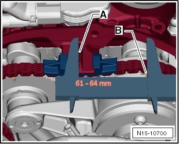

The marks will line up but it may take a few turns of the crank to bring them back in line. There is a way to check by measuring the marks.
Rotate the crank in running direction until the mark on the dampener lines up with the mark on the lower timing chain cover. Then measure the dimensions in the drawings. Each tooth "off" from correct = 6mm difference.
