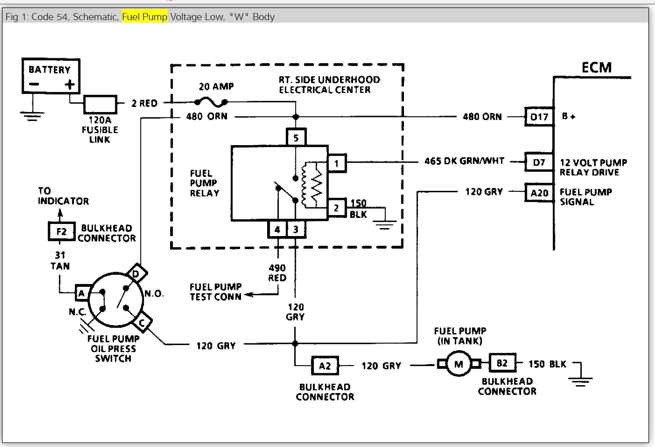

Thanks ...can you tell me where the fuel pump relay is located on a 92 chevy corsica 3.1 v6 engine? the fuel pump sounds very strong .. that is why i am asking about the relay .. i live in a town that has one garage so i have not had it checked yet

Sounds very strong? That does not mean a thing. This fuel pump is wired to run without a relay so that won't be your problem.

Thank you .. a faulty fuel pump will not let my car crank over? is that right? also i was told that it cannot be the fuel pump relay because my car is made to run without one .. is this true?

No here is the wiring diagram for the relay.
Please check it out to see if that is the problem.

It is absolutely true that this engine will run without a fuel pump relay. It has a redundant power supply through the oil pressure switch which will power the fuel pump in the absense of the relay when the engine has oil pressure.

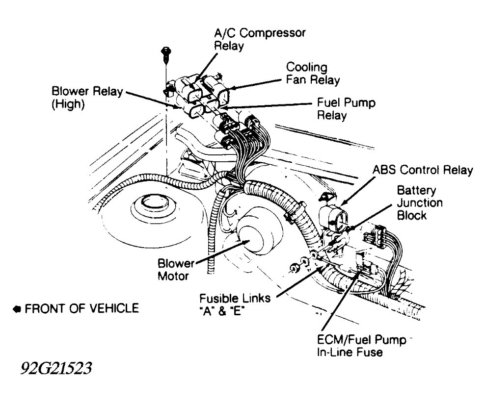

where is the fuel pump relay located on 92 chevy corsica 3.2 v6? thank you

3.1.. sorry

  • 55,746 POSTS
Hey Chyanne,
Here is the fuel pump relay location.
