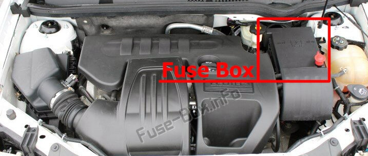

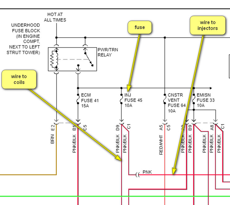

As you have no power to ignition coils, pin D pink/black wire, I would suggest first checking INJ fuse45(10A) in the under-hood fuse block, next to left strut tower.
See image below.
This fuse supplies 12V to all 4 ignition coils and to all four fuel injectors on pin 1, pink wire.

Have you checked if the injectors are getting 12V on pin 1, pink wire?
If they are then this could point to a possible wiring issue between the fuse block and the ignition coils.
See image below of engine fuse block showing fuse INJ45.

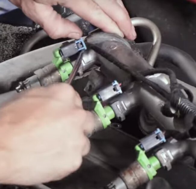

There is a light blue/grey clip-on top of the injector connector which needs to be levered up.
Then you will be able to remove the connector from the injector.
See image below.

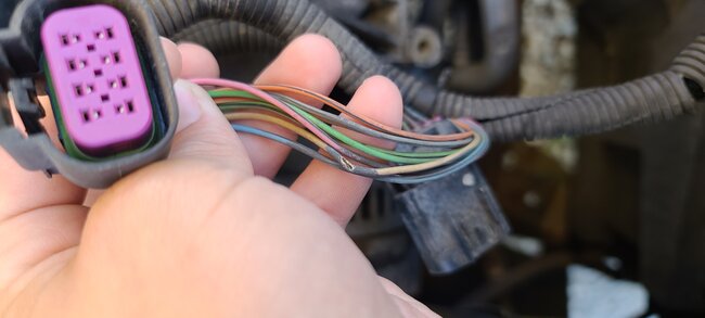

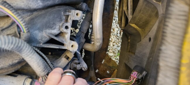

Apologies, I couldn't do much work, my area was hit with storms. I found a melted wire resting on a coolant line. I don't believe its a power wire, but I will send pictures and make the repair ASAP. I still need to check voltage at the fuel injectors, I'm still having trouble removing the connectors.

Please send us that picture of the melted wire.

This is the burnt wire and the line it was resting on. I'm currently working on it.

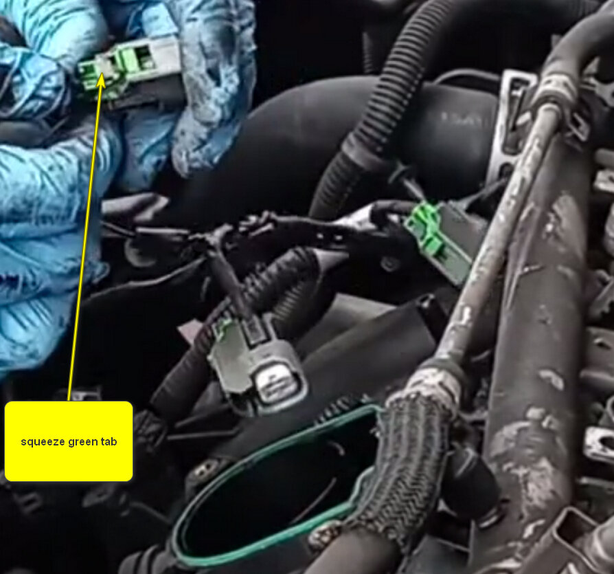

Mine is a green clip and looks different. I'll upload a picture this evening. I can't find any videos or pictures that have clips like mine.

I found information for the green clip injector connector.
You will need push down on the connector, squeeze the green tab, and pull connector off injector.
See image below.
A video, it shows removal just after halfway through:
https://youtu.be/CBBCVUcqRfI
