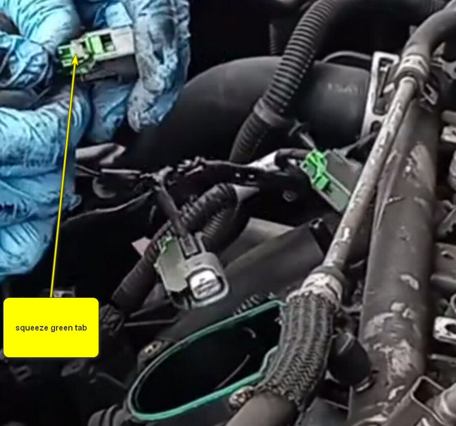

Mine is a green clip and looks different. I'll upload a picture this evening. I can't find any videos or pictures that have clips like mine.
Friday, April 21st, 2023 AT 8:14 AM
BORIS K
  • 799 POSTS
I found information for the green clip injector connector.
You will need push down on the connector, squeeze the green tab, and pull connector off injector.
See image below.
A video, it shows removal just after halfway through:
https://youtu.be/CBBCVUcqRfI
Cheers, Boris
