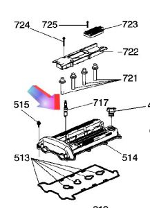

Can anyone tell me where to find the spark plugs on the 2.2L engine? Or where online I can find this info online (for free)? My local auto parts store doesn't carry the Haynes or Chiltons manual yet. Thanks for the help.
Mar 16, 2008 at 7:55 PM
SERVICE WRITER
  • 9,123 POSTS
https://images.2carpros.com/forum/automotive_pictures/30961_yasp_1.jpg
The link in my signature will take to a manual that this came from....not free, but reasonable. There is another picture attached below that shows the spark plug location

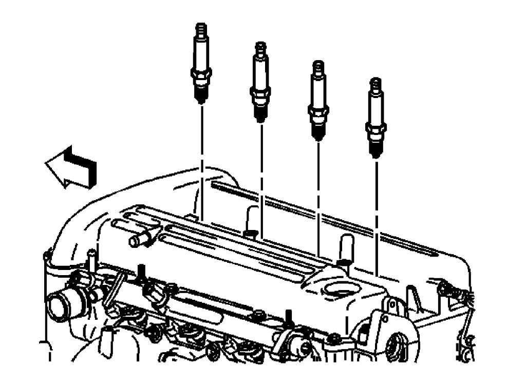

where do i find the spark plugs
Oct 26, 2018 at 6:51 PM (Merged)
BRIAN 1
  • 1,030 POSTS
https://images.2carpros.com/forum/automotive_pictures/147643_plugs_1.jpg

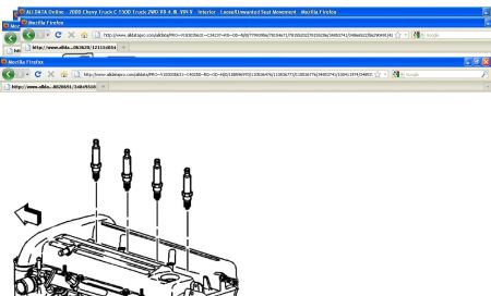

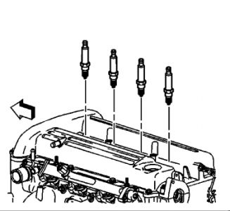

BLL10
Need to locate the spark plugs of a 2005 chevy cobalt...4cyl....automatic??
SATURNTECH9
  • 30,869 POSTS
https://images.2carpros.com/forum/automotive_pictures/416332_2005_chevy_cobolt_spark_plugs_1.jpg
There under the coil cassette there is four 10mm bolt's holding that down.
