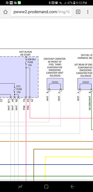

Hey guys, I was driving from the store and on my way home it just quit running with no warning. No noises sputtering at all. Nothing. I had it towed home and started checking the fuses on it. They are all good. As well as the relays I had switched out with one and another. Still nothing. I have replaced the crankshaft position sensor, ignition module, plugs, boots, and the over engine coil over. Still nothing. I had even taken the parts back to the store and switched them out just to make sure and replaced them and still nothing. I had checked compression and all great. Timing chain is still tight. I checked for lose wiring or broken wiring or bad grounds. I have power to the coils and also a crank signal also coming after the ignition module. When the car shut off and I got it home I pulled three trouble codes and they were injector two, three and four circuit malfunction. I hooked noid lights to all four injector wires and no current. When I test the crankshaft wiring with my test light I can hear the fuel pump kick on and get great fuel pressure. When I put the key into the ignition it is very hard sometimes to turn. Any advice would be appreciated. Thank you guys.

There is absolutely no power to the injectors with the key on the on position.

Open the underhood fuse box take a hand ratchet and see if the 7mm bolts inside the fuse box are tight?
Aug 10, 2017 at 1:27 PM
SATURNTECH9
  • 30,868 POSTS
Also check the 15amp inj fuse in the diagram I posted
Aug 10, 2017 at 2:16 PM
SETH JAYCOX
  • 27 POSTS
The fuse is good and the 7mm screws are tight.
Aug 11, 2017 at 12:59 AM
SATURNTECH9
  • 30,868 POSTS
With the key in the run position do you have power across both sides of that fuse and to the pink wire of the ignition control module?
