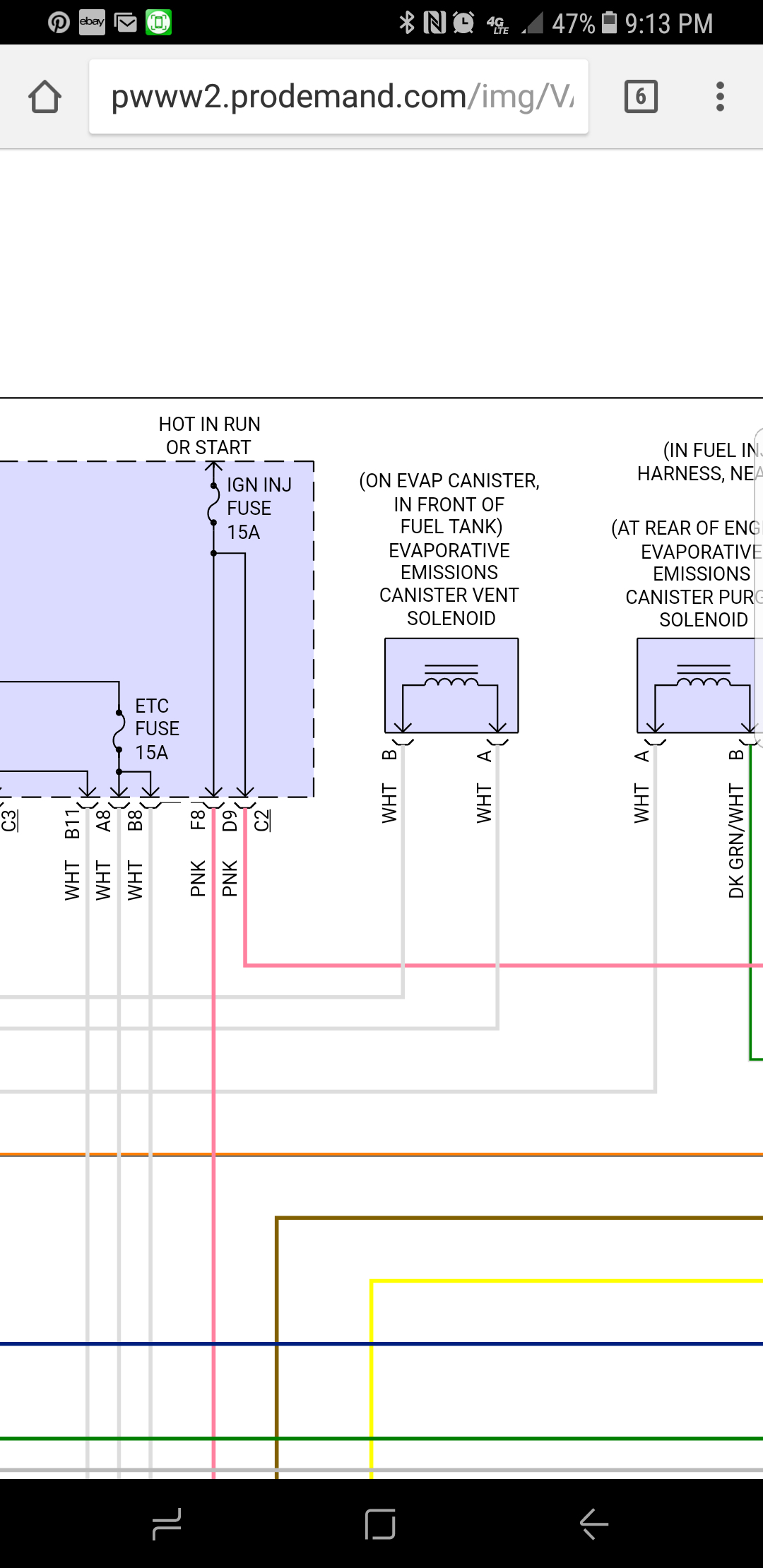

Ok so there is power to both sides of the fuse and there is no power at the pink wire at the control module
Aug 11, 2017 at 2:53 AM
SATURNTECH9
  • 30,868 POSTS
Do you see on the diagram I posted how there is two pink wires split off that fuse?One pink wire supplies power to the injectors and the other wire supplies power to the ignition control module.If there is power across that fuse then you need to see if there is power to those pink worse coming out of the fuse box.i suspect not since there is no power to ether part it supplies power to.

Ok I will take that fuse box loose this evening and see what I find and I will let you know what happens.

Ok so I went out there to start taking the fuse box loose and I had checked that fuse and was blown. I replaced it with another fuse and then checked the pink wire at the ignition module and now I have power. I also checked the pink wire going to the injector wiring harness and also it does have power to it. I tried to start it and nothing. But now we at least know we have power at both places.
