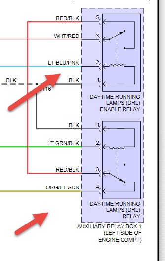

It will only stay running if I leave the battery charger on it or jumper cables, as soon as they are disconnected the truck shuts off. So if I try and get a voltage reading it's getting the voltage from the other car or battery charger. I'm bringing the battery down to the shop to have it load tested today. When connecting or disconnecting the battery I've done the positive terminal first and negative second. Sparks have happened but nothing out of the ordinary.

So, I found a couple blown fuses and replaced them, I then disconnected the battery and let the system drain completely, hooked up another almost new battery, and the truck fired up no problem. I now doscovered it has a miss under acceleration, the park break and ABS light is now on, and now my day time running lights and reverse lights will not turn on. Looks like I'll be busy for the next little while.

Rescan it fohe abs light it may have a bad sensor. Also the misfire a pro should diagnose as it can be a bunch of tings like a bad sensor, injector as well as vacuum leak and other basic engine problems. Check one of the relays in pic for drl lights. Witch with a like relay.

So I took the battery out and down to a different auto parts store and had them test it again. The first time I took it to AutoZone and the load tested it and said it was fine. This time I took it to a local small town store and they load tested right in front of me, the guy says at least 2 cells are bad. Picking up a new battery later after work. Will let you know how it goes.

Changed out the battery, started truck, checked voltage at battery with truck running and it was 12.0v.. Bad alternator. Replaced that and the truck runs great now. Thank you
