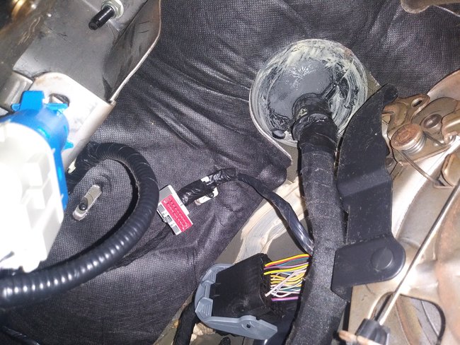

So i have heard of the anti-theft light red dot blinking rapidly after key insert, but this truck its a no start and the anti-theft light does not turn on with or without the key inserted? Fuses are checked all seem fine, fuel pump module not corroded... Any ideas?

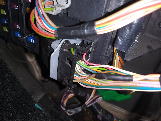

Before we go deep into this I want you to go to the passenger side of your vehicle and remove the kick panel cover for your fuse box and ensure that all connectors are fully seated. I have repaired several F-150's for this very concern when I found that the connector c270e was jarred loose by the passenger's foot pressing up against it, due to a bad design on Ford's part (don't get mad at your passenger). Let me know what you find, if it starts now you will make me smile, if not well I'll help you figure it out!

Going to give this a look at, thanks. I will update details.
Sep 30, 2020 at 4:21 PM
KARMATHEMECHANIC
  • 8 POSTS
Was connected but i noticed this wire has some tape on it don't think it was originally this way.
Update tape was just holding the wires together none of the wires were cut or nothing.

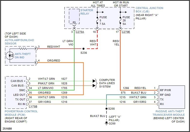

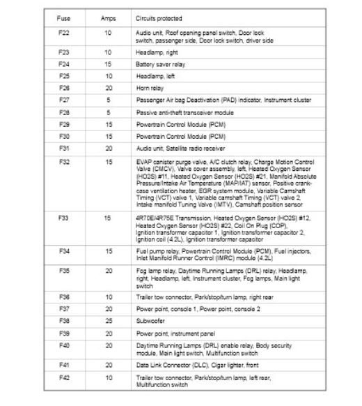

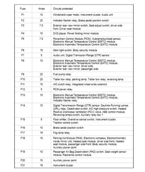

Fuse 5 is fire all the time like it should be.
Fuse 28 and has fire near the fuse box all the time with key off and is only supposed to have fire in the run position or start...
At the transceiver the red and yellow wire has no fire what so ever off or in the run position .
Could that be my issue?

If you give the key some movement while in on position it does flicker the dash lights off and on as well
If i supply fire from power probe on the red/yellow wire while the key is in the on position will it mess it up?

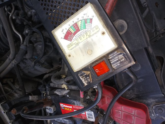

Battery is good. here's a pic terminals are cleaned up now as well as the fuse link connected near the battery.

So this is solved guys. I changed the ignition switch, after hearing on the 13 models they had a ground defect inside.. Changed it out and it started right up thanks everyone for the info and diagrams all that it did help in diagnosing the issue much appreciated.

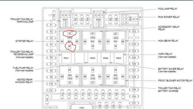

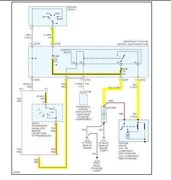

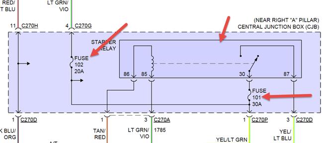

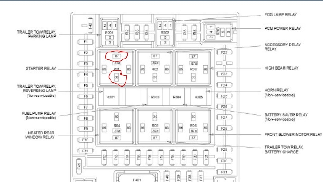

You can go to the relay and jump terminals 30 and 87 and see if the starter cranks the engine.

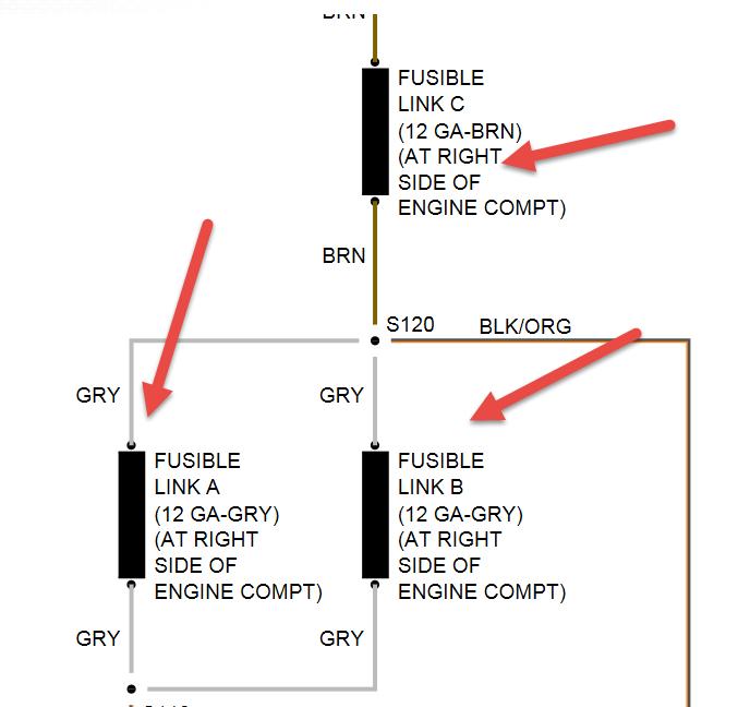

check battery for condition including load test most places do for free. check items in pic that are pointed out it maybe a fusible link or fuse blown. also your anti theft may need to be reset due to disconnecting battery

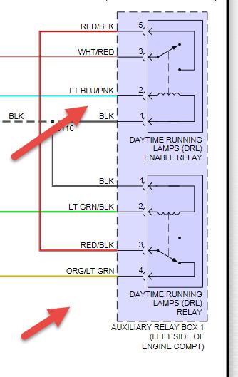

So, I found a couple blown fuses and replaced them, I then disconnected the battery and let the system drain completely, hooked up another almost new battery, and the truck fired up no problem. I now doscovered it has a miss under acceleration, the park break and ABS light is now on, and now my day time running lights and reverse lights will not turn on. Looks like I'll be busy for the next little while.

rescan it fohe abs light it may have a bad sensor. also the misfire a pro should diagnose as it can be a bunch of tings like a bad sensor, injector as well as vacuum leak and other basic engine problems. check one of the relays in pic for drl lights. witch with a like relay .
