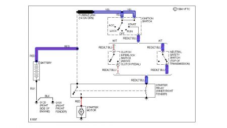

A couple days ago my friend borrowed my truck and filled it up with gas and started driving, down the street and lost all electrical power in the cab, everywhere, this happened after he hit a bump. he says that the battery hit the underside of the hood and arced. He decided that they were going to change the terminal mounts and upon trying to reconnect the negative it would spark, this blew the link between the starter solenoid and the positive battery cable. I replaced that cable and I still have no power to anything not even to engine bay fuse box. The batteries testing at 12.54 volts.

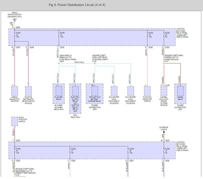

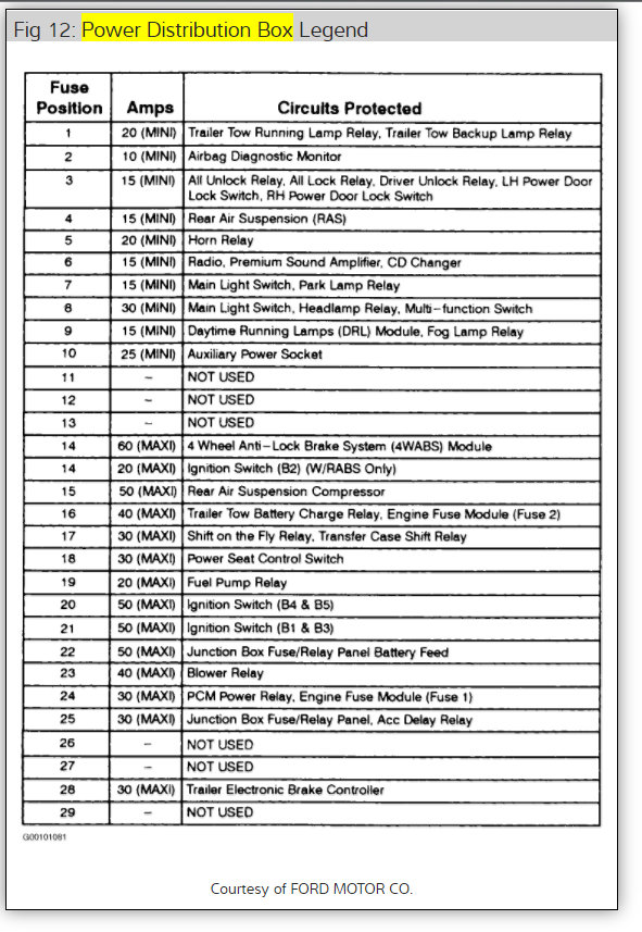

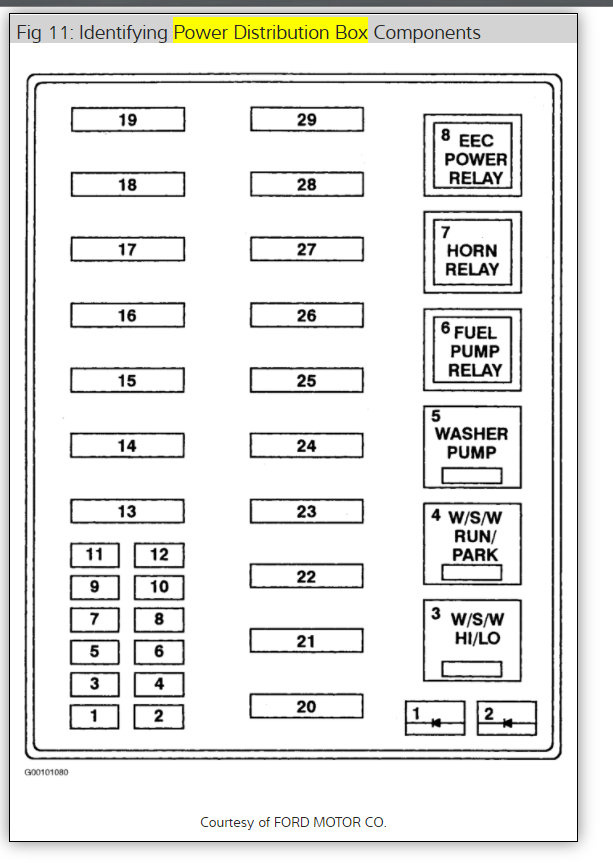

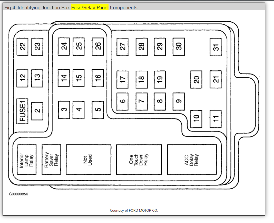

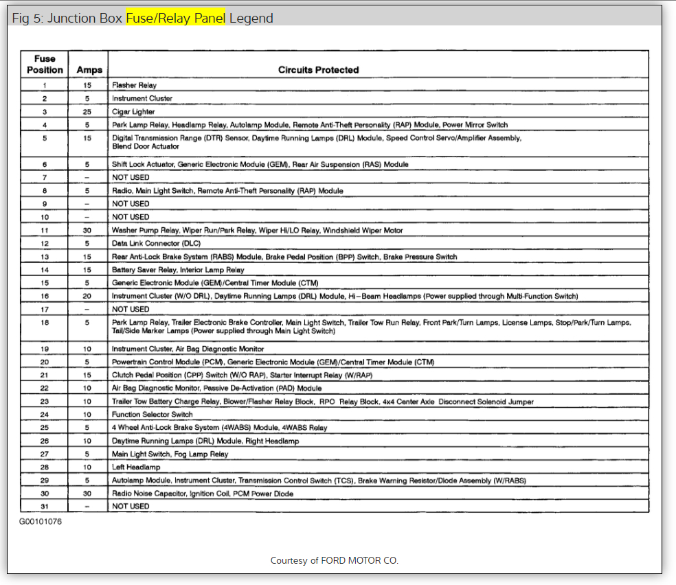

These pictures show you other things you can check.

Got it fixed. What happened s when the battery arced from hitting the hood, it fried my alternator. Got a refurbished one and got instant lights and cab Power. Truck started right up.

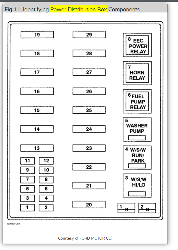

So today I was changing spark plugs on my 98 f150 and I touch one of the wires connected to the primary battery fuse on accident with a tool and got a spark. Didn't think much of it but now I have no power to anything in my car. No lights no click nothing. It's like the battery is not even in the car. everything was fine up until today . Battery has power and tried jump starting but wouldn't take. Ive check the majority of the fuses. All seem fine as well as swapped many relays Any ideas?
Jan 20, 2021 at 11:39 AM (Merged)
WRENCHTECH
  • 20,761 POSTS

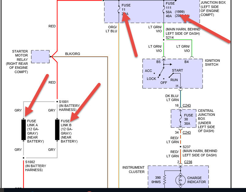

You burned out a maxi-fuse or fusible link. Here is a guide to help you test for the maxi fuse that is blown
Here are the fuse locations and identifications.

You have a main fuse blown somewhere.
CKH1992
  • 7 POSTS
I found the problem the MAXI fuse was blown 50 amp for the ignition switch. Thanks 2Carpros! I love this site

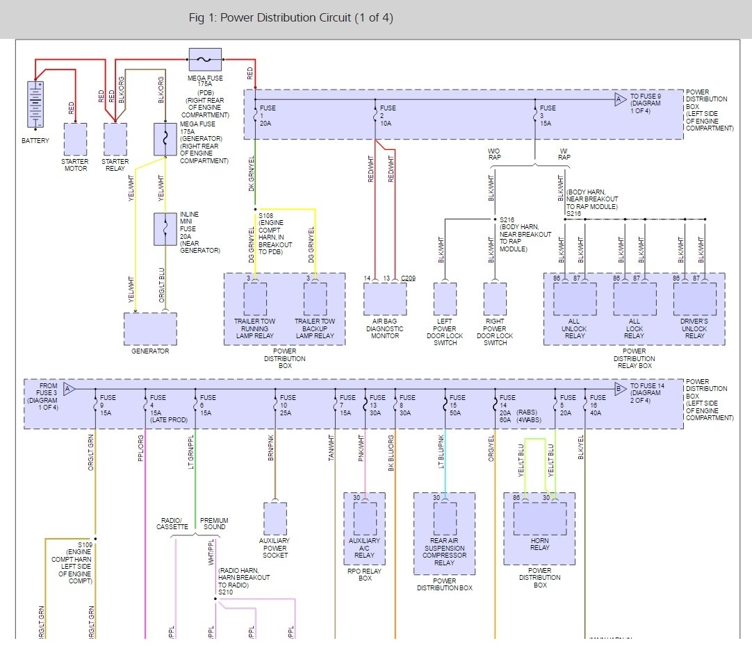

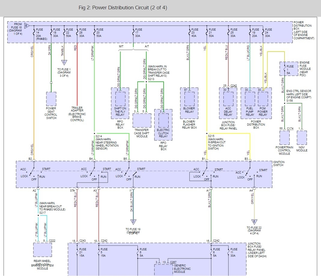

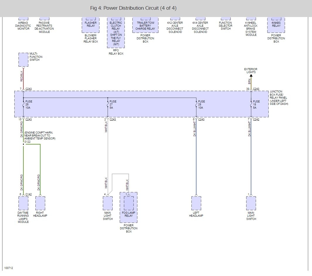

I recently purchased this truck. I hooked a scan tool to it but no codes showed. I changed fuel pump, fuel filter, plugs and wires. Checked all fuses and replaced burnt ones. Truck still is not turning over. I took battery off another vehicle which I know is good. It seems like it has no electrical power at all. No head lights. The signal lights work fine. The radio comes on but does not play. Since there is no power getting to anything I cannot tell what is wrong. Please help me with this.
  • 55,381 POSTS

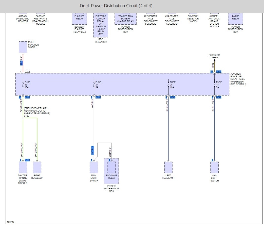

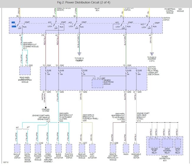

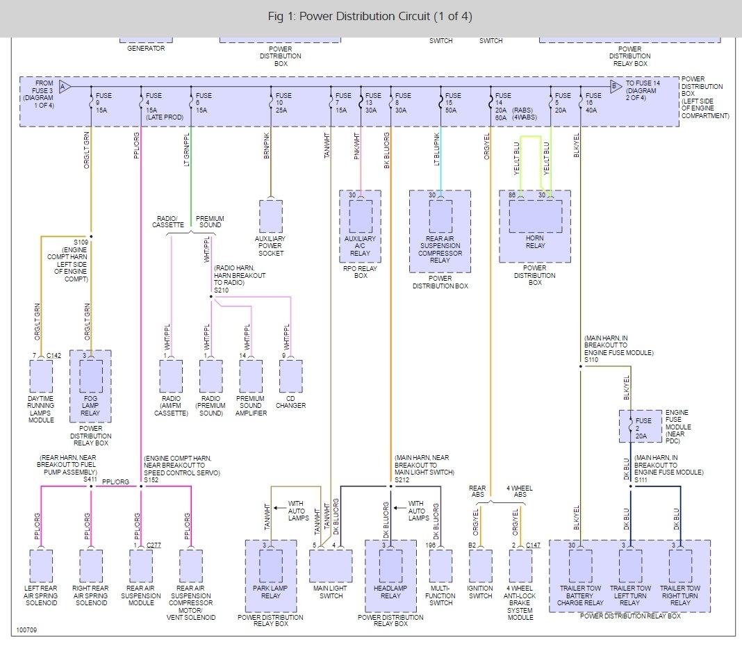

There is a main power fuse 175 amp that runs a lot of power accessories that should be checked. also, the ignition switch could have a side of it that is shorted out. here are some power distribution wiring diagrams that you can use for some testing. here is a guide on how to use a test light and test wiring.
and
Please run some tests and get back to us so we can continue helping you.
Best, Ken

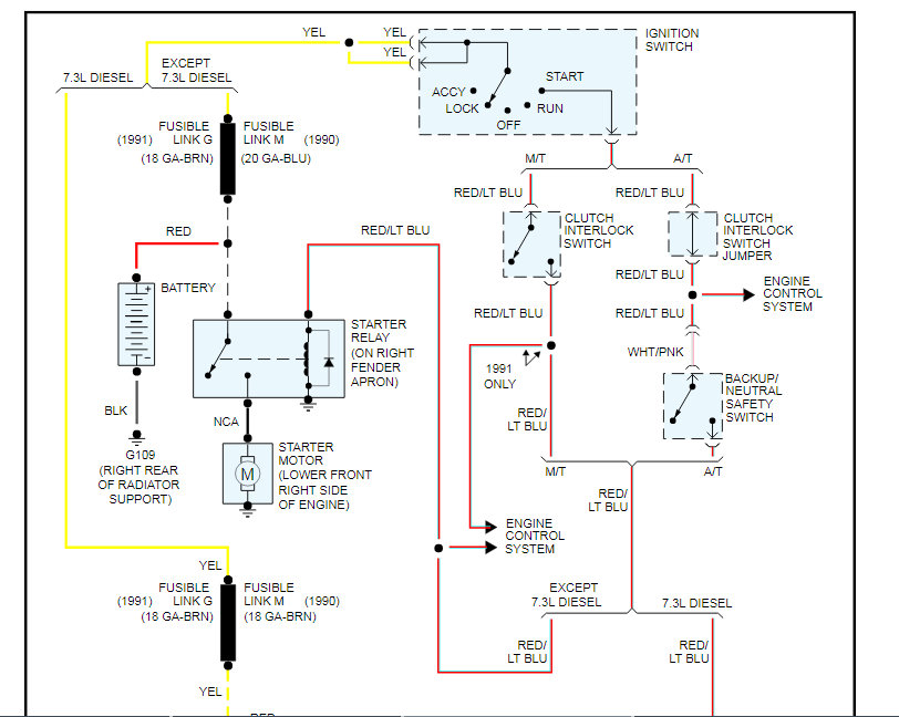

MOLLIEANNA1972
Initially, truck sporadically kept cranking only way to stop it was pull battery cable off. after replacing starter, solenoid, key ignition, ignition control modular headlight switch pigtail, alternator. Still didn't fix it. Drove truck shut it off i went to start it again, completely dead as if I had pulled the battery not even headlights. I then replaced battery, new battery cables, relay switch, replaced ignition modular again and replaced ignition again. Tested starter it was fine and checked inertia switch. Also checked all grounds were good. Still dead. Been using probe tester only positive wire up to the starter relay. After that all wires stay green. The signal wire from the ignition switch stays green too and it is supposed to have power. Can that be causing the whole truck to be dead? And what does that wire connect to? Any other ideas? I'm stumped!
Jan 20, 2021 at 11:40 AM (Merged)
SCGRANTURISMO
  • 4,897 POSTS

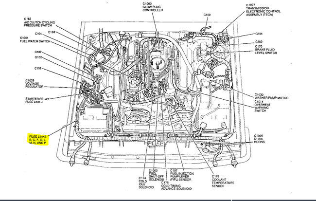

Okay, so you have no power at all with a new battery. Let's see if we can't find the problem and then find and fix the root cause of the problem. In the diagrams down below I have included a wiring diagram of your vehicle's starting circuit. Let's check the Fusible Link G and see if it's still intact. I have included a diagram with the component location in the diagrams down below for you as well. Please check this fusible link and get back to us with what you find out. We can go from there.
Thanks,
Alex
2CarPros

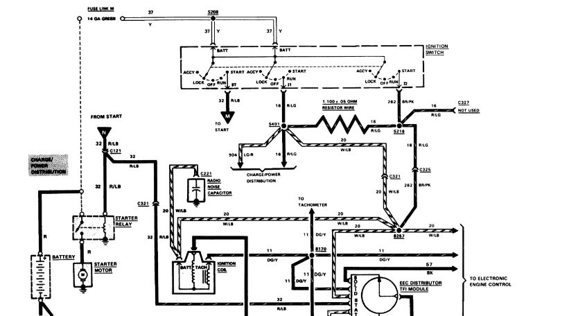

I just bought a 1986 f150.It is a stock factory vehicle with a 302.The starter relay was bad and the original owner had unhooked the wireing from it.There is no power to anything in the truck,no headlights,door buzzer,nothing.But the battery is fully charged.I would like to know which wires conect to to what side of the relay cause i think this is where the power starts.There are four wires in question and i will describe them from the end connecters to the harness;one black 16 gauge wire with a that plugs into the harness.one red 16 gauge that goes to a black fuse link and then becomes yellow,one black 16 gauge wire into an orange fuse link into black wire,one blue 18 gauge into black fuse link then becomes a yellow 18 gauge.I have already donated and I thank you.
  • 75,992 POSTS
Hi blackhat89, Welcome to 2carpros and TY for the donation How many small terminal on the starter relay if only one Put the red and light blue wire on the S small terminal the rest goes to the battery terminal on it coming from the battery not to the starter side of the relay Let me know

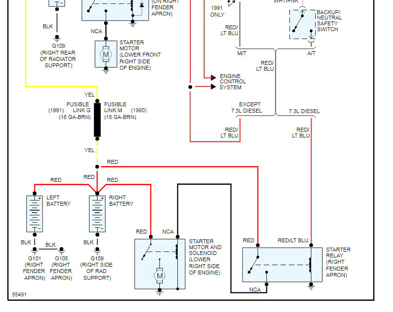

SANDERS CHRIS
  • 6 POSTS

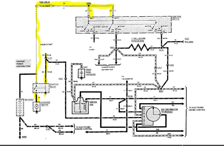

Cranks from starter solenoid but no power from key ignition. so I have no dash lights and no other power from the key ignition. how can I fix that?
MOTOR MASTER
  • 279 POSTS
Hello my name is Dave.
It sounds like you have a bad connection on the battery side of the solenoid, possibly a blown fusible link. Has the solenoid been changed recently? If it has I have seen a common problem where people accidentally connected the power buss (the group of wires that supply power to the vehicle) to be connected to the starter side of the solenoid, sometimes it is only one wire which can make it start by jumping it but also cause the issues you are describing. My suggestion would be to check these wires and to check if the fusible link has blown, you can do this by probing the wire with a test light on the other side of the link (looks like a small block on the wire) there should always be power to it. I hope this helps you find your problem and if you need further assistance we are always here and thank you for using 2CarPros.
Good morning,
Just to add, I will attach a wiring diagram for you to view of the starting system.
If you have a test light or voltmeter, you can do some checks.

Okay, just as Dave said in his reply, check the fusible link that I listed in the diagram at the battery or at the solenoid.
JDL
  • 16,098 POSTS
I agree with my friends. The two wires at ignition switch in diagram, is hot all the time. If those two wires are not hot, replacing the ignition switch won't help anything. You can see fusible link in diagram. Sorry, I just realized the diagram was already posted, my bad.

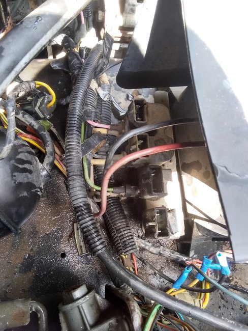

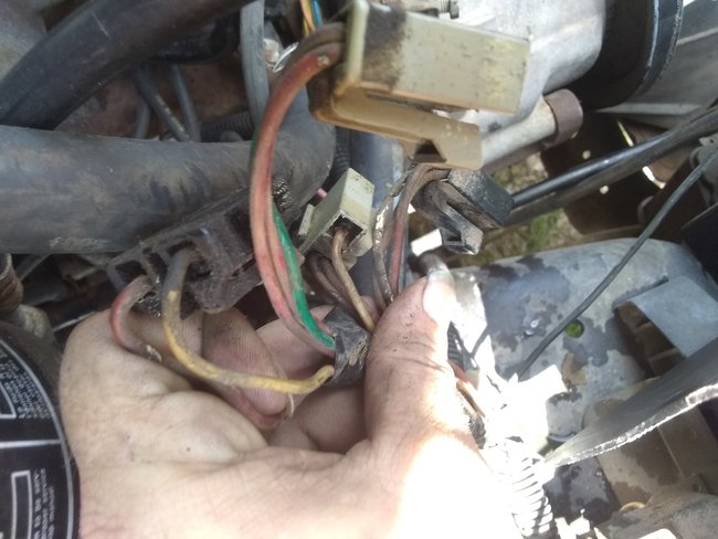

SANDERS CHRIS
  • 6 POSTS
Okay, I checked around some more like y'all said and came across this and they looked burnt and had no power to them.
Yep. They are the links.
The issue is, why did they fail. Just like a fuse, they fail for a reason. If you do not find the reason, you did not fix anything.
