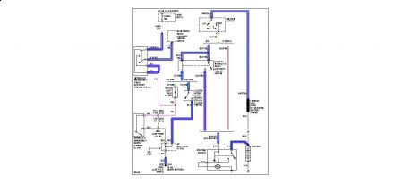

I have a 1992 Nissan Hardbody (D21) with a KA24E. Until recently my truck started fine. Occasionally my truck will not start or start after a few times of trying. I have replaced the starter and got it tested to make sure it was good, replaced the cables both positive and negative, and made sure the clutch switch was working properly and the connection was good. There is still no start. I can dump the clutch and it will start so far that is the only way to start it. What is the problem?

Check and test the starter, starter clutch interlock relay and the clutch interlock switch and emergency relay and switch and last the ignition switch
https://www.2carpros.com/forum/automotive_pictures/12900_nissan_start_circuit_1.jpg
