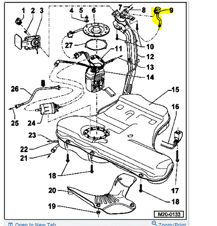

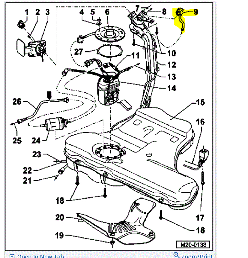

I believe that is a non-return valve, but it is difficult for me to orient myself with the pic. Take a look below, I attached an exploded view of things. Can you tell if the highlighted part is what you are referring to?

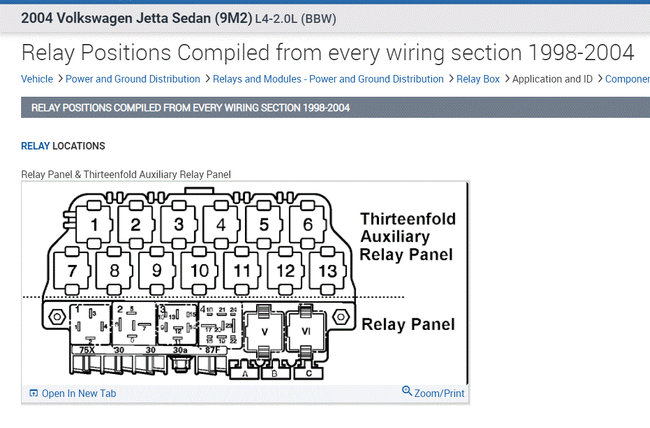

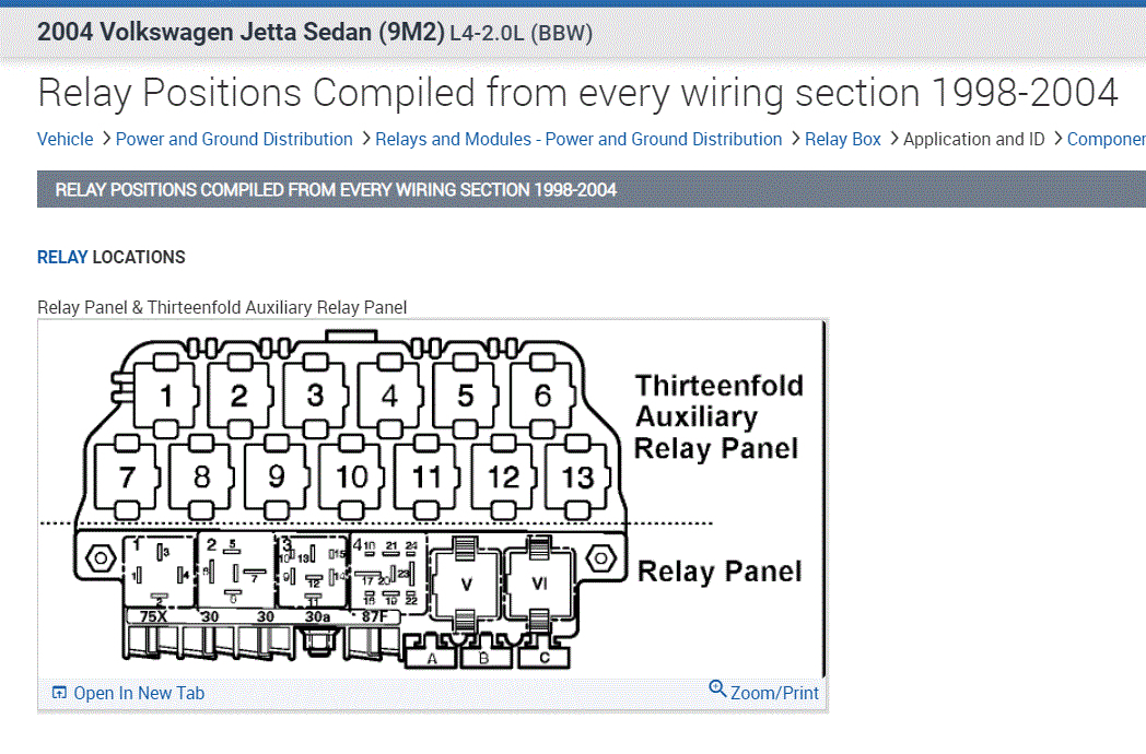

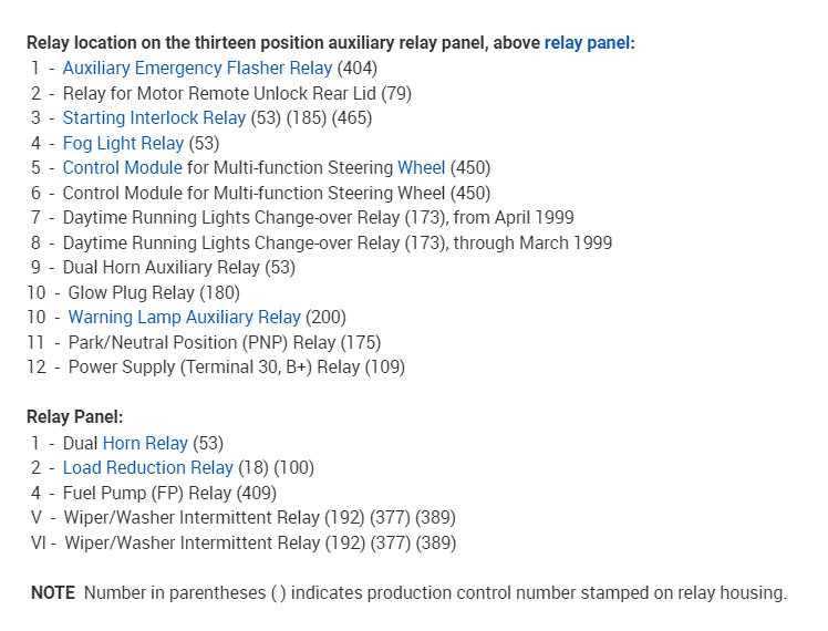

Also, I attached info on the relay panel. See pics 2 and 3. Let me know if that is what you needed.

Yes, yes great. I think that is what it is. I think I snapped it back together correctly, but any ideas of what else would cause this besides pump or filter? I guess injectors but wouldn't that throw a code? Or not? I'm not really sure where to go from here but I really need to get it running because it's now my only vehicle. What would be your next move here? And thanks, hope you have a great Easter too.

It could be an injector issue, but the pump is the most common. Is the pump now operating properly? If it is, see if that took care of the issue. If it doesn't, we will start checking for issues with the injectors.

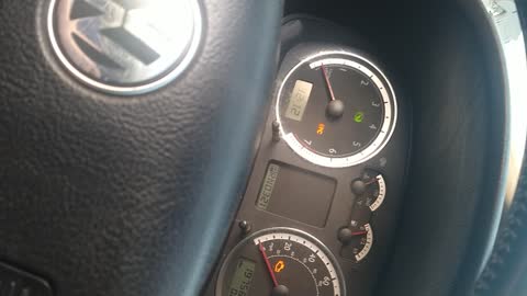

Here's video.

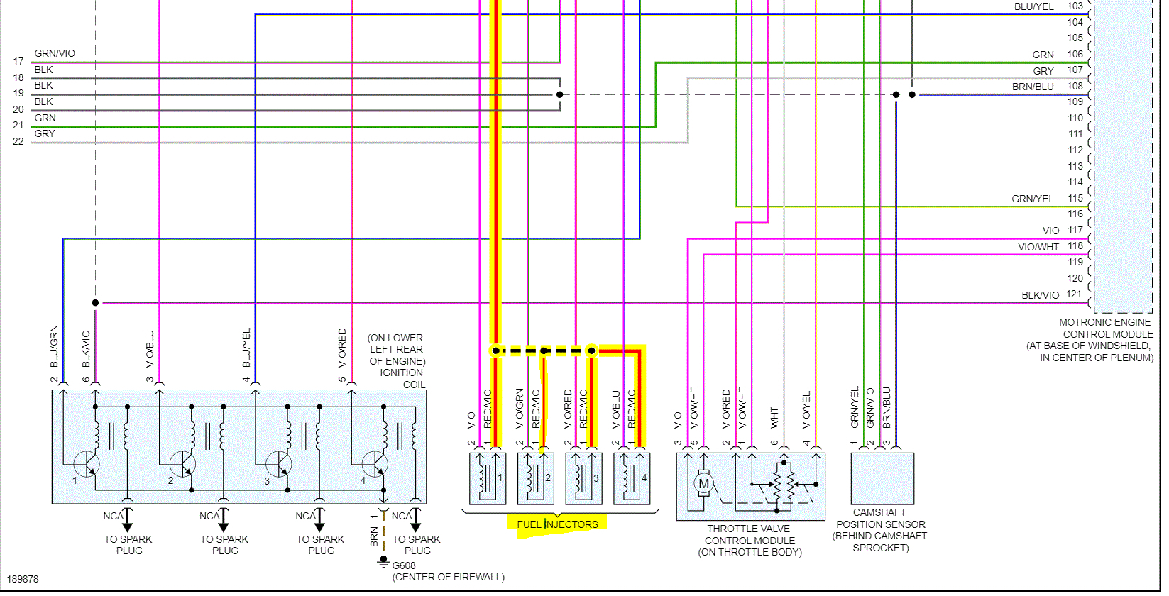

Let me know. Also, I need you to check for power to the injectors. At each fuel injector, there will be two wires. Each injector will have a wire that is red with a violet stripe. The second wire at each injector will be a different color.
The red/violet wire gets 12v from fuse 32 in the fuse panel when the key is in the start or run position. The wires which are different colors are the grounds for each. A ground path is provided via the PCM at a specific time and for a specific amount of time. At that point, the injector allows fuel to enter the engine.
So, I need you to get out the multimeter and check to see if the red/violet wires have power at each injector. Do this with the key in the run position. If there is nothing, check fuse 32 in the fuse panel and also make sure the fuse has power.
Let me know what you find. Also, if you could record the engine cranking in the video, it may be helpful for me. I attached a pic below that you can use as a reference.
See pic below.
