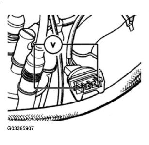

CAMSHAFT POSITION SENSOR, CHECKING Disconnect harness connector on Camshaft Position Sensor at Ignition Distributor. Connect Fluke 83 multimeter with adapter cables from VW 1594 to measure voltage across outer terminals of connector.
https://images.2carpros.com/forum/automotive_pictures/99387_vw_4.jpg
Switch ignition ON. Specified values: Up to 10.93 production, 49-states: 10 Volts min. Up to 10.93 production, California: 5 Volts min. From 10.93 production, all vehicles: 5 Volts min. If OK: Replace Ignition Distributor. See Ignition distributor, removing/installing . If NOT OK: Replace Motronic Engine Control Module (J220).

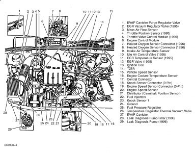

Could u give me a pic of where the Motronic Engine Control Module is located the book i have don't show u much as far as location.
Dec 20, 2016 at 3:11 AM
PITT51
  • 15 POSTS
what exactly is the Montronic Engine control module?
BMRFIXIT
  • 19,053 POSTS
https://images.2carpros.com/forum/automotive_pictures/99387_Graphic1_236.jpg
https://images.2carpros.com/forum/automotive_pictures/99387_Graphic2_113.jpg

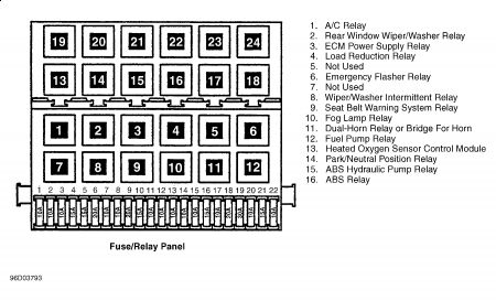

I have already checked all the fuses and all were good. Is there any kinda relay,fuse,or fuseable link that could cause anything like this ?
BMRFIXIT
  • 19,053 POSTS
relay # 3
check it check for power
did u check the plug and wires into the dist.under the cap
PITT51
  • 15 POSTS
Yes the wires and plugs are fine matter of fact we had to take the plugs out yesterday cause we flooded it trying to get it started . Ok if the relay is getting power any way to tell if its bad ?

u know that you have a crank sensor or engine speed sensor at the rear of the engine by the flywheel
you may wont’s to give it a check
PITT51
  • 15 POSTS
We know about the Crank sensor but we can't seem to find it anywhere .... do u have a pic that shows about where it is located ? we are having no luck finding it .
BMRFIXIT
  • 19,053 POSTS
check the picture i had sent
# 20
PITT51
  • 15 POSTS
Ok the relay #3 didn't change anything i even bought a brand new one is it possible that isn't the slot for it ? the Crank sensor is plugged in what else could i check?
