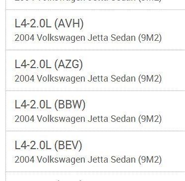

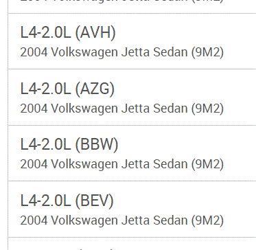

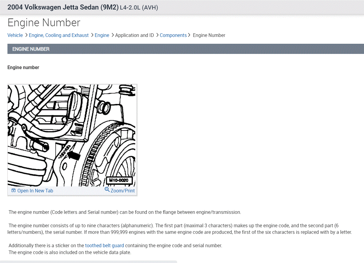

However, before we jump to testing pressure, I would like to check fuses and relays. However, I need to know the engine code. There are four different codes related to 2.0L. See pic 1 below. Each code provides me with a different wiring schematic, so I need to have the correct one.
To locate the code, you can check for a metal tab at the front of the cylinder head or a sticker on the timing cover. If they are not available, see pic 2 to locate it on the rear of the engine.
Let me know which one it is.

Sorry for late reply it's the bbw engine and I'm sorry that was a typo did not make much sense i meant it started as a crank no start but now it is no crank no start , meaning when i turn the key i do hear and feel a click from a relay (not positive it's the right one), but that is all that happens when i turn the key. Besides that, nothing happens at all. I took the one ignition wire off of the starter and connected it briefly to battery positive and it will crank the engine that way but I'm not even positive what exactly that means could it still be the solenoid? Or what? However, when i plug it back into the starter how it is supposed to be and i turned the key to start i get nothing, no cranking.

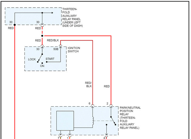

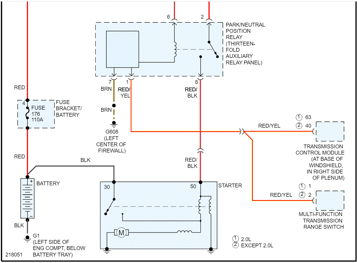

If it isn't cranking, we need to focus on that first before we move ahead. I attached the starting system wiring schematic below, so you have a reference.
First, see if it will start in neutral. If it doesn't, we need to check if there is power at the starter.
If you note in the pic, there is a black wire to the starter that has 12v at all times. The red wire with a black tracer should only get power when the key is in the start position. Get a helper to turn the key for you and confirm if there is power or not on the red/black wire.
Let me know what you find.

Okay, neutral didn't help, it is getting power. Something is draining the battery fast though like I'm sitting there watching the volts drop and it's drained within a few minutes. Which is strange since battery alternator and start all tested good at Orielly's, it really makes it harder to diagnose when i keep having to put cables on it. I did how ever get a better scanner and two codes popped up which I'm pretty sure is related just not sure what to fix or how to go about testing. The codes i got this morning were p0705 transmission range sensor A circuit (PRNDL input) i also got one for circuit B but forgot to get a pic. It said the same thing just B circuit. It also said A was a pending code and B was current for some reason. Pretty sure it's related but if you could explain how or what i need to replace, would greatly be appreciated. Thanks

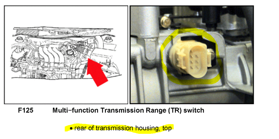

  • 110,248 POSTS
I really don't like the voltage draining that fast. Is there anything as far as wiring near or around the battery that looks damaged?

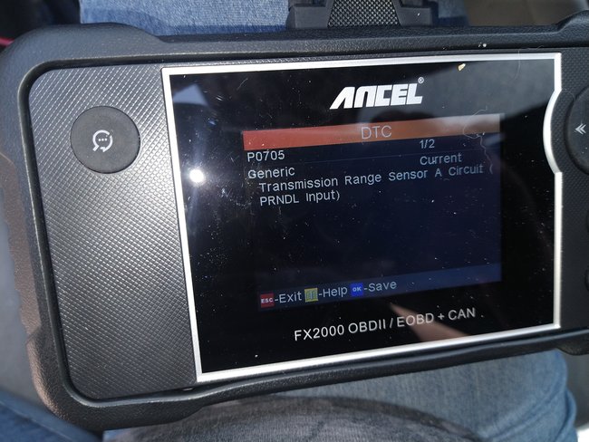

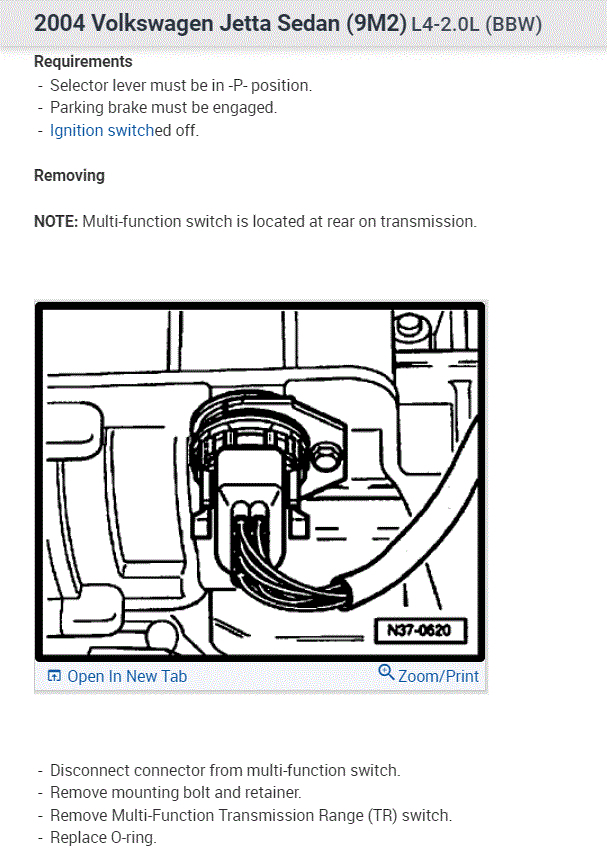

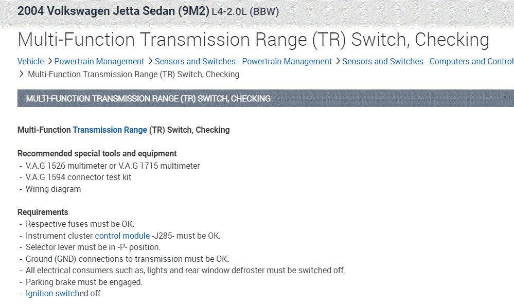

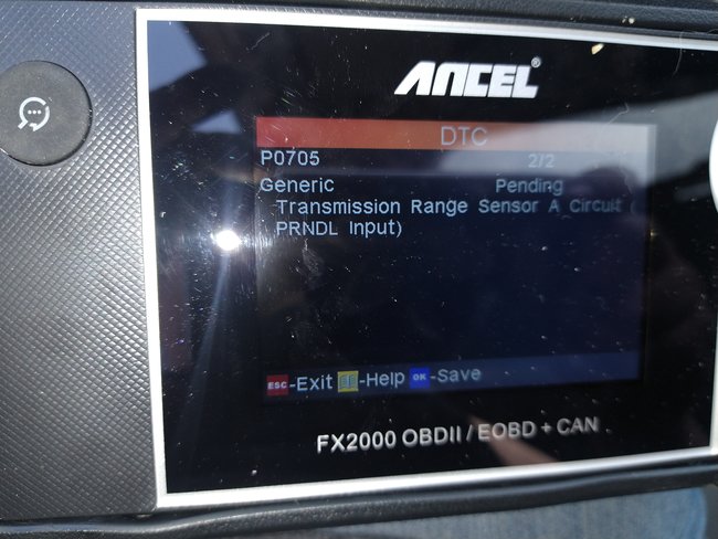

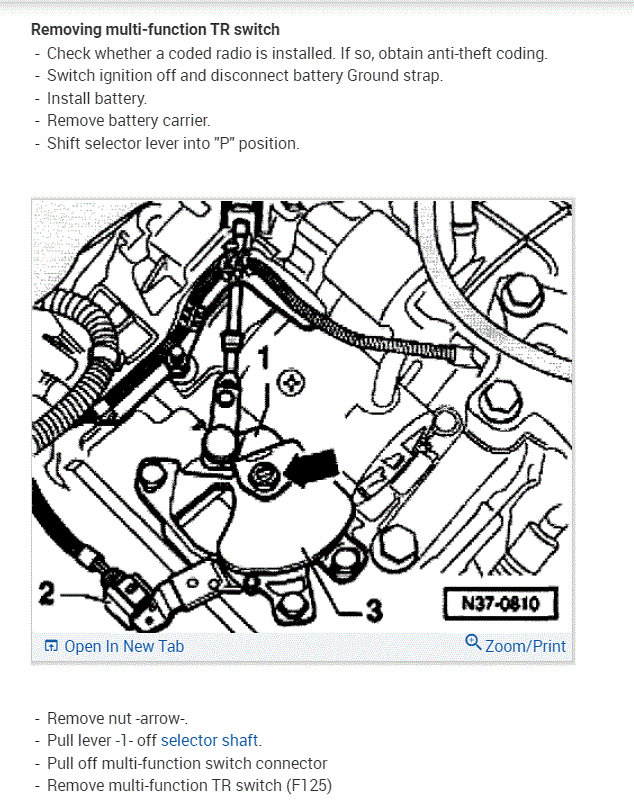

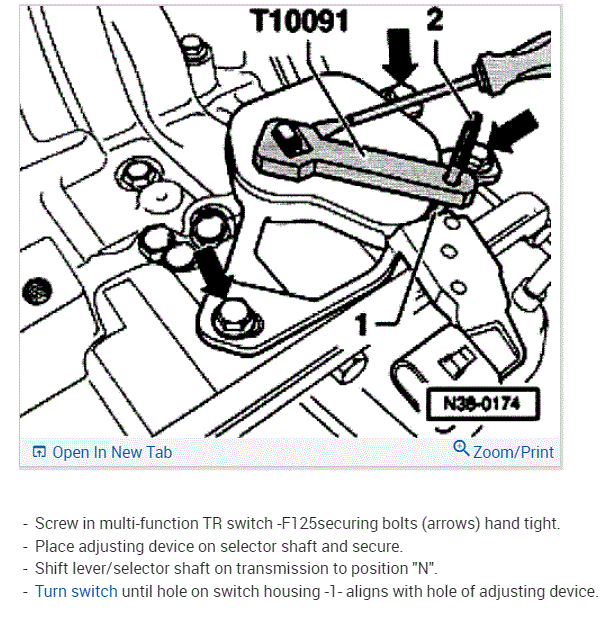

As far as the code is concerned, it is related to the transmission range sensor. When I asked if it started in neutral, that is what I was trying to determine. If there was a problem with that sensor.
If you look at the pic below, I included a pic showing the sensor location and the sensor.
Start there and check to see if anything is shorten or damaged.
Next, if you are drawing that much power that quickly, something is getting hot. Pay really close attention to this, heat. When the battery is connected, feel the battery cables, open the fuse box and feel the fuses and relays, and note if any are hot.
Let me know what you find. Also, please be careful at this point. This heavy of a battery draw can lead to a circuit overheating and causing a fire.
If you are finished for the day and haven't found the cause, disconnect the battery.
Mar 31, 2022 at 7:13 AM

Does not make difference in neutral and no I'm not seeing any damage. And will be disconnecting battery every time not in use so is it going to be that sensor that i need to replace?

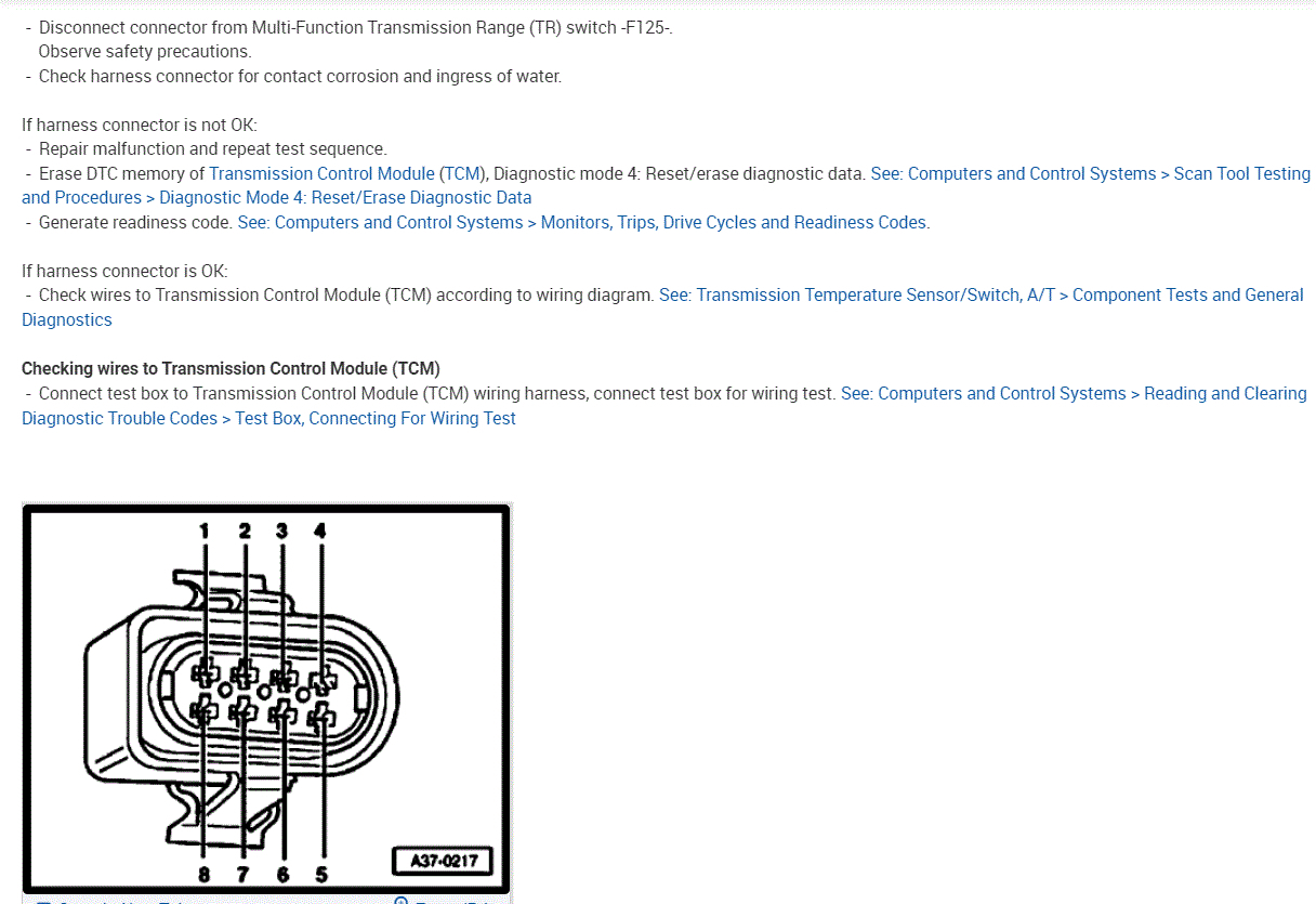

  • 110,248 POSTS
Christa,

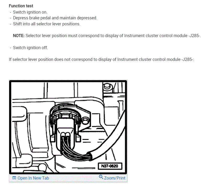

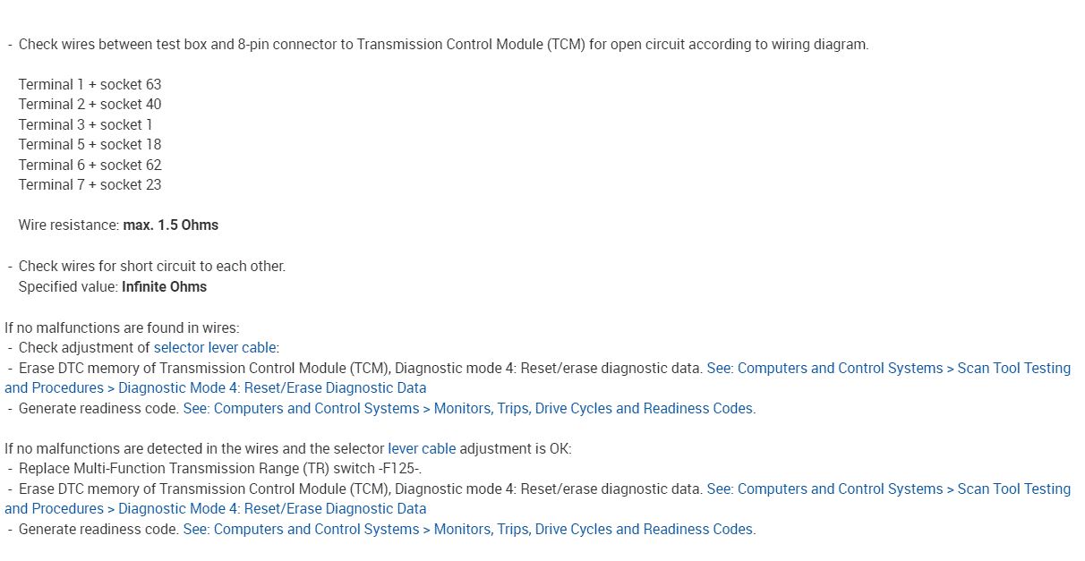

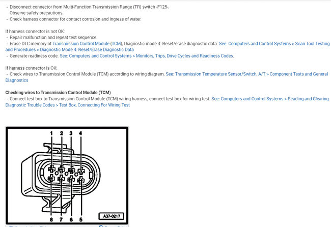

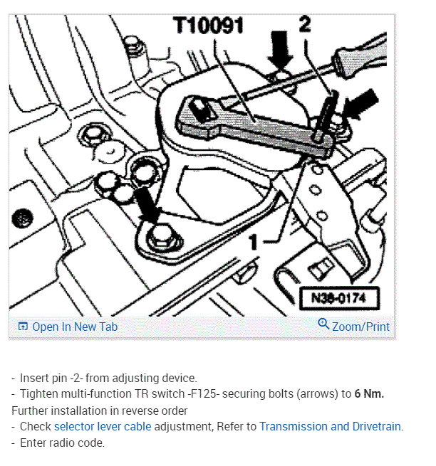

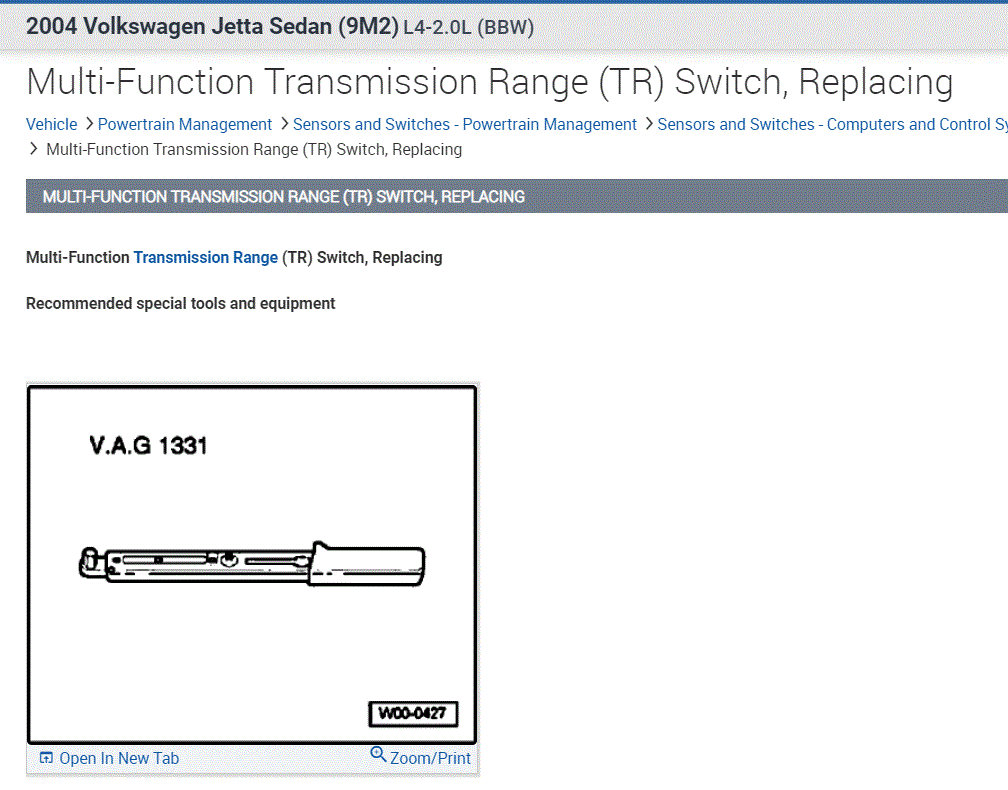

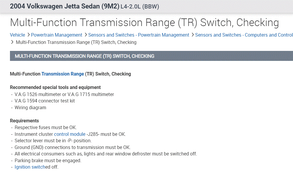

I would like to say yes, but in most cases, the code provides a starting point. Here is what I suggest. Take a look through the diagnostics below. (pics 1-4) Is this something you feel comfortable doing? Also, the remaining pics explain how to both remove and replace the range sensor and how to adjust it. See if the adjustment is the issue.
Again, when you have the battery attached, check for electrical wires, relays, fuses, and modules to see if any are hot.
Mar 31, 2022 at 10:58 AM

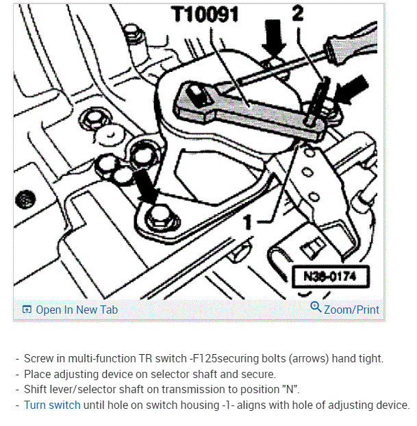

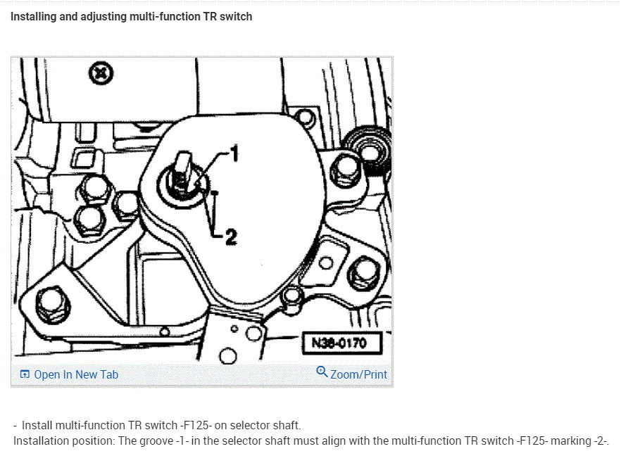

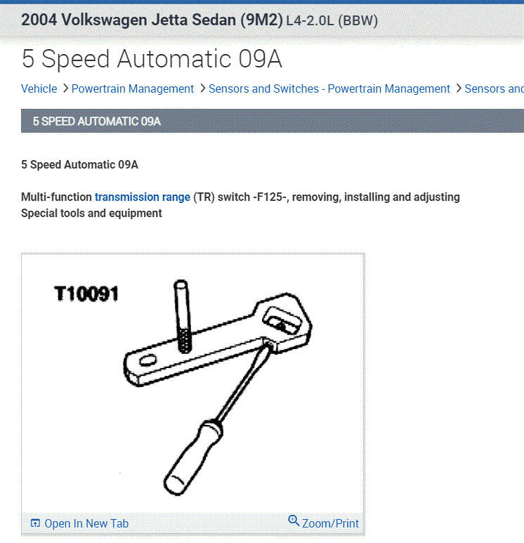

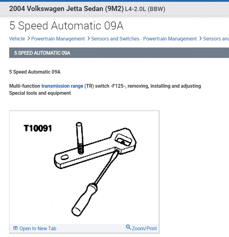

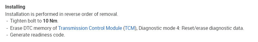

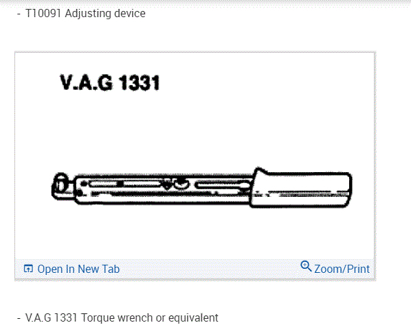

As far as the sensor is concerned, if the testing indicates all is good, then the sensor must be bad. I attached the directions below for the removal and installation of the transmission range switch. Let me know if you have any questions.

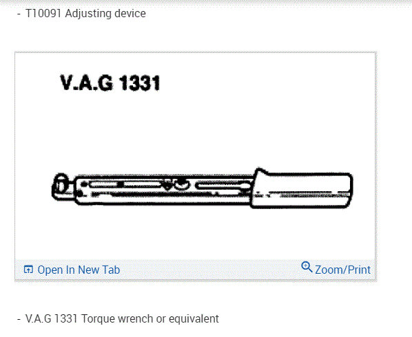

Okay, now I'm confused, am i going to need that t10091 tool or not?
Apr 4, 2022 at 6:21 PM
  • 110,248 POSTS
Christa,
That is just a torque wrench, and really nothing special. VW loves to show everything needed and then give them a part number. I swear they do it on purpose. LOL
If you don't have one, a parts store will lend one to you. Or we can just make sure all the bolts are tight.

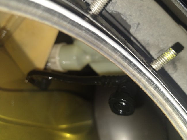

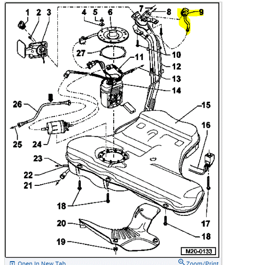

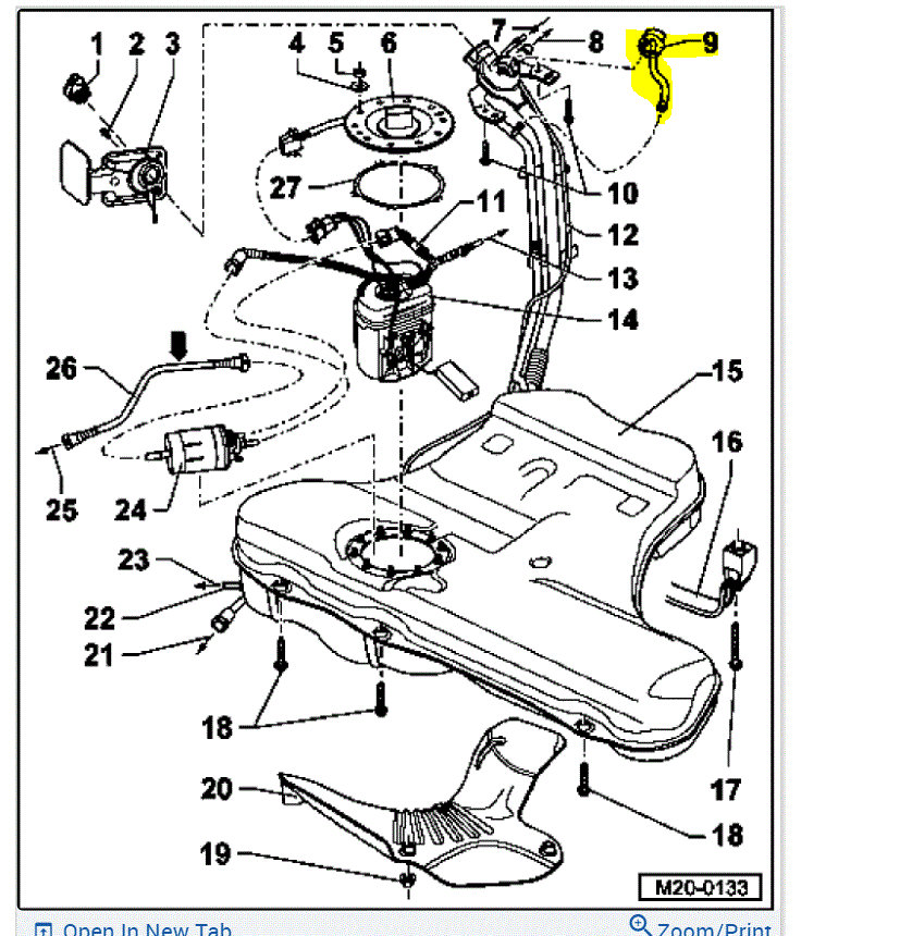

Okay, so, got the switch fixed it franking fine now. Replaced bad battery so constantly draining is resolved it is definitely fuel related because with starter fluid it starts for a second then shuts off, but i have quadruple checked work and pretty sure it's in correctly. There is this small white plastic canaster inside the tank to the right i noticed popped apart i'd like to know what this is if you know. i put it back and it seemed to snap into place fine. What else could be causing this?

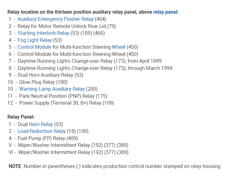

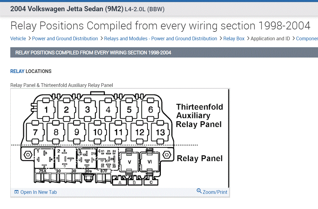

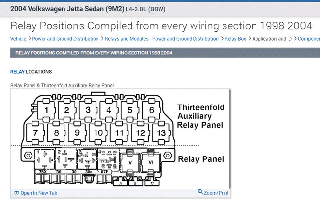

Also, if i could get a specific good relay diagram that would be great so many conflicting ones online.
Apr 16, 2022 at 10:16 AM
  • 110,248 POSTS
I believe that is a non-return valve, but it is difficult for me to orient myself with the pic. Take a look below, I attached an exploded view of things. Can you tell if the highlighted part is what you are referring to?
Also, I attached info on the relay panel. See pics 2 and 3. Let me know if that is what you needed.

Yes, yes great. i think that is what it is. i think i snapped it back together correctly, but any ideas of what else would cause this besides pump or filter? i guess injectors but wouldn't that throw a code? Or not? I'm not really sure where to go from here but i really need to get it running because it's now my only vehicle. What would be your next move here? And thanks, hope you have a great Easter too.

Yes, the fuel pump seems to be working fine. I forgot to mention yesterday before getting the new battery i put scanner on and 10 pending codes popped up! I unplugged battery , ended up having to replace it and when i looked again they were gone i don't know if that relevant but the pending codes i got were p0264,p0445,p0261,p0270,p0267 ( i think injector codes) p2401, p0043, p0037, p2257 and p0230, but i have since replaced battery and pump out and there not coming up anymore but seems like something wigged out pretty bad. i only had this car a few weeks before it started giving me these problems as far as first few weeks went i knew when i bought it had an exhaust leak so ran a little loud for sure i was able to locate a tear between the engine and cat in the metal "braided" area. at this point in regretting buying it. First VW ever, not off to good start.

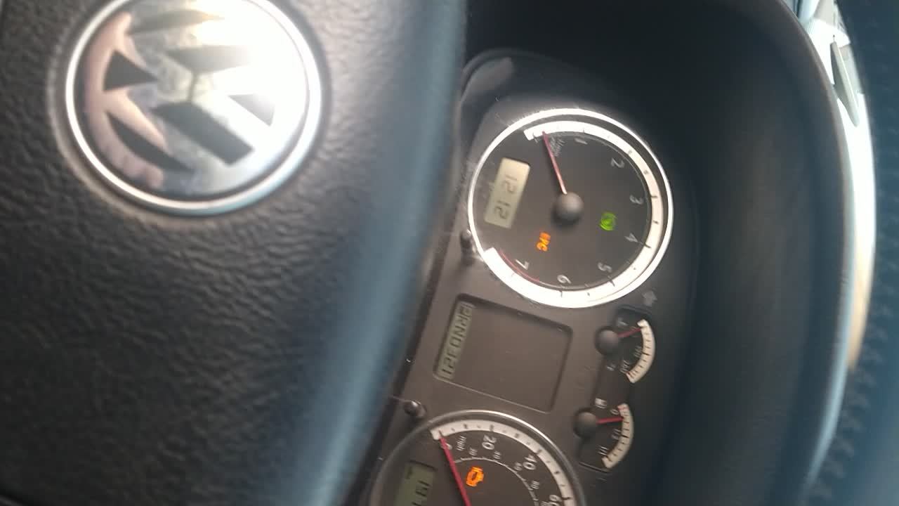

CHRISTA DICKSON
  • 150 POSTS
Here's video.
Apr 17, 2022 at 10:34 AM

The codes are gone because the battery was disconnected. Interestingly, many of them are related to low voltage, which may or may not have to deal with the battery. Also, four of the codes are directed to the fuel injectors (low voltage).

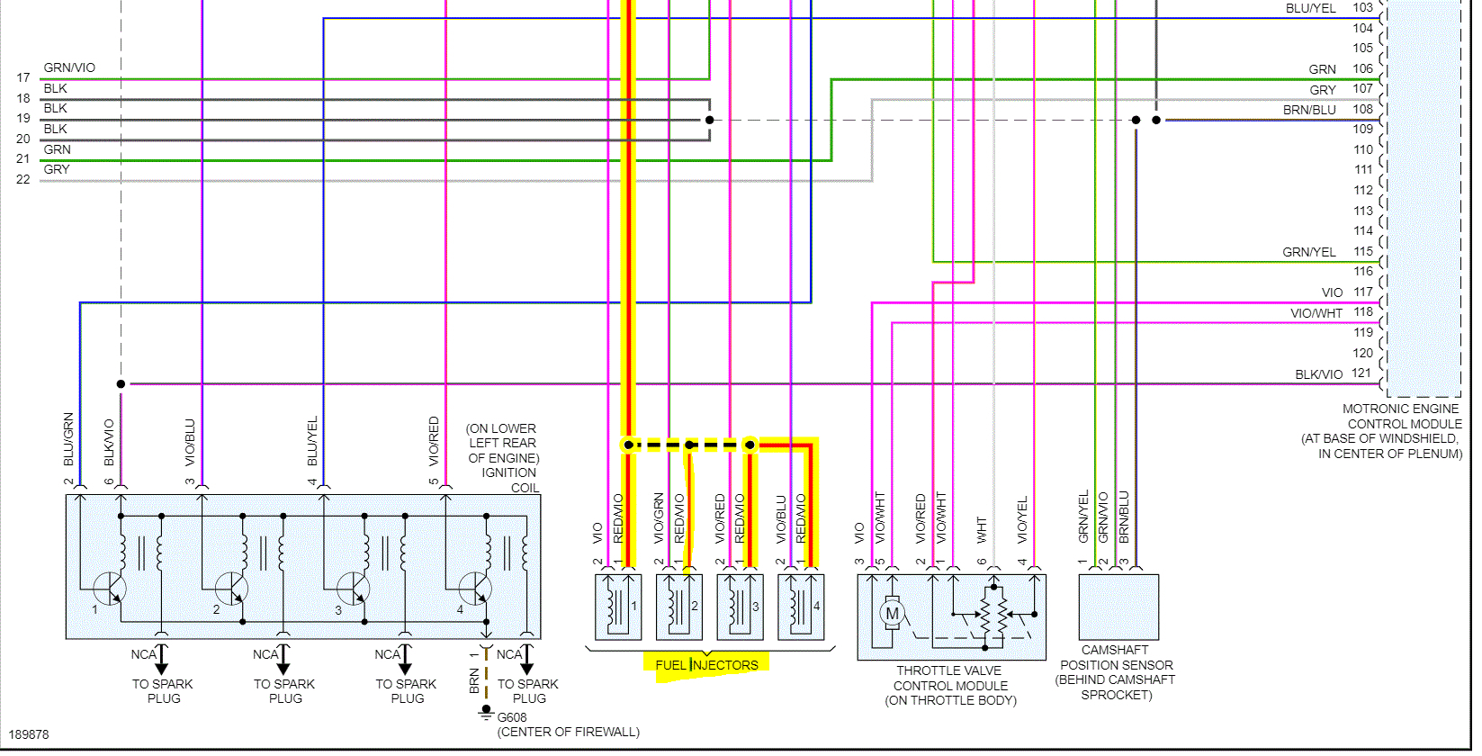

Let me know. Also, I need you to check for power to the injectors. At each fuel injector, there will be two wires. Each injector will have a wire that is red with a violet stripe. The second wire at each injector will be a different color.
The red/violet wire gets 12v from fuse 32 in the fuse panel when the key is in the start or run position. The wires which are different colors are the grounds for each. A ground path is provided via the PCM at a specific time and for a specific amount of time. At that point, the injector allows fuel to enter the engine.
So, I need you to get out the multimeter and check to see if the red/violet wires have power at each injector. Do this with the key in the run position. If there is nothing, check fuse 32 in the fuse panel and also make sure the fuse has power.

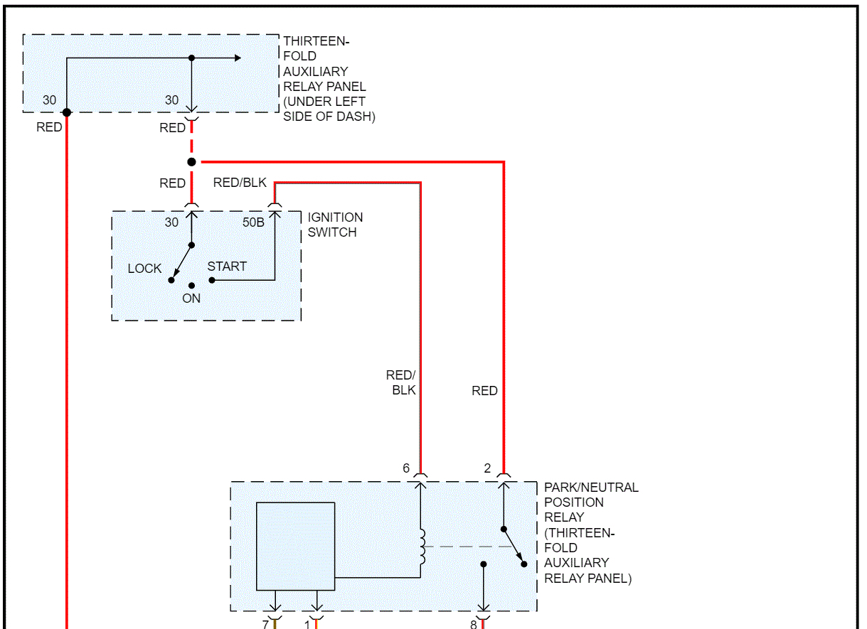

Let me know what you find. Also, if you could record the engine cranking in the video, it may be helpful for me. I attached a pic below that you can use as a reference.
See pic below.
Apr 17, 2022 at 1:39 PM
