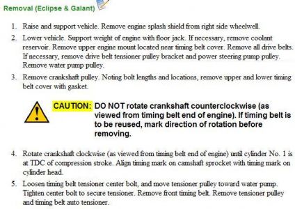

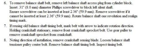

How do I remove the timing belt to replace the chrankshaft sensor

Follow the steps below to remove the timing belt and access the crankshaft sensor.
https://www.2carpros.com/forum/automotive_pictures/261618_Noname_2467.jpg
https://www.2carpros.com/forum/automotive_pictures/261618_Noname2_807.jpg
