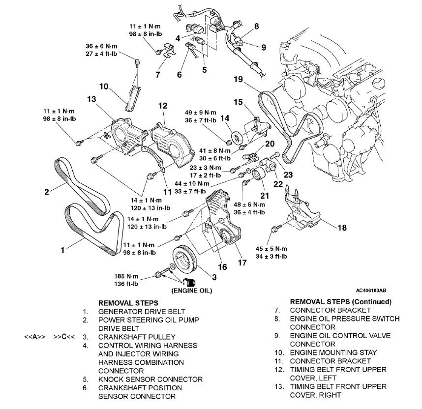

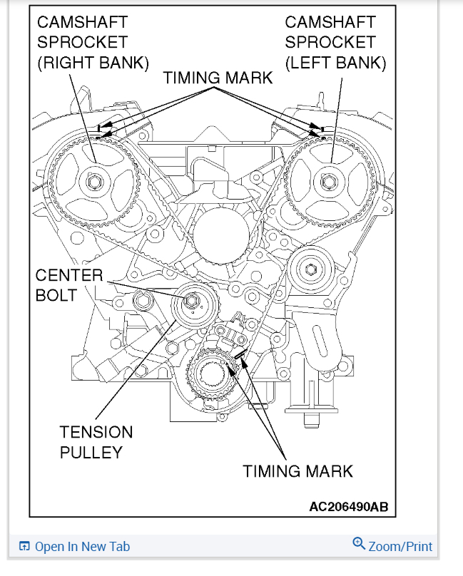

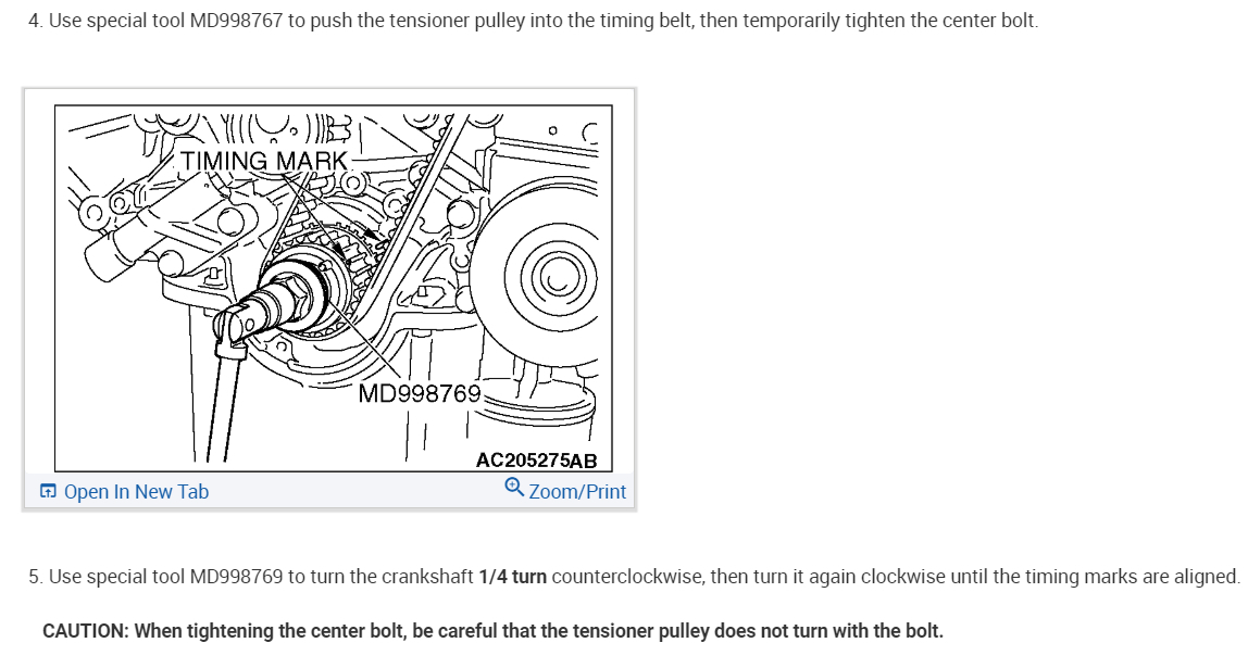

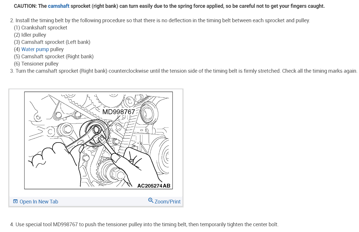

Does 3.8 liter v6 have a timing belt and is it hard to replace?
Monday, May 10th, 2010 AT 9:04 AM
21 Replies

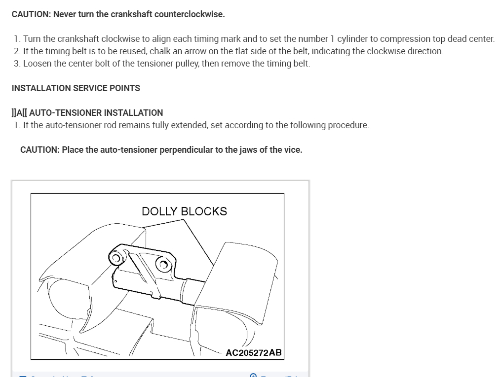

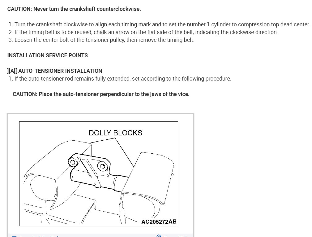

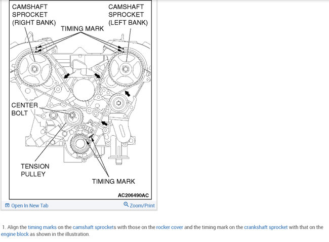

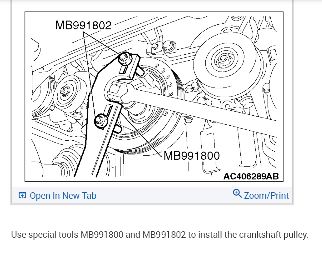

MHPAUTOS
  • 31,937 POSTS
Hi there,

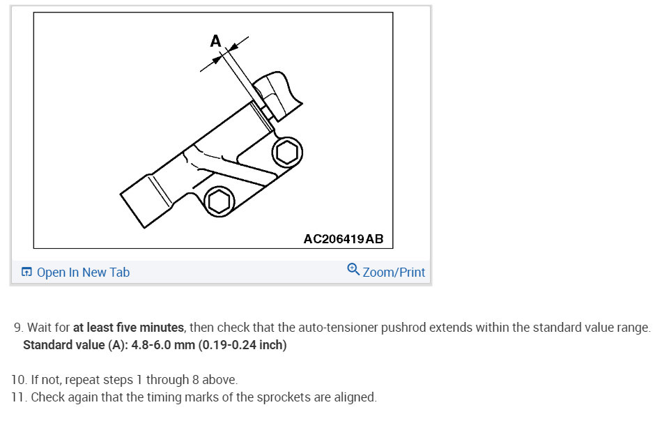

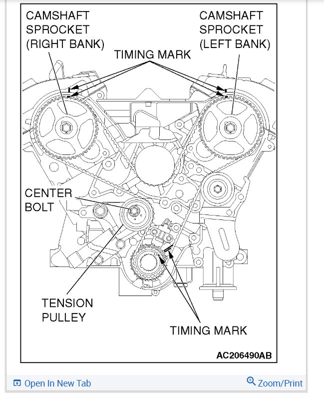

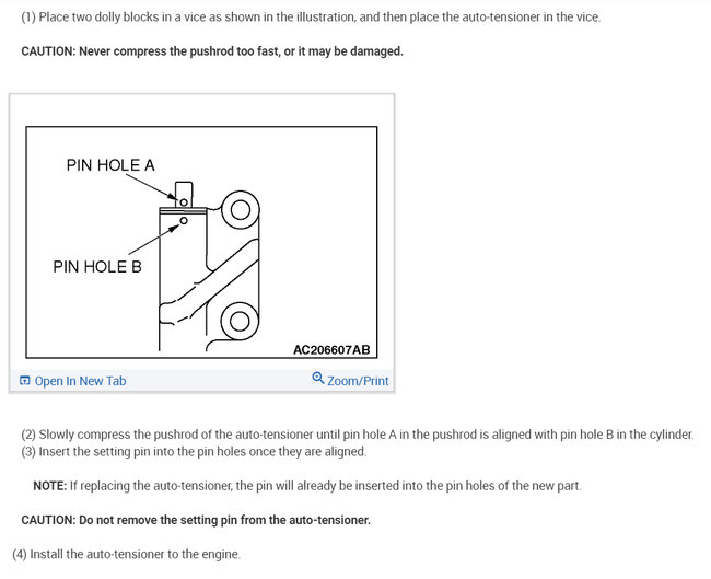

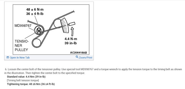

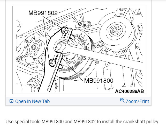

This engine has a timing belt, here is how to replace the timing belt int he diagrams and instructions below. Check out the diagrams (Below). Please let us know if you need anything else to get the problem fixed.
Monday, May 10th, 2010 AT 9:12 AM

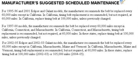

I've always been told that my timing belt should be changed at around 50,000 - 60,000 miles but am now being advised to change my timing belt because my car is 5 years old. What's the truth?
Tuesday, June 2nd, 2020 AT 12:43 PM (Merged)
ZACKMAN
  • 4,202 POSTS
https://www.2carpros.com/forum/automotive_pictures/55316_mitsubelt_1.jpg
You don't have to replace, but it would make sense to at least inspect it.

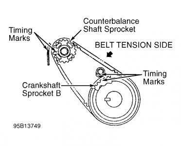

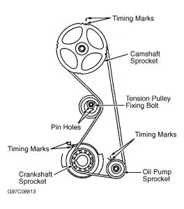

My timing belt came off n I was needing to know how I get everything back in time.
BLUELIGHTNIN6
  • 16,542 POSTS
https://www.2carpros.com/forum/automotive_pictures/261618_Graphic_638.jpg
https://www.2carpros.com/forum/automotive_pictures/261618_Graphic2_90.jpg
