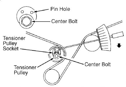

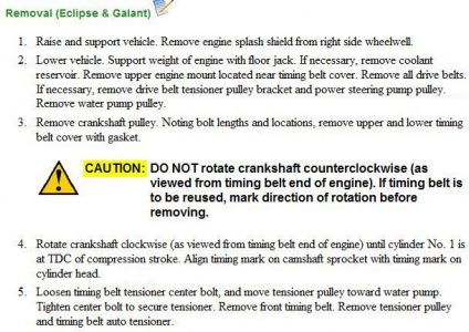

Installation (Eclipse & Galant) 1. Place auto-tensioner in soft-jawed vise to SLOWLY compress the push rod. If there is a plug at the base of the auto-tensioner body, place flat washer around plug so it will not contact vise jaw. 2. Slowly compress auto-tensioner push rod until holes in push rod and auto-tensioner housing are aligned. Insert a locking pin into the alignment holes. Install auto-tensioner on engine. 3. Ensure all timing marks are still aligned. See Fig. 2. Install timing belt on crankshaft sprocket, idler pulley, left bank camshaft sprocket, water pump pulley, right bank camshaft sprocket, and tensioner pulley. Take all slack out of timing belt. 4. Loosen the tensioner pulley center bolt. Using Tensioner Pulley Socket Wrench (MD998767), rotate tensioner pulley against timing belt. Temporarily tighten tensioner pulley center bolt. Using Crankshaft Pulley Spacer (MD998769), turn crankshaft 1/4 turn counterclockwise. Turn crankshaft 1/4 turn clockwise. Ensure all timing belt marks are still aligned. 5. For 1999-00 models, loosen tensioner pulley center bolt. Position tensioner pin holes at BOTTOM of tensioner. Install Tensioner Pulley Socket Wrench (MD998767) on tensioner pulley. See Fig. 6. Use a torque wrench to apply 39 INCH lbs. (4.4 N.m) of torque (counterclockwise direction) to tensioner pulley. Tighten tensioner center bolt to specification while holding tensioner stationary. See TORQUE SPECIFICATIONS. 6. For 2001 and later models, loosen tensioner pulley center bolt. Position tensioner pin holes at TOP of tensioner. Install Tensioner Pulley Socket Wrench (MD998767) on tensioner pulley. See Fig. 7. Use a torque wrench to apply 39 INCH lbs. (4.4 N.m) of torque (clockwise direction) to tensioner pulley. Tighten tensioner center bolt to specification while holding tensioner stationary. See TORQUE SPECIFICATIONS. 7. On all models, remove locking pin from auto-tensioner. Turn crankshaft 2 revolutions clockwise and align all timing marks. DO NOT rotate counterclockwise. 8. Wait for at least 5 minutes, then check auto-tensioner push rod protrusion. To check push rod protrusion, measure clearance between body of auto-tensioner and bottom of tensioner pulley bracket arm. Clearance should be 0.15-0.20" (3.8-5.0 mm). If protrusion is not correct, repeat timing belt tensioning procedure. 9. Install engine support bracket on engine block. Tighten top bolt first, then working in a counterclockwise direction, tighten the remaining bolts. See Fig. 8. Install timing belt covers. Install crankshaft pulley. Apply engine oil to crankshaft pulley bolt, then tighten bolt to specification. See TORQUE SPECIFICATIONS. 10. To install remaining components, reverse removal procedure. Adjust drive belts to proper tension. CAUTION: Never compress the auto-tensioner too fast, or the push rod will be damaged. WARNING: Right bank camshaft can turn easily due to applied spring force, so keep fingers out of the way.

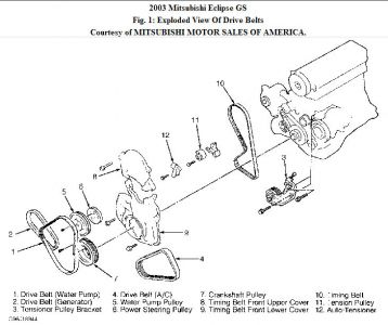

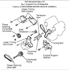

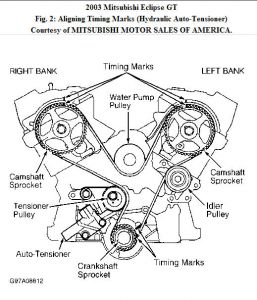

Here is an exploded view of timing. You as an experienced mechanic can do the job.
https://images.2carpros.com/forum/automotive_pictures/188069_03eclipsetiming_1.jpg
Here are the Timing Marks....
https://images.2carpros.com/forum/automotive_pictures/188069_03eclipsetimingmarks_1.jpg

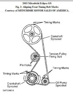

OOOPPPPPSSSS Here's for the 4 cylinder, Sorry bout that...
https://images.2carpros.com/forum/automotive_pictures/188069_034cyleclipstiming_1.jpg
https://images.2carpros.com/forum/automotive_pictures/188069_034cyleclipstimingmarks_1.jpg

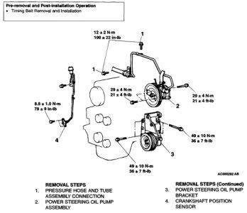

how do i remove the timing belt to replace the chrankshaft sensor
Jul 1, 2020 at 6:40 AM (Merged)
BLUELIGHTNIN6
  • 16,542 POSTS
Hello and thanks for donating Follow the steps below to remove the timing belt and access the crankshaft sensor.
https://images.2carpros.com/forum/automotive_pictures/261618_Noname_2467.jpg
https://images.2carpros.com/forum/automotive_pictures/261618_Noname2_807.jpg

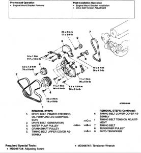

  • 75,988 POSTS
CPS
https://images.2carpros.com/forum/automotive_pictures/12900_cps_49.jpg
REMOVAL AND INSTALLATION REMOVAL SERVICE POINT <> TIMING BELT REMOVAL CAUTION: The crankshaft should always be turned in the forward direction only.
https://images.2carpros.com/forum/automotive_pictures/12900_t1_18.jpg
Turn the crankshaft in the forward direction (to the right) to align the camshaft sprocket timing marks.
https://images.2carpros.com/forum/automotive_pictures/12900_t2_3.gif
Loosen the tension pulley fixing bolt. CAUTION: If the timing belt is to be re-used, use chalk to mark (on its flat side) an arrow indicating the clockwise direction. Move the tension pulley to the water pump side, and then remove the timing belt. INSTALLATION SERVICE POINTS >>A<< AUTO-TENSIONER INSTALLATION
https://images.2carpros.com/forum/automotive_pictures/12900_t3_2.gif
Apply 98 - 196 N (22 - 44 pound) force to the pushrod of the auto-tensioner by pressing it against a metal object (such as the engine block) and measure the movement of the pushrod. Standard value: Within 1 mm (0.04 inch) A: Length when it is free (not pressed) B: Length when it is pressed A - B: Movement If it is outside the standard value, replace the auto-tensioner. CAUTION: Never compress the pushrod too fast, or it may be damaged.
https://images.2carpros.com/forum/automotive_pictures/12900_t4_1.gif
Use a press or vise to gently compress the auto-tensioner pushrod until pin hole A of the pushrod and pin hole B of the tensioner cylinder are aligned.
https://images.2carpros.com/forum/automotive_pictures/12900_t5_1.gif
When the holes are aligned, insert the set pin. NOTE: When replacing the auto-tensioner with a new part, the pin will be in the auto-tensioner. Install the auto-tensioner to the engine. >>B<< TIMING BELT INSTALLATION
https://images.2carpros.com/forum/automotive_pictures/12900_t6_1.gif
Align the timing marks on the camshaft sprocket, crankshaft sprocket and oil pump sprocket.
https://images.2carpros.com/forum/automotive_pictures/12900_t7_1.gif
After aligning the timing mark on the oil pump sprocket, remove the cylinder block plug and insert a Phillips(r) head 8 mm (0.3 inch) screwdriver. Check to be sure that the screwdriver goes in 60 mm (2.4 inches) or more. If the screwdriver will only go in 20 - 25 mm (0.8 - 1.0 inch) before striking the counterbalance shaft, turn the sprocket once, realign the timing marks and check that the screwdriver goes in 60 mm (2.4 inches) or more. The screwdriver should not be taken out until the timing belt is installed. CAUTION: the timing belt is re-used, install so that the arrow marked on it at time of removal is pointing in the clockwise direction. Install the belt to the crankshaft sprocket, oil pump sprocket and camshaft sprocket in that order, so that there is no slackness in the belt tension.
https://images.2carpros.com/forum/automotive_pictures/12900_t8_1.gif
Set the tension pulley so that the pin holes are at the bottom, press the tension pulley lightly against the timing belt, and then provisionally tighten the fixing bolt. Adjust the timing belt tension. >>C<< TIMING BELT TENSION ADJUSTMENT CAUTION: Do not use a spanner or the similar tool to turn special tool MD998738.. Otherwise, the auto-tensioner set pin may be broken. Turn special tool MD998738 by hand only.
https://images.2carpros.com/forum/automotive_pictures/12900_t9_1.gif
Remove the rubber plug from the rear of the timing belt cover assembly. Then screw in special tool MD998738 by hand until the tensioner arm is touching the auto-tensioner pushrod. After turning the crankshaft 1/4 of a revolution in the counterclockwise direction, turn it in the clockwise direction until the timing marks are aligned. CAUTION: When tightening the fixing bolt, make sure that the tension pulley does not turn with the bolt.
https://images.2carpros.com/forum/automotive_pictures/12900_t10_1.gif
Loosen the tension pulley fixing bolt, and then use special tool MD998767 and a torque wrench to tighten the fixing bolt to the specified torque while applying tension to the timing belt. Timing belt tension torque: 3.5 Nm (31 inch lbs.) Tightening torque: 48 ±6 Nm (36 ±4 ft. lbs.) Remove the set pin that has been inserted into the auto tensioner, and then remove special tool MD998767.
https://images.2carpros.com/forum/automotive_pictures/12900_t11_1.gif
Turn the crankshaft two revolutions clockwise so that the timing marks are aligned. After leaving it for 15 minutes, measure the amount of protrusion of the auto-tensioner. Standard value (A): 3.8 - 4.5 mm (0.15 - 0.18 inch) If the amount of protrusion is outside the standard value, repeat steps 1 through (5). Check again to be sure that the timing marks of each sprocket are aligned. https://www.2carpros.com/kpages/auto_repair_manuals_alldata.htm

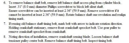

CWELLZ
I just changed the timing belt on car this weekend, when starting up, it now has a loud vibration and shakes. The engine light is on, I stopped and got codes, the codes were P0340 and P0421. Can you
help me?
Thanks,
Cheryl
MONTY STEPHENS
  • 79 POSTS
Well you know these cars have BALANCE shafts. It could be that or I've been told that if you get even one notch off on the timing belt, that it will cause all kinds of vibration in the motor.
Either way -- I think you have to go back in. Sorry about that.
P.S The MITS is considered one of the toughest to do car in the world.
