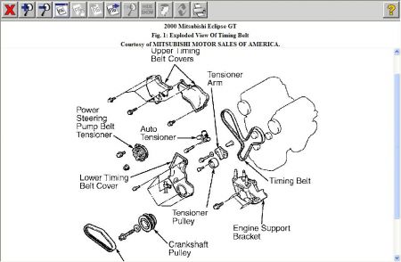

I recently posted a question about a broken timing belt and whether there woiuld be engine damage if just the pulley broke and not the belt itself. I took the car to Mitsubishi dealer where the timing belt, both pullleys, and gaskets were changed as preventative maintenance at 64000 miles. 5 days ago, the bolt that holds the pulley bracket broke (flush with the engine hole), the pulleyflew off, and then the belt came off (not broken, just off). Now mitsubishi is telling me that they did not remove the bracket when they replaced the pulley so it isn't their responsibility to fix. Is it true that a timing belt, both pulleys, and all the other labor intensive work can be done without loosening or removing the bolt that holds the tensioner pulley to the bracket?
Sep 5, 2008 at 9:29 AM
DOCFIXIT
  • 18,828 POSTS
Hi
The tensioner pulley bolt that holds auto adjuster to the block does not need to be removed. You loosen the bolt on pulley and rotate away. Also the idler pulley is not remove either. The repair was done 25K miles ago?
I would not hold them at fault.
This guide will help you do the timing belt replacement look toward the bottom of the page
https://www.2carpros.com/diagrams/mitsubishi/eclipse/2000
Sep 5, 2008 at 10:14 AM
KHLOW2008
  • 41,814 POSTS
Hi eclipsemls, Thank you for the donation. I am not clear which bracket your are refering to. Can you please indicate from diagram.
https://images.2carpros.com/forum/automotive_pictures/192750_TimingBeltMitsubishiV6_1.jpg
Anyway, such bolts should not break and it could have been a manufacturing defect, you can argue about it.

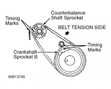

WVFLYINEAGLE
Engine Mechanical problem
1997 Mitsubishi Eclipse 4 cyl Two Wheel Drive Automatic 100K miles
trying to determine the timing marks for our 97 Eclipse Sypder GS, 2.4L auto.
Jun 1, 2020 at 2:27 PM (Merged)
DOCFIXIT
  • 18,828 POSTS
Make sure balance shaft is right on or car will Rock And Roll see diagrams
https://images.2carpros.com/forum/automotive_pictures/198357_Graphic_576.jpg
https://images.2carpros.com/forum/automotive_pictures/198357_Grafic_3_140.jpg

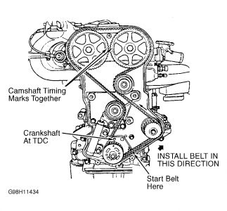

SOONEREVO
where should the dowel pins be pointing on the intake and exhaust cams, when installing some say intake up exhaust down. But confused
BLUELIGHTNIN6
  • 16,542 POSTS
https://images.2carpros.com/forum/automotive_pictures/261618_Graphic_722.jpg
https://images.2carpros.com/forum/automotive_pictures/261618_3_58.jpg

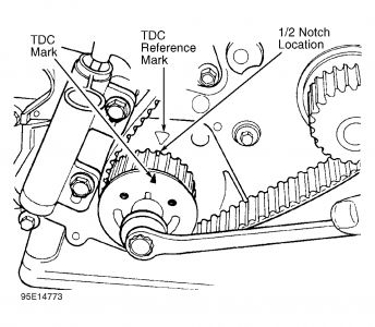

SETTERGREN
Noises problem
1996 Mitsubishi Eclipse 4 cyl Front Wheel Drive 167000 miles
There is a gurgaling noise coming from the timing belt area.So i took the inspection cover off and that is were the noise is coming from.Do the two pulleys have bearings maybe that could be it !!! When i bought it a month ago the guy i bought it from told me that he just replaced the timing belt.I'm starting to wonder if he really did !!! Please let me know what you think !!! Thank You !!
MAYNARDXSEBRING03
  • 18 POSTS
you need to replace the water pump with the timing belt. Saves labor because its in the same general area. If he didnt replace it then do it now.
I am sure your timing belt is fine. Make sure it is replaced every 60k- 70k miles or your gonna be junking the engine. If it doesnt get replaced at this time pistons shred and valves bend. If its time to change again do it, If you didnt replace the water pump then it may be time.

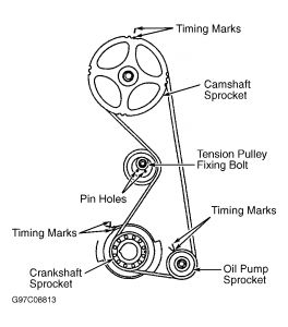

TTOMSAUTO
I replace my timing belt on my 1996 eclipse 2.0 but idle rough did I marks right
