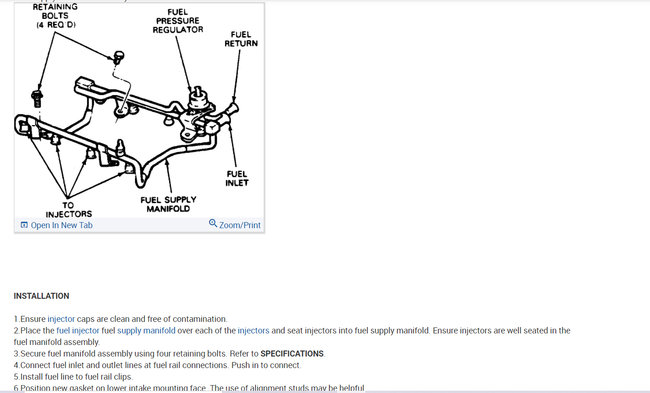

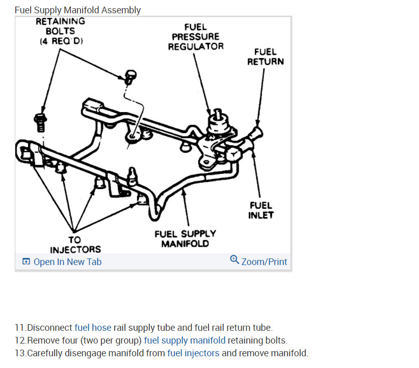

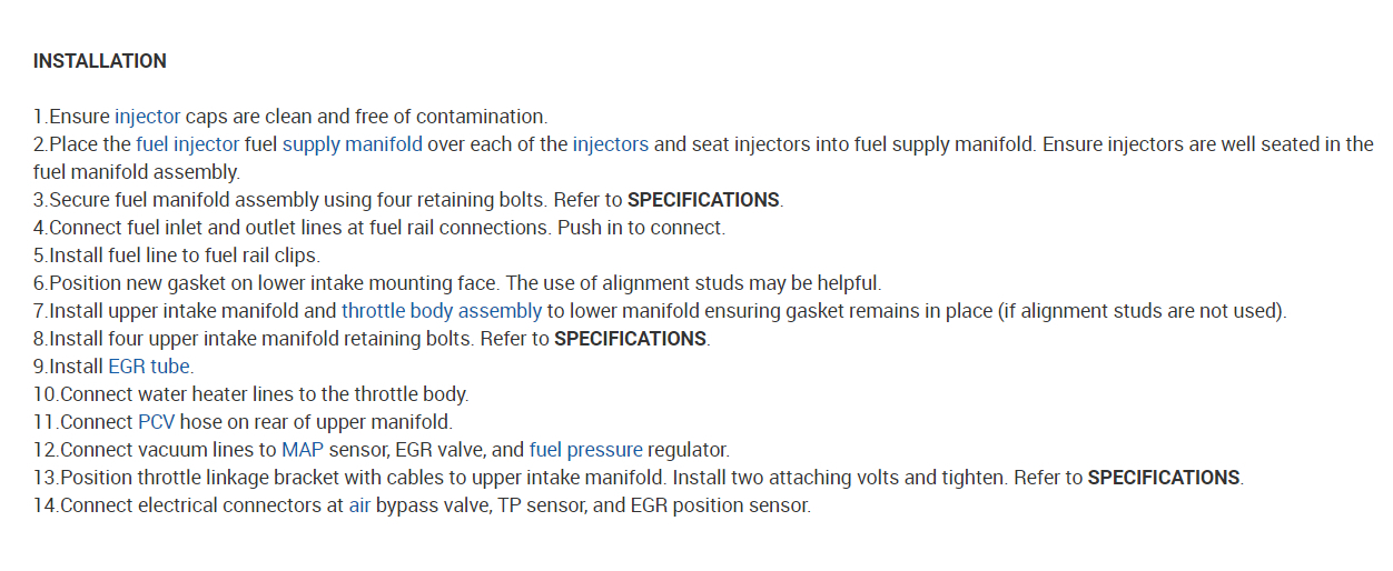

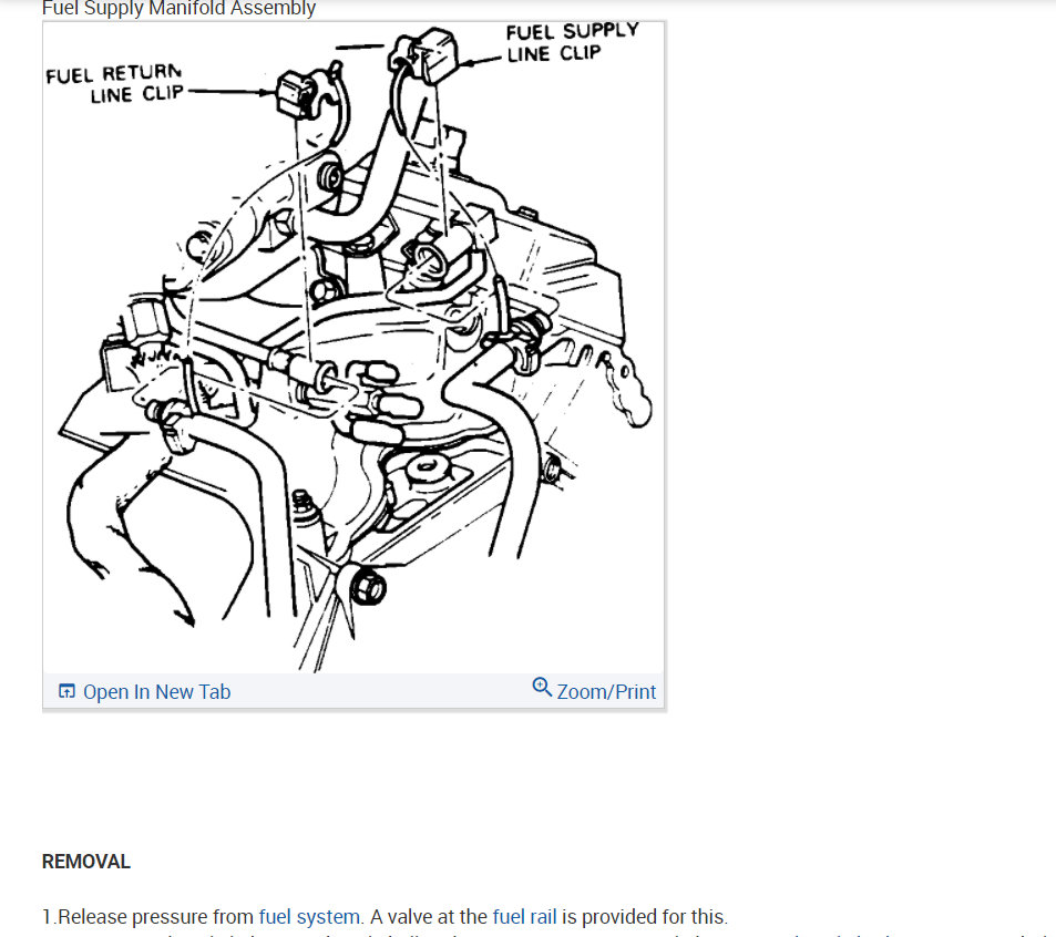

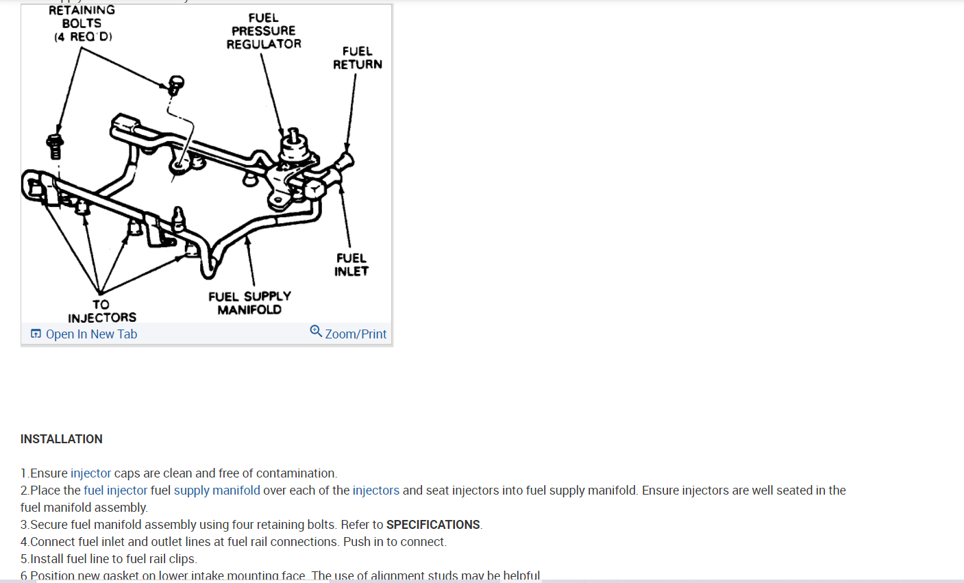

Good morning,
This could be from injectors that are are not flowing fuel or enough fuel into the engine from being clogged. There is no additive that will clean them. With the age of the truck, they may have to be replaced. I attached the procedure below for removing the fuel manifold for you.
https://www.2carpros.com/articles/how-to-replace-a-fuel-injector
https://www.2carpros.com/articles/how-to-test-a-fuel-injector

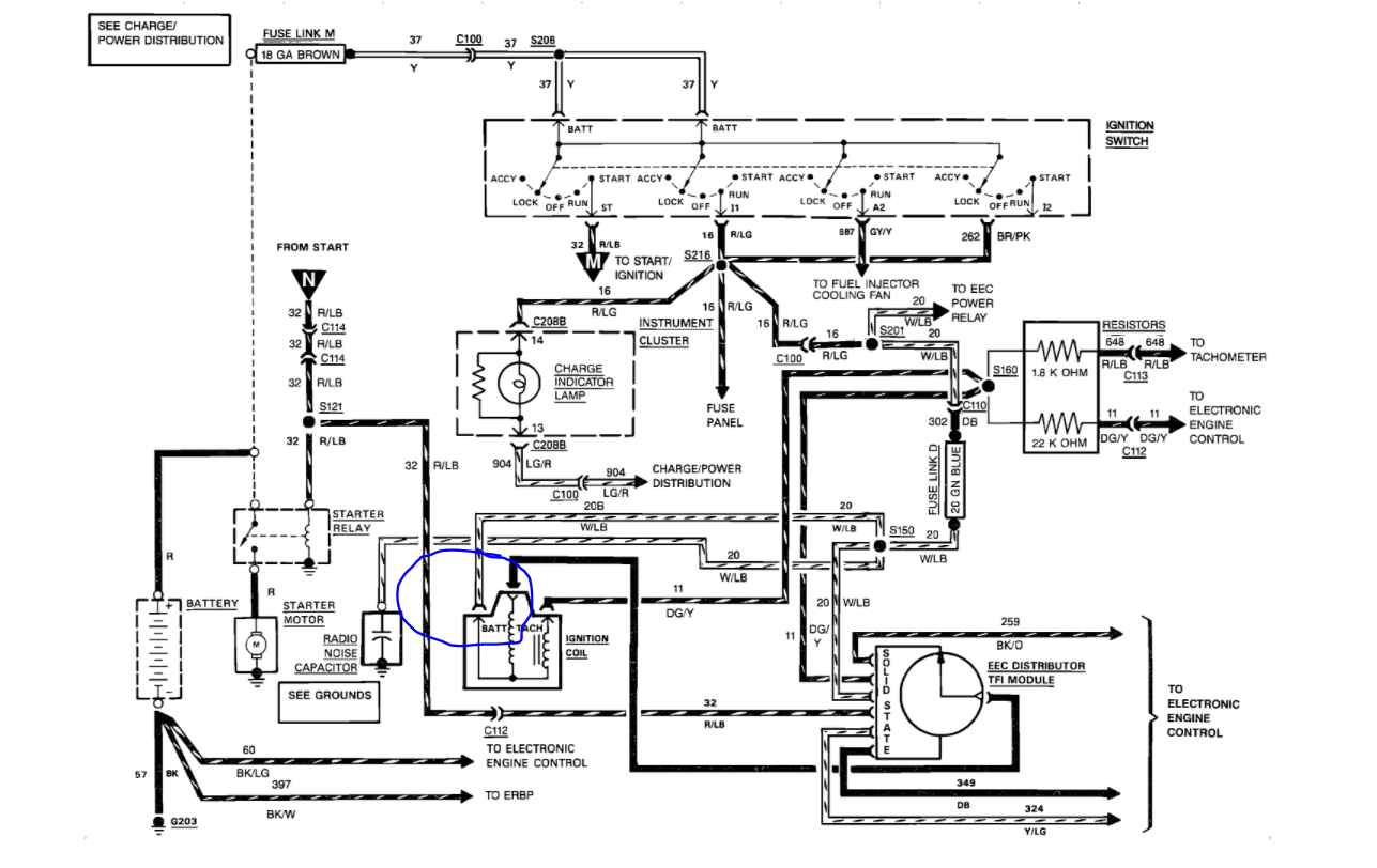

Also, I attached the wiring diagram for you as well for the ignition system. With the key in the on position, check the voltage at the positive side of the coil for battery voltage.

Good morning.I even put fuel in the card and it still does not start.I just got a brand new coil and still yet.i do not know what else to do.I pretty much put everything brand new; fuel pump, two of them, brand new distributor, brand new coil, and it does not want to run.even if I poor gas in the carburetor it wants to start but pop a little. I checked the fuel leader and it has a lot of pressure.
Apr 19, 2021 at 3:49 AM
Okay, did you verify voltage to the coil as I suggested in the previous post?
I would also check the compression to be sure the timing is correct. You should have 140 -160 pounds.

Let us cross one bridge at a time. I still need results on voltage checks to determine the reason for this not running.
Apr 20, 2021 at 7:29 AM
THOMAS808
  • 46 POSTS

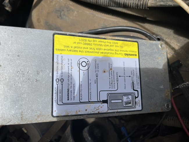

Hey buddy.thank you.don't have any power to none of it .so I'm waiting for get a new MSD then I can check the voltage like you ask. There is no power going into it at all the wire is dead goes to the coil it comes from the MSD ignition discharge box.
Apr 20, 2021 at 7:38 AM
It should come from the ignition switch to the MSD box. Did you verify this?
Apr 20, 2021 at 7:40 AM

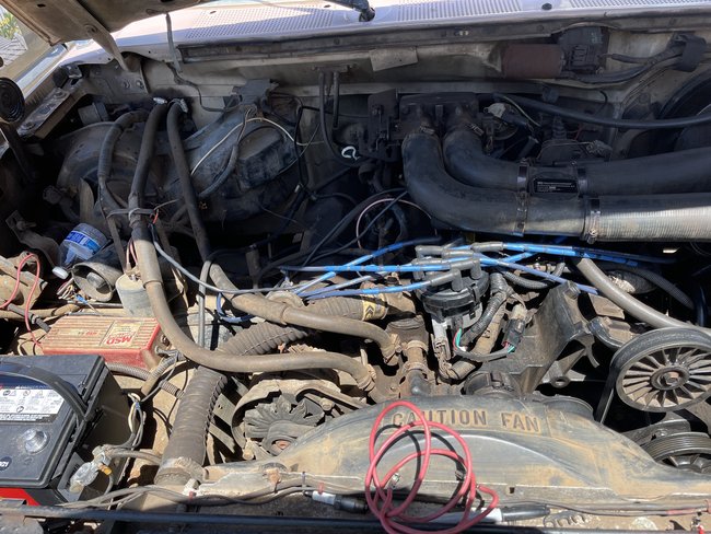

THOMAS808
  • 46 POSTS
I'll send you a picture when i crank the motor the power should have.but there is not.only get power on the the MSD no power coming out from the MSD.
Apr 20, 2021 at 7:45 AM
Okay, take a few and post them for me to see.
Apr 20, 2021 at 7:47 AM

THOMAS808
  • 46 POSTS
Okay, so what I did is bypass the msd box.so I'm back to square one.have power on coil and now it's back to wanna start .it's little popping so will see if get plan fuel.
Apr 20, 2021 at 8:24 AM
Use a test light on the negative side of the coil. While cranking, the test light should flash.
Apr 20, 2021 at 8:41 AM

Again, you are all over the place. Can you tell me if the test light flashes on the negative side with the engine cranking?
Apr 20, 2021 at 8:52 AM
THOMAS808
  • 46 POSTS
Yes it does.
Apr 20, 2021 at 8:54 AM
THOMAS808
  • 46 POSTS
This thing is slow responding.
Apr 20, 2021 at 8:55 AM
Okay, then the module and pick-up coil are good.
I have responded in minutes when you post.
The backfiring usually comes from the timing. Did you set the distributor on number 1 compression when you installed it?

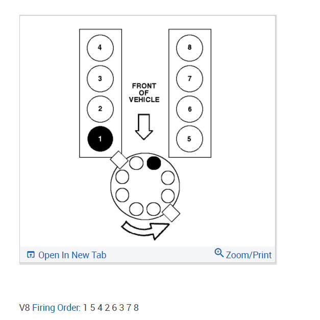

THOMAS808
  • 46 POSTS
Yes.I will keep trying an see what happens,.ther is 2 firing orders.
Apr 20, 2021 at 9:52 AM
THOMAS808
  • 46 POSTS
Can you please send me a link with the
Find order? so I can see if it's the same and with the distributor cap numbers and wires please.
Apr 20, 2021 at 10:01 AM
Only one for the 460. I posted it below.
The other firing order was for the 5.8 motors.
