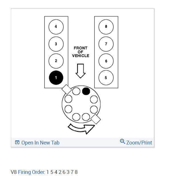

Is there one where I can follow the wires to the distributor cap and motor?
Apr 20, 2021 at 10:10 AM
The cylinders are numbered in the diagram I sent you. Just start at number 1 and go counterclockwise one at a time.
Apr 20, 2021 at 10:13 AM

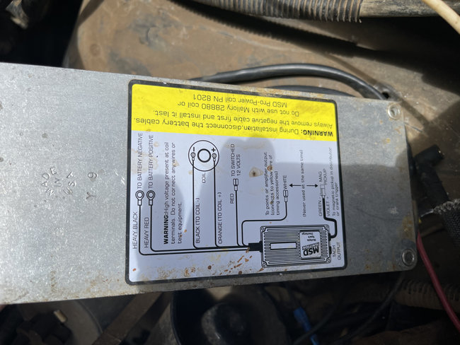

How was it Roy. Finally received the injectors. No the truck starts up it runs little while then shut off and don’t want to start again till the next day then it starts again runs then knock off and there is a lot of fuel pressure. I know that we disconnect the MSD box and we ran it straight to the coil so I wonder if it has to do with something there.
May 11, 2021 at 7:41 AM
Okay, the last picture from the previous post is it. Print the picture and use a pencil to fill in the numbers on top of the cap and then install the wires from the cap to the cylinder.
May 11, 2021 at 7:51 AM
