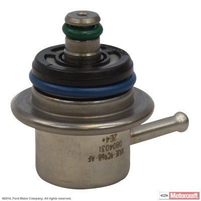

Engine skips, put new plugs, fuel pump, cam sensor, 02 sensors, checked coil packs. did not replace regulator built into fuel rail. where can i buy a fuel rail with a welded on regulator? thanks, Rick

I posted a picture of the fuel pressure regulator listed for that truck.How do you know it's the pressure regulator?Is the fuel pressure incorrect?

my regulator is welded to the fuel rail clean it all out put new plugs in blown a spark plug out of cyl since i cleaned rails reg have presser to the valve now.

So it's running good good now?

have to get old helicoil out to see have to new one in
