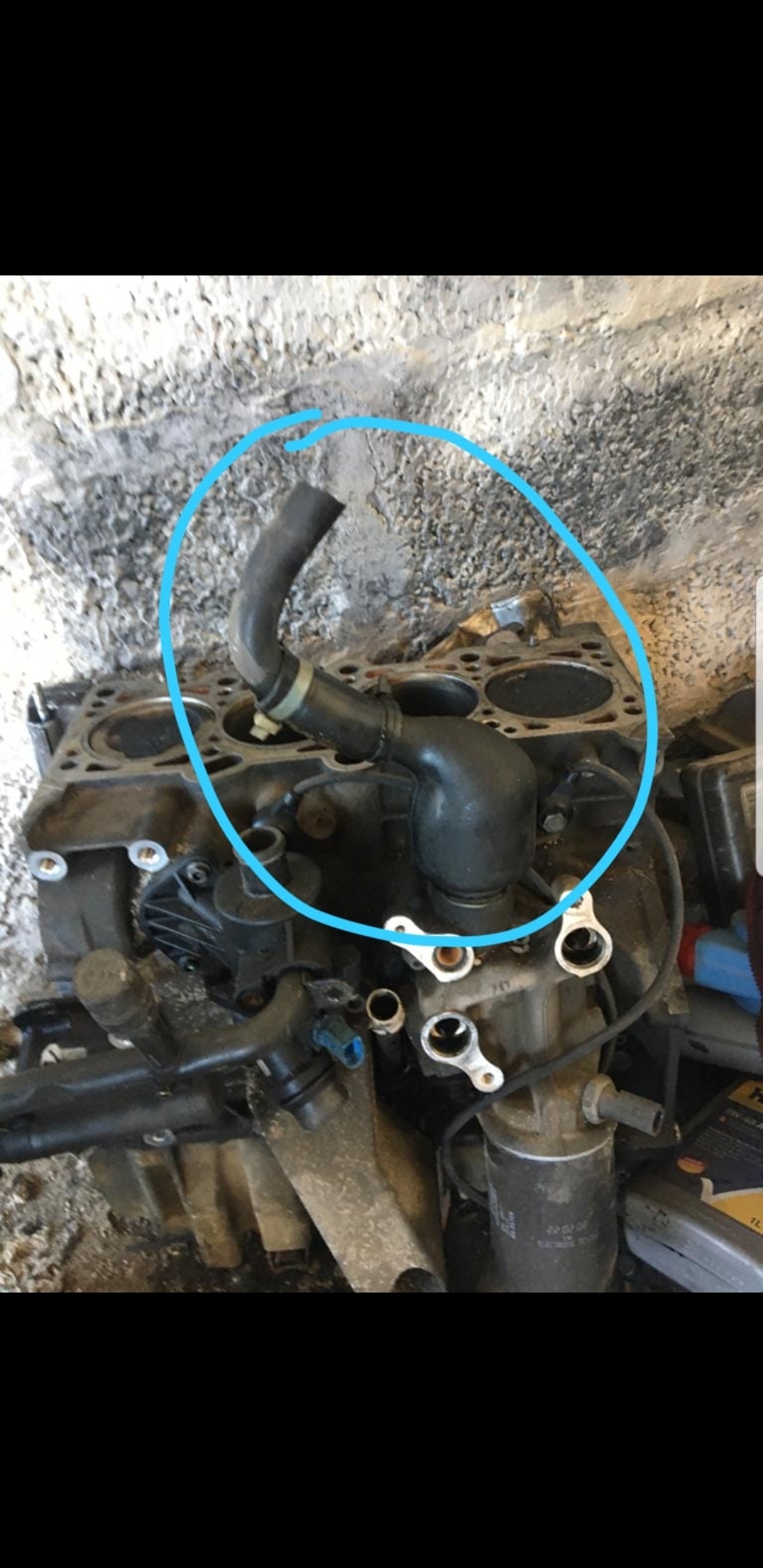

I just changed the PVC valve and I noticed this part broken and a lot of oil down engine, but didn't find any other leak around just this part that was broken and disconnected totally. Can you tell me if this has to do with the oil leaking?
Sunday, July 19th, 2020 AT 1:04 PM
VISI1100
  • 25 POSTS

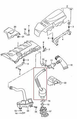

I didn't find any other part leaking but I found a lot of oil located under this part around ac alternator. Hope that problem is found but I am not sure. I will order this part too, but I am not sure for the function I don't know where is this connected was is number 17 on photo. Thank you bro.
Sunday, July 19th, 2020 AT 1:05 PM

I can't tell by the picture. Is it possible for you to get a picture of the part on the vehicle? Please keep in mind, this engine isn't offered in the US on this vehicle, so it may be tough for me to tell.

I have just this photo because the part is going under between engine and engine manifold. I am not sure but I think that part number is 06b103211h. I am not sure because I need to take out engine manifold to go under and see where this hose goes exactly. The only part that I can see is that the hose come from PVC that I changed and go down, but not sure where is connected.
Sunday, July 19th, 2020 AT 8:32 PM
VISI1100
  • 25 POSTS
I just was looking online and I think it goes to oil filter.
Sunday, July 19th, 2020 AT 8:35 PM
  • 109,885 POSTS
Because that is attached to the air inlet pipe, it has to be a breather for the engine. That is likely going to attach (or was attached) to the breather valve. It looks like the other end will need replaced because that is where it broke. It won't go to the oil filter.
Sunday, July 19th, 2020 AT 8:54 PM

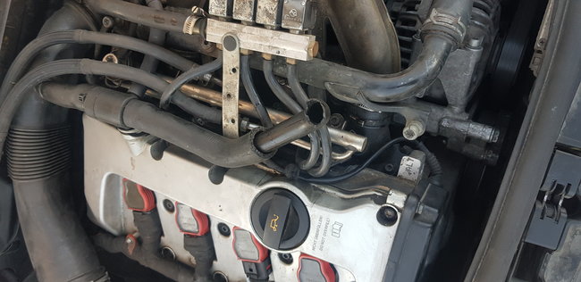

This is the connection on the engine:
Monday, July 20th, 2020 AT 12:06 PM
  • 109,885 POSTS
Yep. That is the breather. All you need to do is get a new one and replace it.

Does it have to do with all that oil that I found around? Or maybe with oil consumption problem that I had?
Because I am still looking for the oil that I found under engine but can't find any leaking place not how did it come out.
Monday, July 20th, 2020 AT 3:34 PM
  • 109,885 POSTS
The breather can allow oil to escape. Does it appear that is the area it is coming from? If so, chances are that is the cause.
