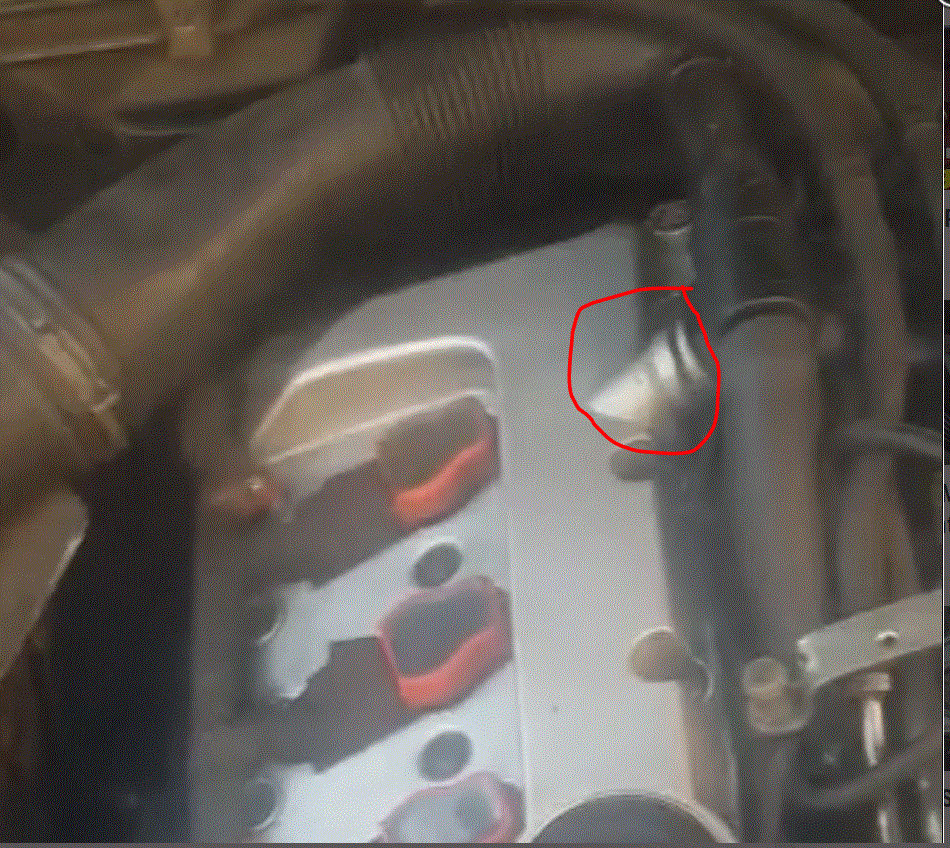

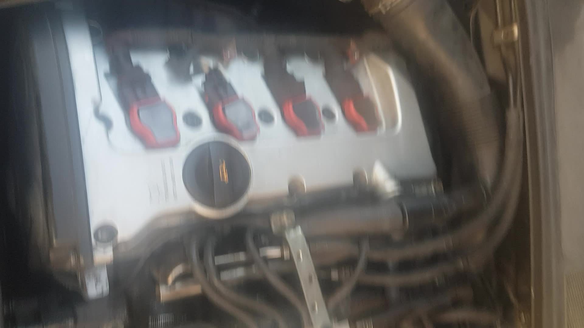

If you ask if air pressure coming out from oil cap when i remove it i think yes. here i am attacking a video of that prove.

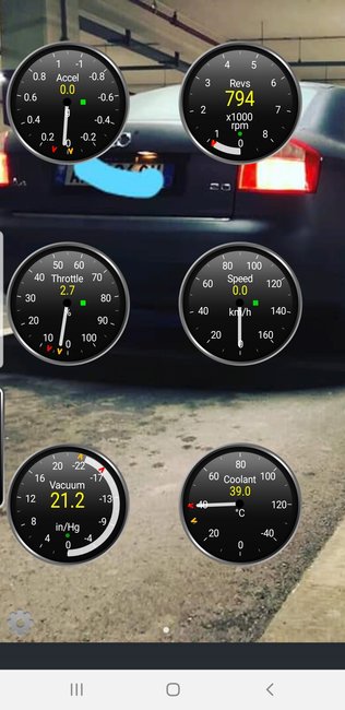

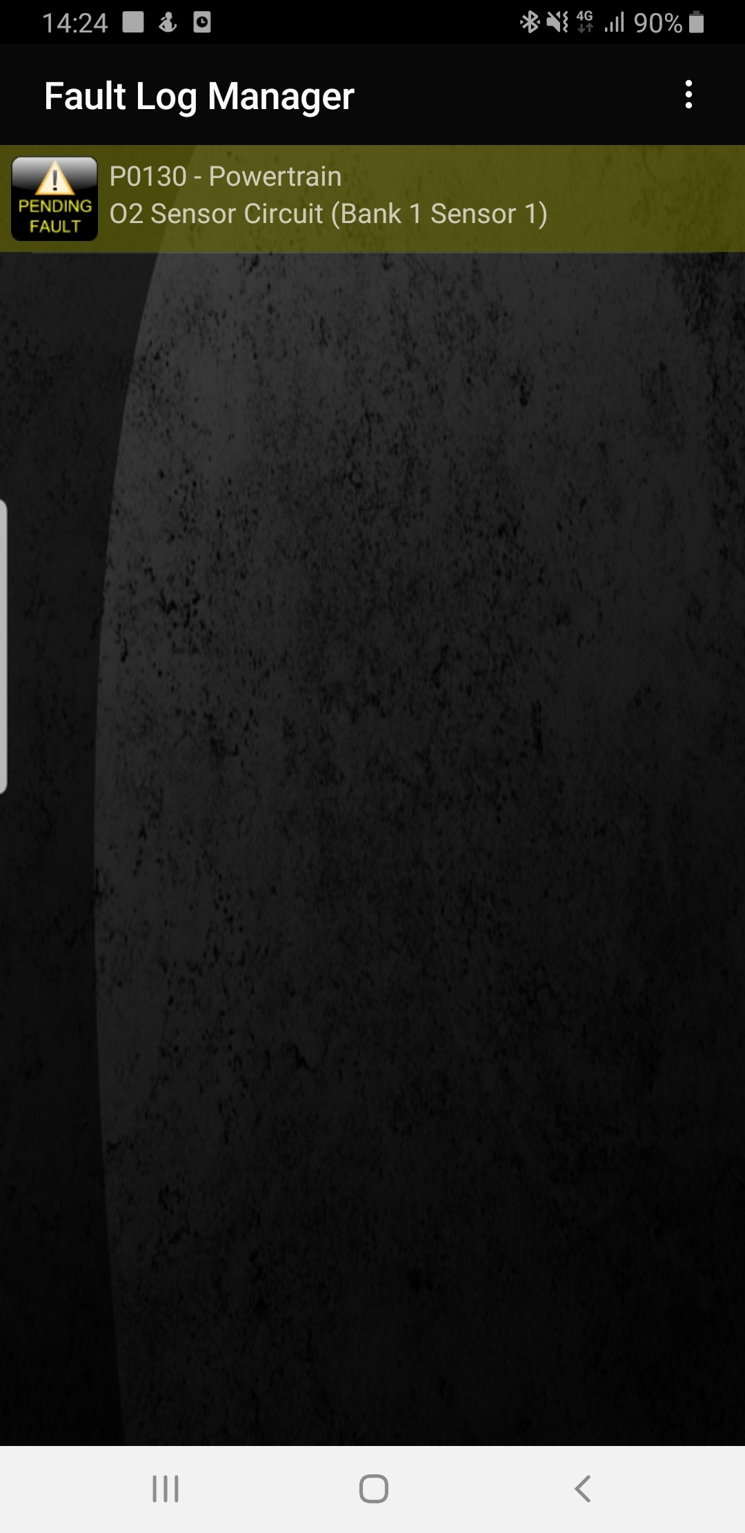

And today on OBD reader it say has a problem with o2 sensor bank1 but no check engine light and not sure if has to do with spark plugs cause i need to change all 4 spark plugs cause 1 of them does not work good it shake some time on parking position.
Noticed some coolant losing but maybe cause it work on high temperature cause like i have seen before and after changing the thermostat it work around 96 grad Celsius up to 102grad Celsius in city and around 85grad Celsius on highway and usually i drive in traffic.

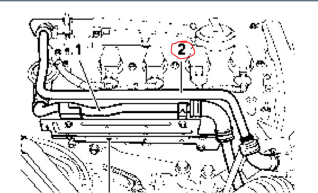

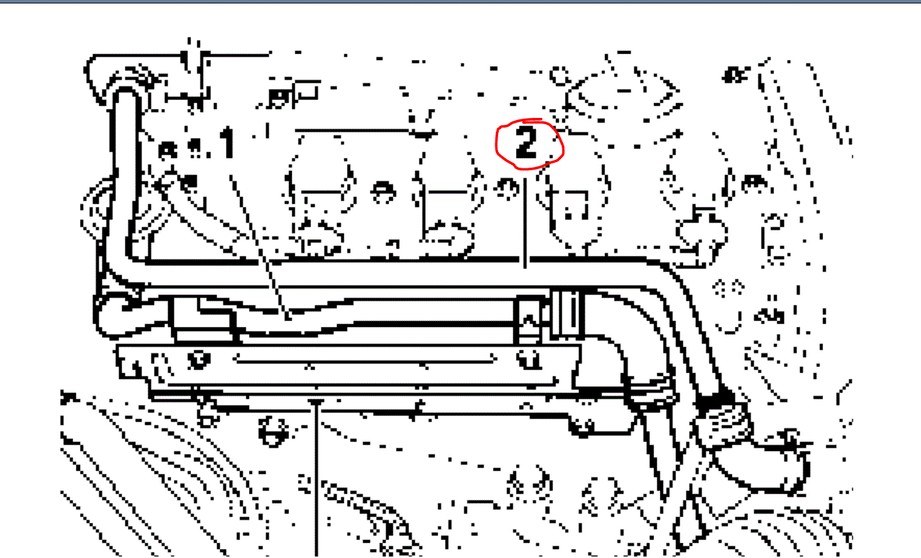

That looks like a good bit of pressure coming out. The crankcase breather (PCV) is mounted to the valve cover. I have attached a (poor) pic of the hose running to it. Check to make sure that is attached and not plugged. I copied a pic of what you sent me and circled where it attaches. See pic 2.

Here about o2 sensor code and other OBD data.
That air pressure from oil cap is a problem?
Jun 20, 2020 at 4:39 AM
  • 110,244 POSTS
The sensor issue is a circuit related problem. Chances are the wiring at the sensor plug is corroded, damaged, or loose. Check that.
As far s the air coming from the engine, some is normal. That seems excessive but I'm not there to confirm. Did you check the PCV (breather) to make sure it is not blocked?

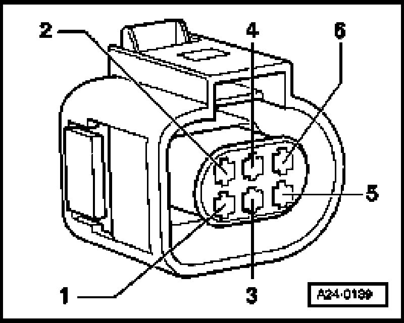

The breather allows crankcase air to exit the engine and be recycled through the intake. If there was a lot of oil in the hose, I think we found where the oil is going. It isn't uncommon for small amounts, but I have a feeling that oil vapors are getting sucked back through the intake a being burned without you even seeing it from the exhaust.
As far as the O2 sensor, it is a circuit related issue, so here is what to do.
If you look at the first pic I attached, the pin designation is indicated.
1) Connect multi-meter between terminal 1 and 5 for voltage measurement.
2) Switch ignition on.
3) Specified value: 0,400 ... 0.500 V.
If the aforementioned values are met, replace the sensor. If they are not met, check to make sure there isn't a damaged wire.

The o2 sensor connected positive to terminal 1 and negative to terminal 5 with ignition on show 0.48 and with ignition off it show 0.4.

The readings you have are within spec. According to the manual, the sensor needs replaced. As far as the PCV, try replacing it and see if it makes a difference.

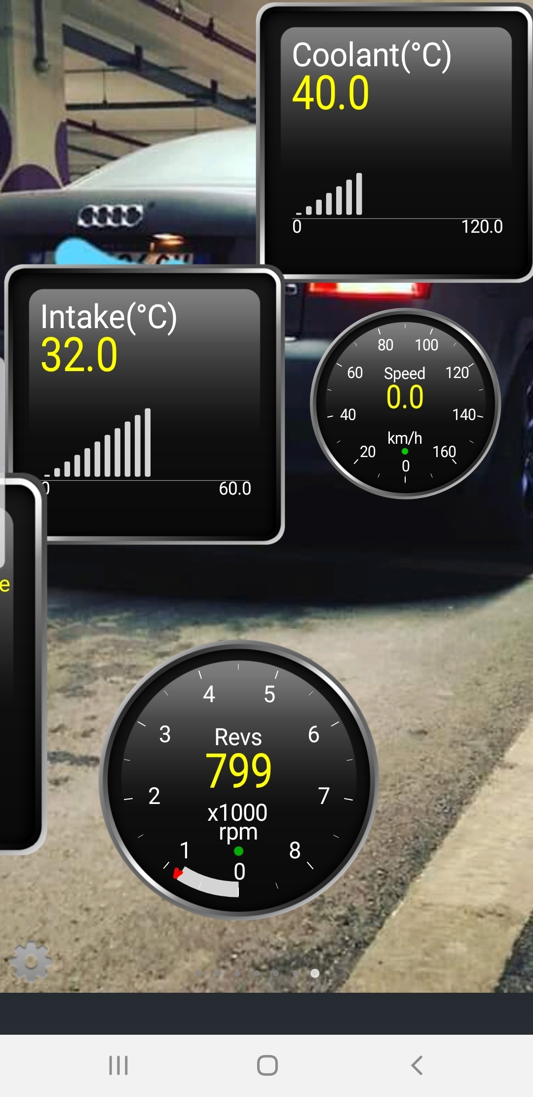

Thank you. i have order the PCV part on italy. i think after 1 week it will arrive but something isn't going well on my car those days . I usually use a OBD on my car just to see the temperature because on this model if temperature is between 78 grad Celsius and 109 grad Celsius the gauge on car show 90 grad Celsius so for security i use this OBD to read in real time via phone while i drive. But today i noticed something that i really don't know why .

The coolant deposit was empty but the temperature never changed from 84 up to 90 grad Celsius even that i have driven all day around a city with high traffic.
Jul 8, 2020 at 12:49 AM
  • 110,244 POSTS
Is there any evidence of coolant leaking? Is there any white smoke from the exhaust?

Okay, as long as the radiator was still full of coolant, it won't overheat. The reservoir is more or less a holding point and inspection point.

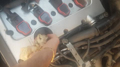

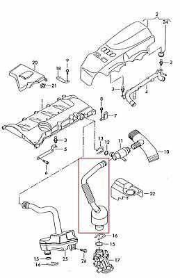

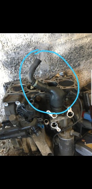

I just changed the PVC valve and i noticed this part broken and a lot of oil down engine, but didn't find any other leak around just this part that was broken and disconnected totally . Can you tell me if this has to do with the oil leaking?
Jul 19, 2020 at 6:04 AM
VISI1100
  • 25 POSTS
I didn't find any other part leaking but i found a lot of oil located under this part around ac alternator . Hope that problem is found but i am not sure. i will order this part too, but i am not sure for the function i don't know where is this connected was is number 17 on photo .thank you bro.
Jul 19, 2020 at 6:05 AM
  • 110,244 POSTS
I can't tell by the picture. Is it possible for you to get a picture of the part on the vehicle? Please keep in mind, this engine isn't offered in the US on this vehicle, so it may be tough for me to tell.

I have just this photo because the part is going under between engine and engine manifold. I am not sure but i think that part number is 06b103211h. i am not sure because i need to take out engine manifold to go under and see where this hose goes exactly. the only part that i can see is that the hose come from PVC that i changed and go down, but not sure where is connected.
Jul 19, 2020 at 1:32 PM
VISI1100
  • 25 POSTS
I just was looking online and i think it goes to oil filter.
Jul 19, 2020 at 1:35 PM
  • 110,244 POSTS
Because that is attached to the air inlet pipe, it has to be a breather for the engine. That is likely going to attach (or was attached) to the breather valve. It looks like the other end will need replaced because that is where it broke. It won't go to the oil filter.

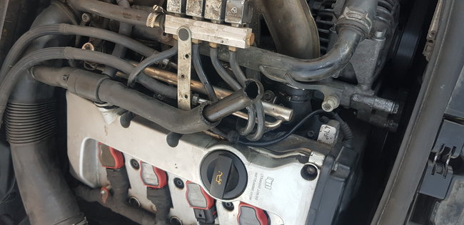

VISI1100
  • 25 POSTS
This is the connection on the engine:
Jul 20, 2020 at 5:06 AM
  • 110,244 POSTS
Yep. That is the breather. All you need to do is get a new one and replace it.
