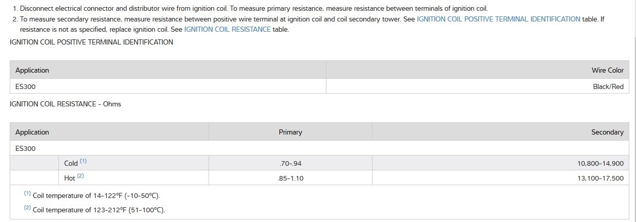

So I tried to get a refund on the igniter from ebay said no which sucks. He first said that it might be my coil packs making the igniter go out? I omh'd out the front 3 coils and hot they where at 1.0? Is this the range they need to be in? Can send me specs or how I would diagnose that? Much appreciated.

Here's what Lexus says about resistance. You're within the hot specs.

Thanks the front 3 are good then. Need to check the back 3.
