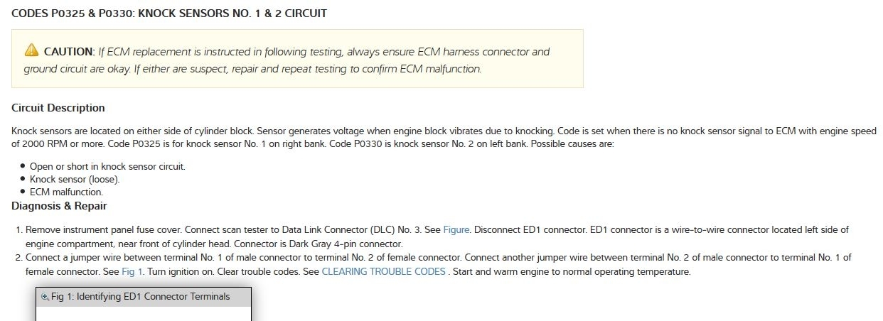

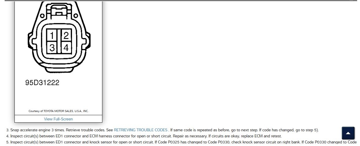

I pulled the codes on the car. It ended being knock sensors banks 1 and 2.
Mar 2, 2018 at 4:00 PM
SETEFANOD
  • 25 POSTS
Codes p0325 and p0330.
HARRY P
  • 2,292 POSTS

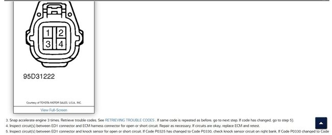

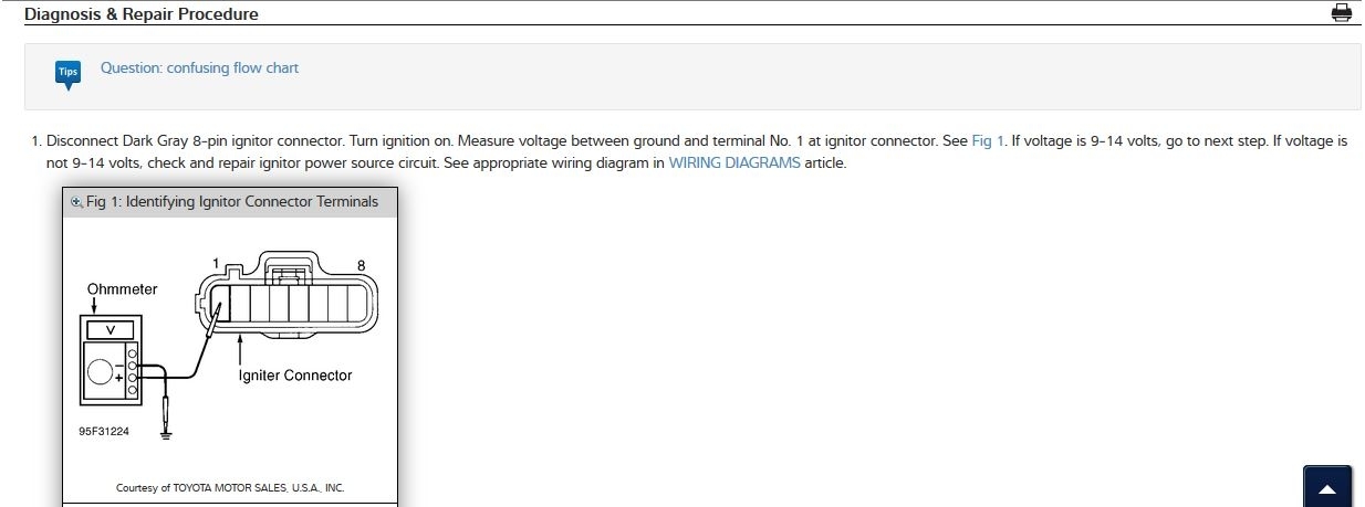

Nice! Since you have codes for both of them. I would run the following simple diagnostic procedure before replacing anything. It is rather unlikely that both sensors went bad at the same time. The procedure is in the attached images. Let us know what you get.

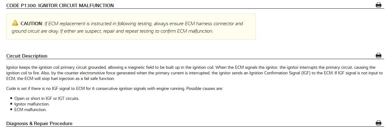

So i let the car idle until it shut off by itself. It took like one hour and thirty minutes to shut off. But the code thrown is now a p1300 igniter.

Sounds like the igniter is getting hot and then quitting when it is hot. Leave the car off for a while and I would bet it will fire right up again. If you still have the new/refurbished igniter, stick it back in there and see what happens.

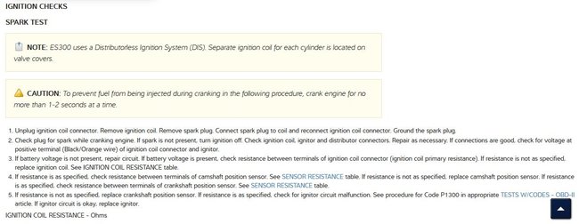

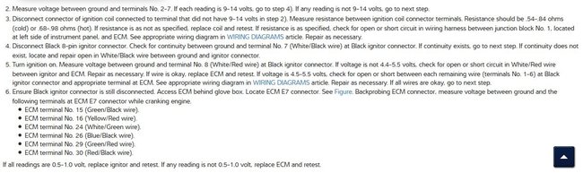

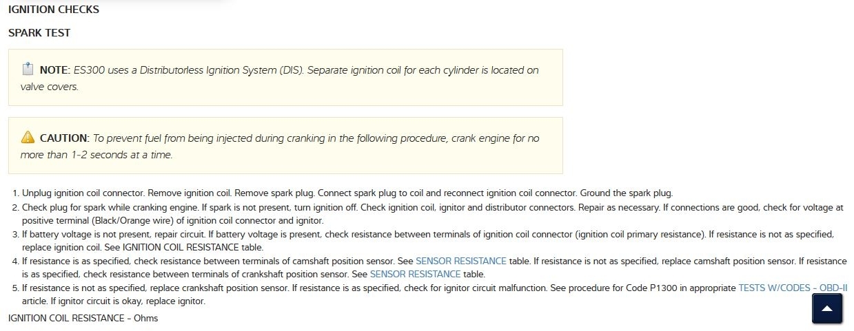

According to Toyota, testing for a bad igniter is done by checking for sparks. Here is the test that they suggest, attached in the images.
Go ahead and run that test. Personally, I suspect a problem with the ECM, as detailed in the knock sensor tests that I posted earlier. But it is possible that you just got a dud of an igniter too.

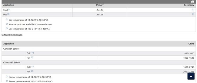

Heyman i know its been a while. I currently still have fixed the lexus. Thought it was computer then took it out look new no burnt spots or leaking capacitors. Put it back in started up fine ran for 10 minutes dies at gfas station lettingnit set i t est power on igniter otrs getting 12 volts all the other side is getting 12 volts. The front 3 coils are getting 12 volts. The front 3 coil packs all ohm out the same. I went to camshafts sensor in front unplug and there is oil in the plug try to ohm it out and wouldnt read nothing no continuity. Plug it backin start up car runs its running as we speak. Should i get new crankshaft sensor?

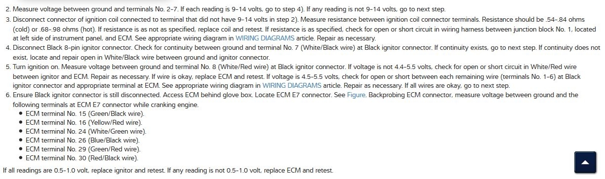

Ok I retraced my work and did some more digging in Prodemand. Basically, it tells me that the igniter is the problem. However, there's a test if you're ready to dig in a little more. This will tell us if it's an ECM problem, or an igniter problem. Personally, I think it's in the igniters because you get different behaviors with each one.

So i test the igniter on the incoming and outgoing terminals all have 12v and then went to camshaft sensor unplugged terminal and it had oil all in it. So i cleaned and reinstalled and car ran. But got home wouldnt start again. Then checked the camshaft sensor again and full of oil again i order a new one today should have it by monday. Will update you after install and testing. Took out computer amd looked everyhthing look cherry.

Get a spark tester and when it's not starting, check for sparks on all cylinders. Here's the tester that I use: https://www.amazon.com/Lisle-20610-Inline-Spark-Tester/dp/B0002STSC6/ref=sr_1_3?ie=UTF8&qid=1501325755&sr=8-3&keywords=spark+tester
I know we're kind of stepping back here, but sometimes it's best to retrace your steps to see what was missed. Because clearly, we're missing something.
Mar 26, 2018 at 12:41 PM
SETEFANOD
  • 25 POSTS
I just came out tried to start it with the igniter that was in it was hot to touch put old igniter back in that was cool setting inside my house for days. It fired right up. Is it safe to say its the igniter.

Personally, I'm betting on the igniter being the problem. That's where I was going to go with having you recheck for sparks. No sparks would almost ensure a failed igniter.

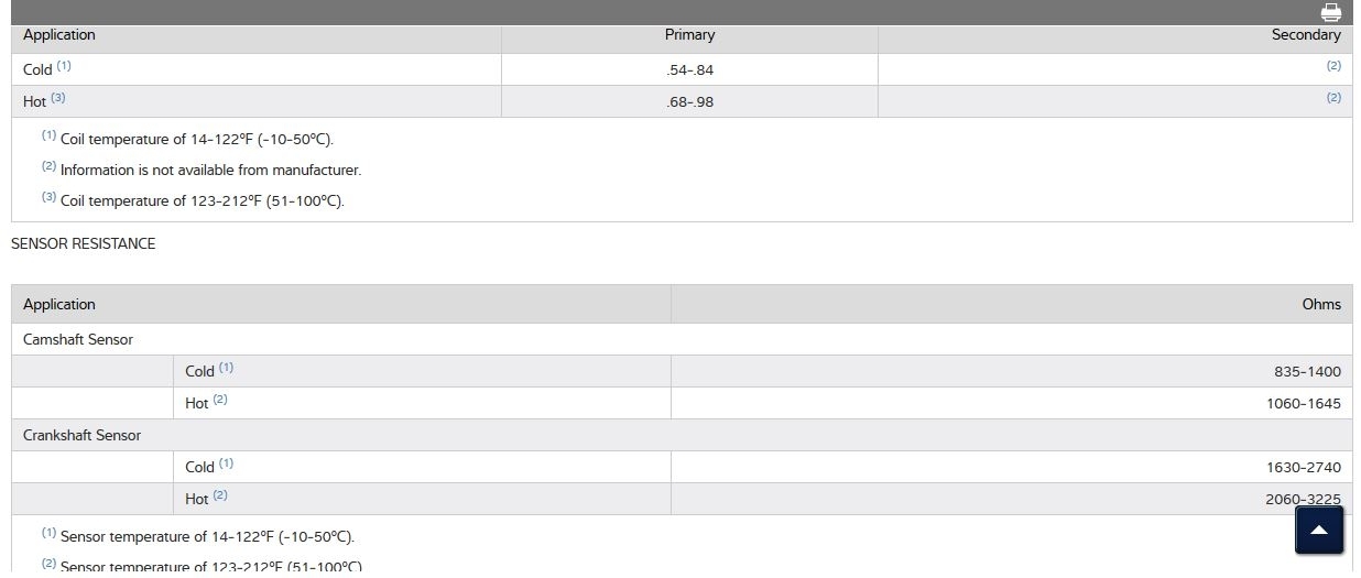

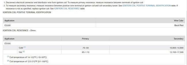

So i tried to get a refund on the igniter from ebay said no which sucks. He first said that it might be my coil packs making the igniter go out? I omh'd out the front 3 coils and hot they where at 1.0? Is this the range they need to be in? Can send me specs or how i would diagnose that? Much appreciated.
Mar 28, 2018 at 6:40 AM
HARRY P
  • 2,292 POSTS
Here's what Lexus says about resistance. You're within the hot specs.

Thanks the front 3 are good then. Need to check the back 3.
