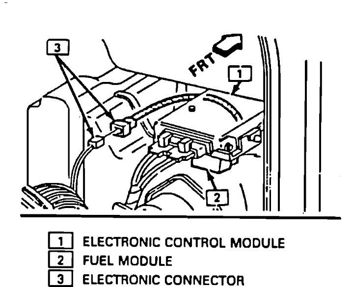

Feb 24, 2018 at 7:41 AM
ecm is behind the glove box
before 96 it is an ecm. after 96 it is a pcm
Feb 24, 2018 at 7:43 AM
ERIC HOWARD
  • 74 POSTS
Copy that, can it b rest reflashed ect or with what I have for the problem it’s a change
Feb 24, 2018 at 8:00 AM
ERIC HOWARD
  • 74 POSTS

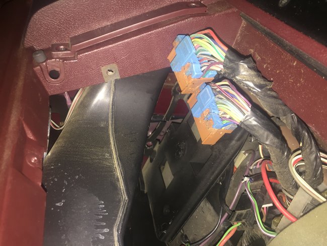

WOW looks like a parshal dash removal
Feb 24, 2018 at 8:25 AM
nope, comes down very easily. it comes down after removing a couple of bolts. it is a plug and play. just have to change the prom.
Feb 24, 2018 at 8:33 AM
ERIC HOWARD
  • 74 POSTS
It’s righr n front of me but don’t see any bolts to remove
Feb 24, 2018 at 8:35 AM
ERIC HOWARD
  • 74 POSTS
NO bolts it slides in onto a tray, I guess before I chase this rabbit I want to make sure this is a good fix
Feb 24, 2018 at 8:40 AM
it comes down to the floor. try pulling it down
REMOVAL:
1. Disconnect the negative battery terminal.
2. Remove glove box panel.
3. Remove mounting brackets and/or retainers.
4. Remove control module from tray.
5. Disconnect control module harness connectors.
6. Remove access cover and PROM (MEM-CAL).
Feb 24, 2018 at 8:44 AM
ERIC HOWARD
  • 74 POSTS
Here’s the tray
Feb 24, 2018 at 8:49 AM
