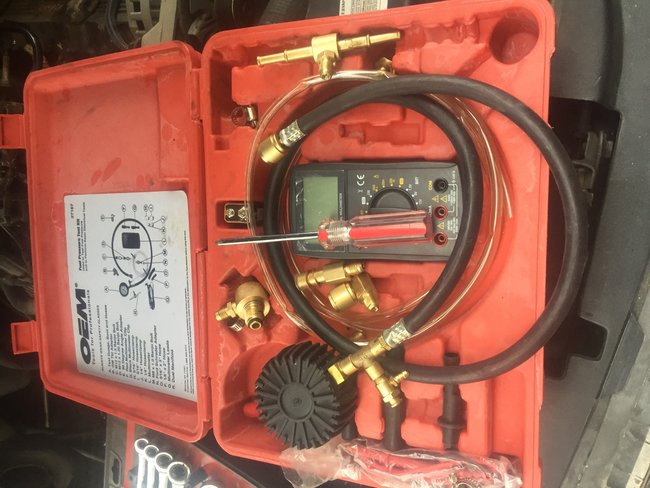

truck runs for about ten minutes in then turns off, like you turned off the key then will not restart. changed out ignition control module, started after putting fuel in carburetor and ran looked as if it was running rich. It threw a code of 42. after shutdown will not start back up and now when I crank and then turn key just to off the coil continues to fire. I am lost bad on this on.

Cannot hook it up, steal line in the back does not have a enough room to put in port.
Feb 18, 2018 at 4:53 AM
ERIC HOWARD
  • 74 POSTS
Not enough adapters in the kit to put it in like in place of the filter.
Feb 18, 2018 at 4:54 AM

Does not have a T fitting in the kit??
Feb 18, 2018 at 5:08 AM
ERIC HOWARD
  • 74 POSTS
It does.
Feb 18, 2018 at 5:26 AM
ERIC HOWARD
  • 74 POSTS
Friends of mine as a bigger kit I will get from him tomorrow, it may have in like fitting to put in place of the fuel filter, be way easier then trying to make this work. last thing I want to do is kink a like or mess up threads on throttle body.

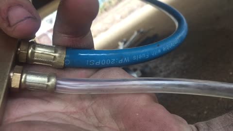

Now if I can get one side of the throttle body plumbed in with tester how good of a test would it be only burning on one injector?
Feb 18, 2018 at 5:34 AM
ERIC HOWARD
  • 74 POSTS
Still no good, only thing is I cannot and maybe check the pressure at the pump if I disconnect fuel filter, but that would be the only way this kit will work if it will?
Feb 18, 2018 at 5:36 AM
ERIC HOWARD
  • 74 POSTS
Nope!! This kit will not do it, more to follow tomorrow.

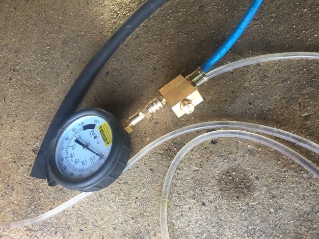

At first then gauge jumped up to around ten the I sprung a leak so took all off and get everything sealed back up now zero on the gauge, but the truck runs still for about five minutes or so then shuts off. I can fire it right back up but still zero on the gauge. Fuel pump is the problem I am thinking.
Feb 19, 2018 at 6:51 AM
ERIC HOWARD
  • 74 POSTS
Now if I take gauge off as the truck runs and bleed the line it will stall then shut off.
Feb 19, 2018 at 6:52 AM
ERIC HOWARD
  • 74 POSTS
Something sure not right though, if I disconnect everything and let it free flow with the pump on it will sling some fuel. now it does not look like it under a lot of pressure but it does come out .
Feb 19, 2018 at 6:54 AM
Okay, the pump can work but not supply enough pressure for the system to work.
it sounds like you need a pump.

If you look closer at the clear line the bleed off
line , I am holding the JR button down and see how fast the pressure Ian bleeding off it should really really really slow so either my
like is plugs some way or the fuel pump is putting out less then 10 PSI.
Feb 19, 2018 at 7:01 AM
Nice video. yes I still think you have a failing pump. not enough fuel.
Feb 19, 2018 at 7:07 AM
ERIC HOWARD
  • 74 POSTS
Nope! Bypassed the filter and has around twelve pounds steady, went inside showered and came out all along the truck was running so I’m going to change the filter Tomorrow.

Changed fuel filter started up ran for one to two minutes, plumbed around the filter and Poured fuel in throttle body two times to get it started and as I was checking again for fire which I still have it fired up and ran for about five minutes. My thought at this point is the fuel filter is putting just enough load on an older pump and it is to the point that it cannot keep up. Thoughts? As soon as I turn the key on am I supposed to get fuel at injectors in throttle body?
Feb 20, 2018 at 6:27 AM
That is what I was saying before. it definitely looks like a pump failing.
Feb 20, 2018 at 6:31 AM
ERIC HOWARD
  • 74 POSTS
Not sure how it is the real mechanic world, but I had to start somewhat conservative, lol. Thanks Roy for your help. I will definitely be back in this website.
Feb 20, 2018 at 6:38 AM
ERIC HOWARD
  • 74 POSTS
Now, so do I change the pump or the assembly?
Feb 20, 2018 at 6:40 AM
Just the pump. Get an AC/Delco pump.
