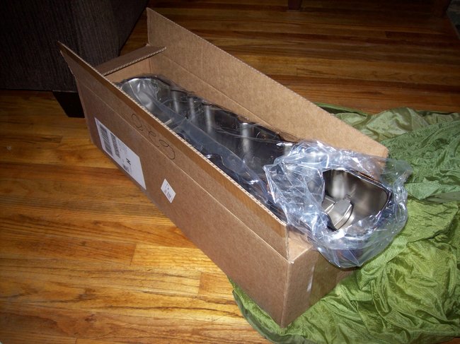

"LOOKY HERE" was 'spota be these 2 pics
The Medic
Friday, May 12th, 2017 AT 8:51 PM
CJA31186
  • 89 POSTS

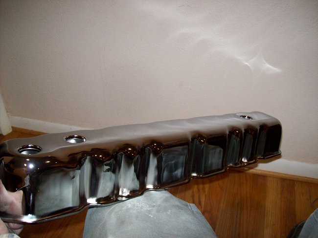

Nice valve cover!
Friday, May 12th, 2017 AT 8:52 PM

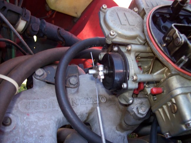

CJ MEDEVAC
  • 11,004 POSTS
Yes,
Fresh air from breather to rear valve cover hole. Like mine in a pic or two back.
Ain't my new $26 cover perty!

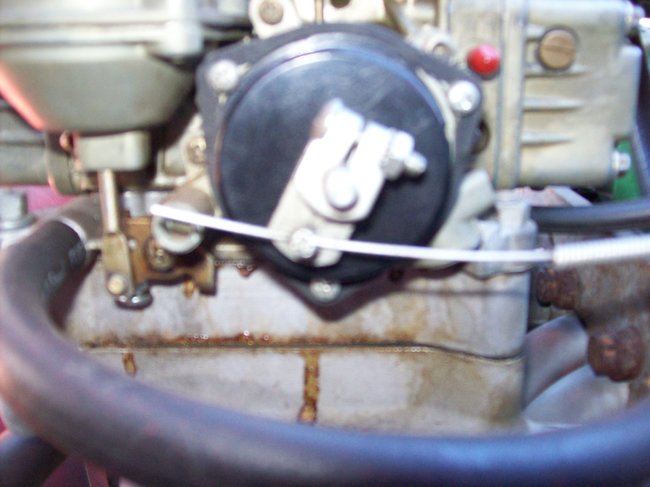

Ok I got the '79 carb installed. I have a the distributor vacuum going where you told me and the pcv going to the location you told me as well. All other ports capped. Charcoal canister is unhooked with the hose from the roll over check valve waiting to get a fuel filter on it. Two other breather hoses from carb are also waiting for the filter. There was a hose coming from the egr valve to the air filter that I removed and capped EGR valve port. Also the brake booster runs to a port on the manifold. That port had another t1t with hose coming out that I didn't even know where it should have been hooked up. I removed that and capped it too. Only brake booster is going into that now. Can I now remove all of these other hoses that are no longer part of the system? A lot of them have wires hooked into them through connection pieces that can easily be unhooked. Just didn't know if I could unhook them yet or not. Now that this is done what is next?

Lets look thru the air cleaner snout. Is it wide open thru there? No little doors closed that would block air from getting to the carb?
Let's leave the hoses on the air cleaner for the time being (just not hooked to any vacuum)
EGR is not needed (If you had headers, it would not work with them. Hence it is not a necessary part) You done good taking the line off of it! Just for info, if you took the whole unit off, you would have to make some modifications to plug it's holes off. As it sits (hopefully fully closed) It will be just fine.
Yes, all unused carb and intake vacuum ports should be capped. Do what you wish with the ports they used to operate, they don't suck air, capping might look nicer and also keep those "know it alls" from pointing out a naked port/ but it really is unnecessary to cap 'em.
Everything dangling can be taken loose and the wires can be rolled up out of the way (if it makes things look prettier, take those pesky wires out of the wire looms so they will roll up smaller. Insure none of that stuff will Rub Raw on something or get melted on the engine or exhaust manifold.

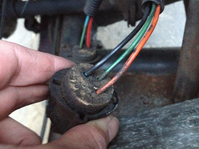

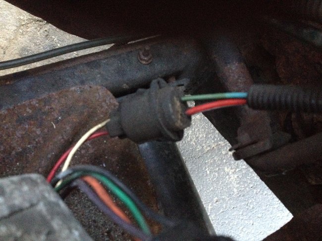

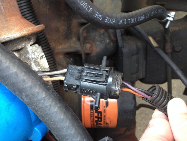

CJA31186
  • 89 POSTS

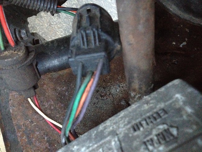

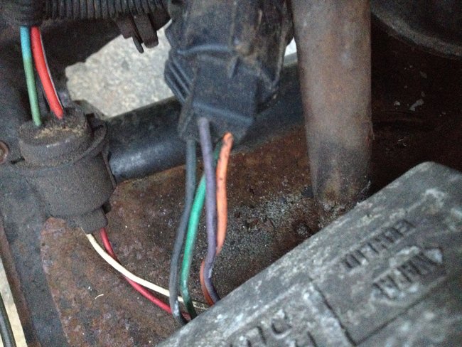

Yes looking better under the hood. I will just remove all of those old vacuum actuators and hoses that are now unused, along with unplugging those wires and removing them from the looms. I also noticed two sensors on carb side near the manifold. Im guessing I dont need those either? They attach similar to the way the temperature sending unit wire attaches near the valve cover towards the fire wall on the block. Ok, how do we start tuning this new carb and setup?
Sunday, May 14th, 2017 AT 8:10 PM
CJA31186
  • 89 POSTS
Or how do I go about disconnecting the computer and adjusting the ignition module? Im thinking that would come before tuning?

CJ MEDEVAC
  • 11,004 POSTS

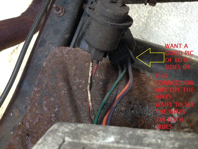

Need a good pic/ gotta see the wires
See pic below

CJ MEDEVAC
  • 11,004 POSTS

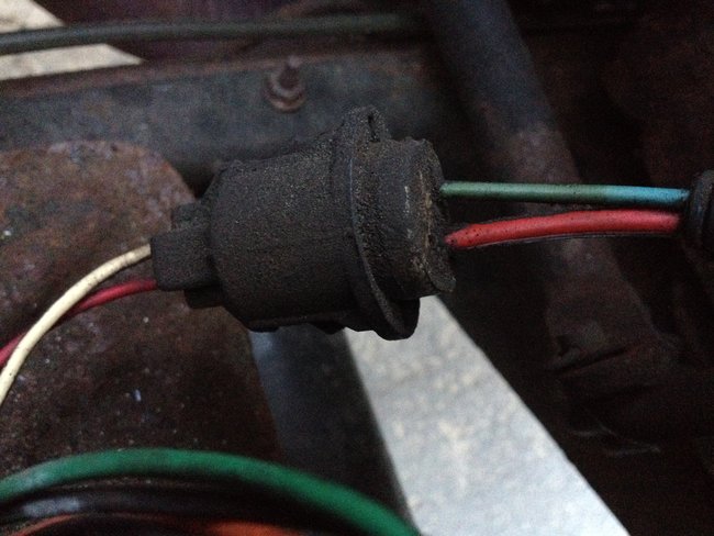

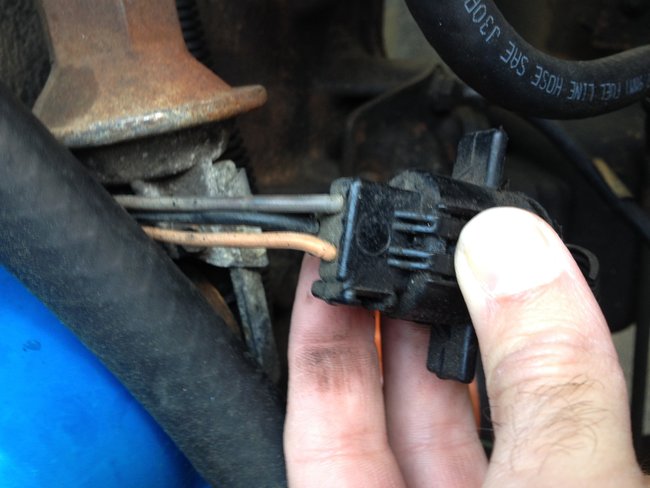

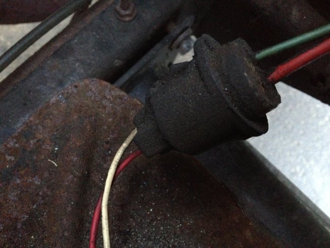

Send me a pic of the distributor connection too.
I wanna see the wires on both sides of connector.

CJA31186
  • 89 POSTS
Ignition module pics. Man now you tell me to get pics of the distributor wires.I have to wait until tomorrow now. Haha. Just kidding. Im anxious to get this underway. I have more pictures of the igniTion module wires so let me know if this is enough.
Monday, May 15th, 2017 AT 6:16 PM

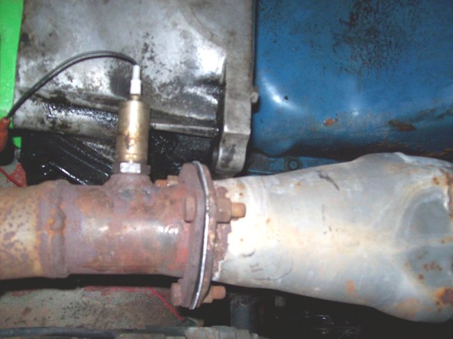

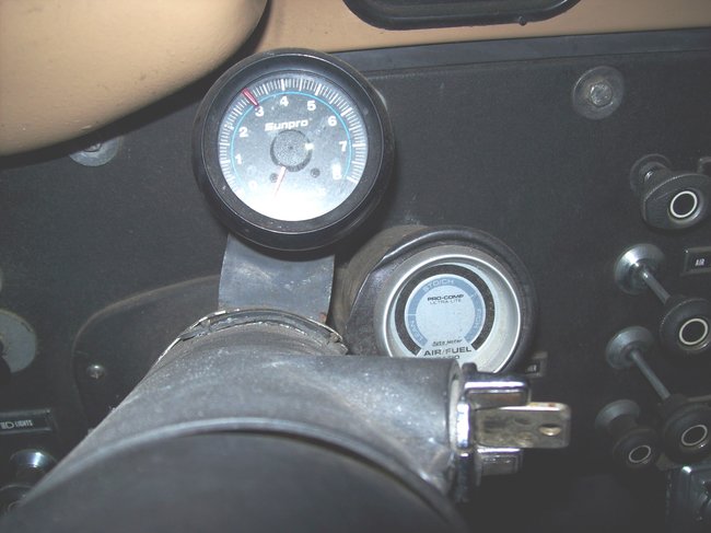

Let's keep the O2 sensor installed, you can use it to run a air/ fuel ratio gauge if desired (that's all it runs). On my '77, I had to drill a hole in my exhaust/ install a bung/ install an O2 sensor. With my Holley 390 CFM carb, it's been very useful in "Jetting" it correctly. Even if you don't need to jet (your BBD is just fine), it's a cool gauge, mine's on my steering column.

CJ MEDEVAC
  • 11,004 POSTS
Good pics!
Waiting on 'stributor,
Mainly want to see all wires at once on either side (colors and positions) fine, if it takes a few shots.

CJA31186
  • 89 POSTS

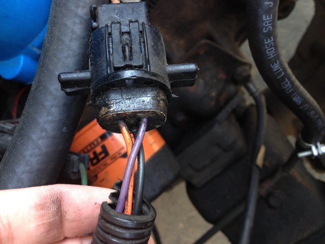

Here are the distributor wires.

CJ MEDEVAC
  • 11,004 POSTS
Good deal!
Got in pretty late, I'll try to get you some ign info tomorrow.
