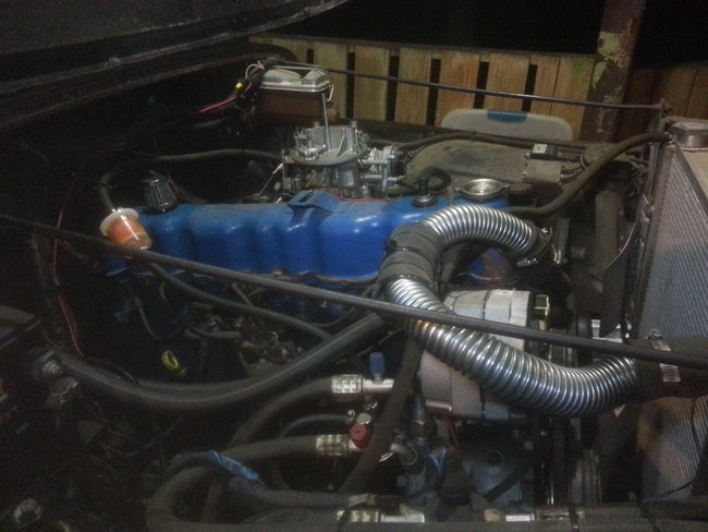

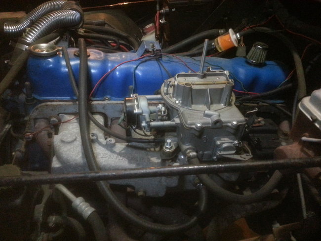

Vehicle has been sitting for about a year. Ran prior to sitting it would start it up every few months. Seemed to idle fine. Started it up today, got it on the street and it did not make it two blocks before sputtering out. Would start right back up but when I come to a stop, it dies. Seemed to drive in first and second, until I stop. Got it out on the road way (45 mph) and could not get it to go over 35 mph. Pressed on the gas, but was not going anywhere. It has a 256 in-line 6 / 2BB Motorcraft carburetor. I can understand/grasp mechanics but I am not too experienced with it. Any help would be greatly appreciated.

Send pics of both sides of the engine if you will (breather removed)
Look at all vacuum hoses for cracks, very loose, completely fell off.
Are you capable of tuning the carb correctly? (with my help!)
Got an Offy? Me too!
Have you messed with adjustments since the last time it ran well?

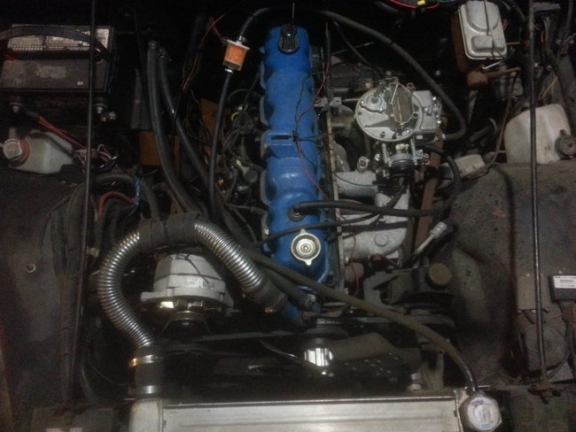

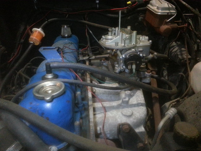

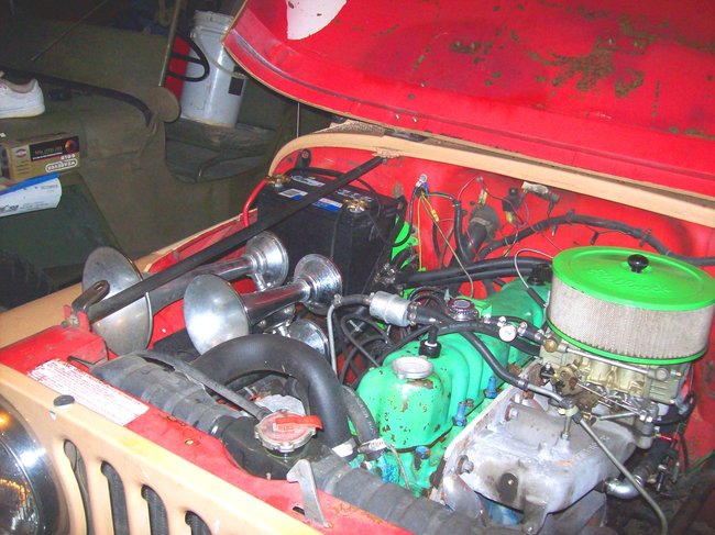

Alright. Got the pictures. I'm going to pick up some new port covers and carb cleaner tomorrow. Had to stop working on the Jeep and replace the power brake booster on the xterra that I have. I got it off last night and will attempt to put the new one on tonight. It has been my daily while I'm repairing the Jeep. The pictures came out a little darker than I had hoped for and the engine is a lot dirtier than I would like. I haven't gotten her to the car wash in a while. I think I have the vacuum hoses hooked up correctly but not entirely certain.

When the Jeep is idling,
Is there vacuum present at the distributor's advance? (if you take the line loose at the 'stributor, does the little actuator move on the 'stributor?) Or if you stick your tongue to the vacuum line, is it sucking?
There should be no vacuum, until you rev the engine a little, then the arm should move.
There are 2 sorta regular types of vacuum
1) Manifold Vacuum (from below the throttle plates) It is constant sucking
2) Ported Vacuum (from even with/ or above the throttle plates) Only sucks when the throttle plates are open or begin to open.
The distributor needs PORTED VACUUM!
Have you Checked out the Tuning stuff in the "Stalls When Hot" link I sent?
Any betterment from seeing/ doing the tuning?
Will it idle?
Do you have a timing light? We can check the advance(s) for the 'stributor, to see if they work.
I noticed your fuel system to the carb has been changed from OEM, Does your Jeep's carb flood out, making it die?

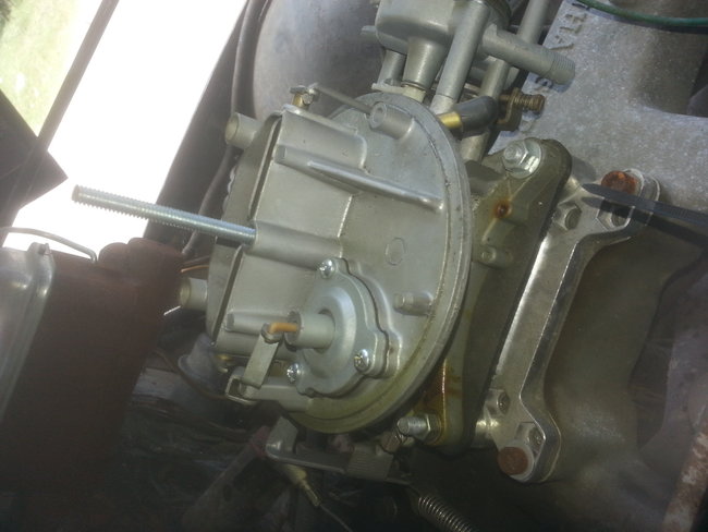

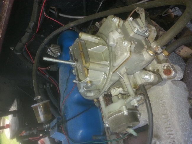

Just posting an update. It's been a while but I finally got it running. I took the carburetor off, took it apart, cleaned it, rebuilt it (using a rebuild kit), put it back on. Poured a little fuel in there to get it going and it started right up. Idles a little high (800 - 900 rpm) but I can work with that. Not sure if the mixture is perfect but it's running and pretty smooth at that. I'm assuming that the main issue was clogged ports in the carburetor due to the fuel sitting for so long. I would like to shout out to CJ MEDEVAC, thanks for your assistance and patience.
