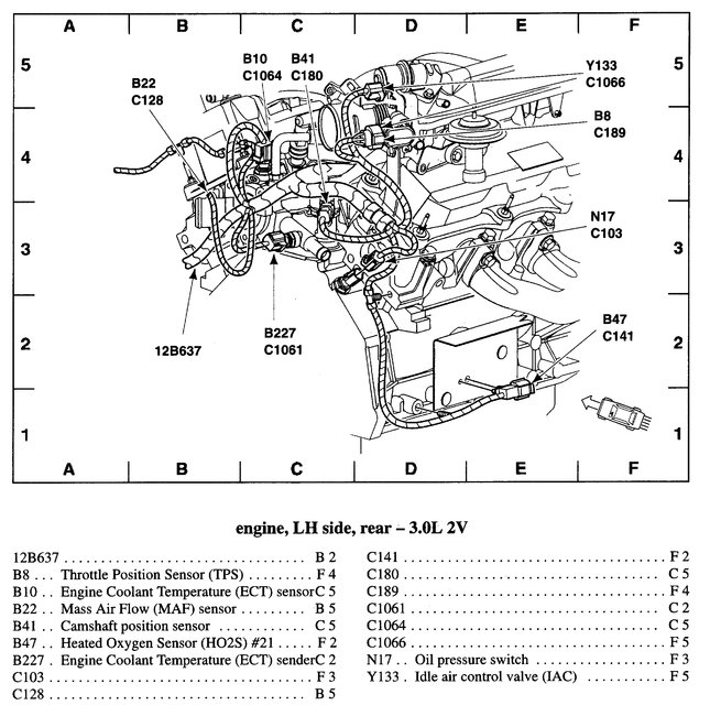

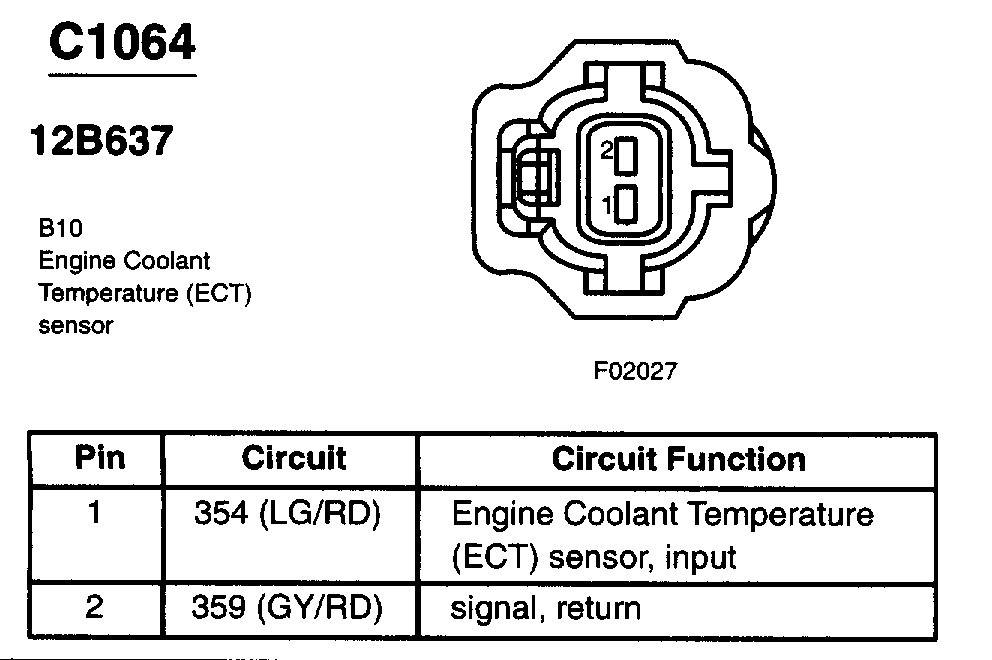

My check engine light is on. How many wires do the coolant sensor have?
Dec 10, 2018 at 8:22 AM
  • 110,240 POSTS
There are two for the coolant temperature sensor. I attached two pictures. First shows location, and the second the connector. THis guide can help find out why the check engine light is on.
Let me know if this is what you needed or if you have other questions. Check out the diagrams (Below). Please let us know what you find. We are interested to see what it is.

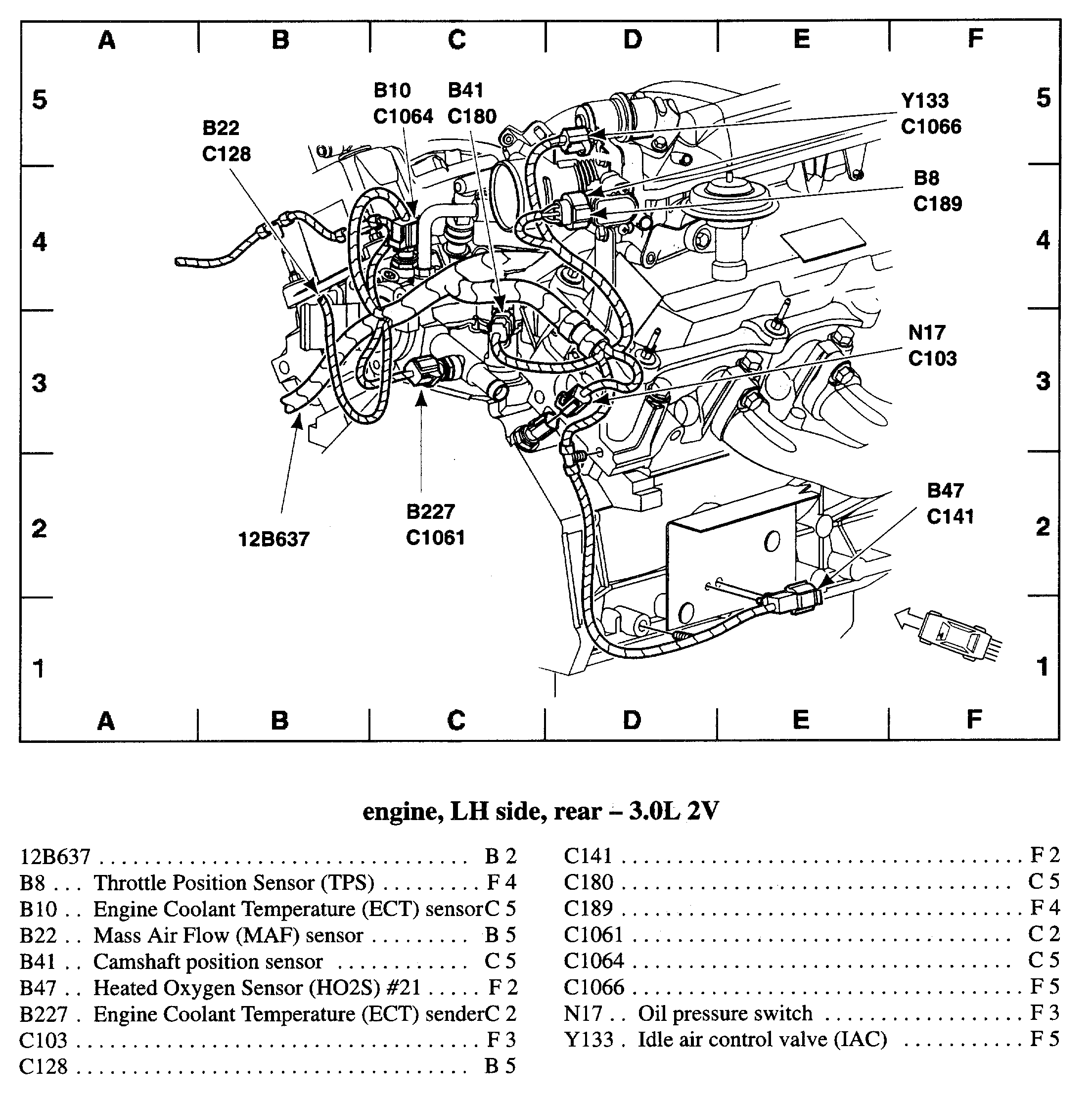

  • 11 POSTS
Yesterday the check engine light came on so I took it down to NAPA to have it diagnosed. The error codes came back as P0401 and P0402. Seeing how the codes mean "P0401-too little flow on the EGR system and P0402-excessive flow on the EGR system", I am confused about what to replace. I have replaced the EGR valve about 4000 miles ago and the EGR pressure sensor at the same time. Any help with a solution?
Oct 24, 2020 at 4:57 AM (Merged)
DOCFIXIT
  • 18,828 POSTS
Hi
Most common cause for both codes at same time is vacuum leak, pluged hoses or pinched, cracked hose. see diagram make sure all hoses are good and flow.
