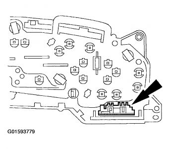

BERNIEUSC
In getting the car inspected, I was told the check engine light was burned ut. How do I replace?
Oct 24, 2020 at 5:20 AM (Merged)
BMRFIXIT
  • 19,053 POSTS
Lights is in the instrument panel remove the instrument cluster need manual CHECK IT @ https://www.2carpros.com/kpages/auto_repair_manuals.htm
https://images.2carpros.com/forum/automotive_pictures/99387_Graphic_38.jpg
