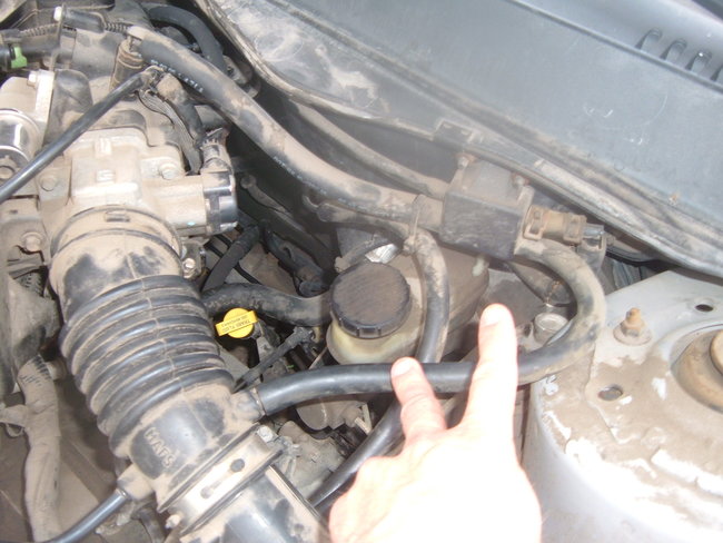

1970GREENOLDS
  • 16 POSTS
Okay, I found it, that one hose leads to a small square box along with three other hoses and one of those hoses does lead to the air cleaner tube that goes to the throttle body. should i hook up to that one?
Oct 24, 2020 at 4:17 AM (Merged)
SATURNTECH9
  • 30,869 POSTS
I wish I had a picture of that, you want one that leads directly into the intake manifold..
1970GREENOLDS
  • 16 POSTS
click on picture to make larger.
SATURNTECH9
  • 30,869 POSTS
Hook it to that big hose that goes right behind your throttle body.
1970GREENOLDS
  • 16 POSTS
okay, I will try that. Thanks

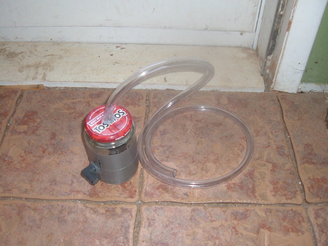

1970GREENOLDS
  • 16 POSTS
another question; i need something that smokes to put in the glass jar. i found a product that you use outside that you light and it just smokes, but it has a citrus smell to it. Do you think that would be a problem if i use it? it is a round green coil that is use to help keep insect at bay or should i just use a charcoal bis that you get hot place cardboard around it and it smokes.

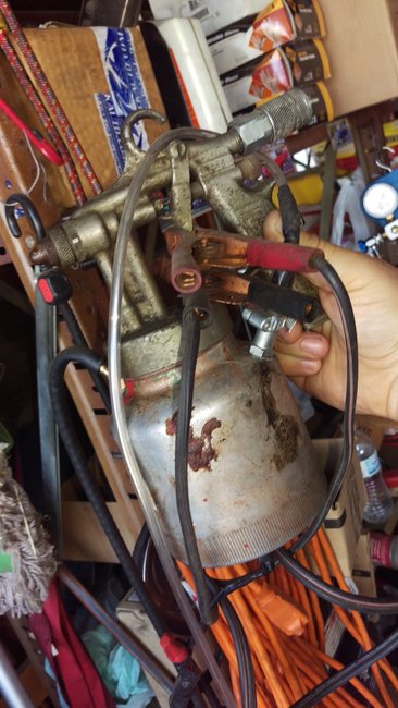

SATURNTECH9
  • 30,869 POSTS
Can you post a picture of your smoke machine? I used a old metal paint sprayer.With a glow plug on the bottom and I use unscented mineral oil from a feed and tack store. I pressurize the machine with a asthma nubulizer machine. Put the inlet and outlet nipples on the top of the paint cup. It works really good.
SATURNTECH9
  • 30,869 POSTS
I first tried a fogger machine, bad idea did not work out so well. As far as what your talking about I would not go those routes. That is why I asked to see a picture of what your building.
1970GREENOLDS
  • 16 POSTS
On this one, you hook up a small portable tire pump to it (on side of jar) and it blows smoke up. did you have random misfire when you did the smoke thing and if so did you find a leak? The mechanic suggested i change the wires as they are original, do think they can go bad and also the coil pack?
1970GREENOLDS
  • 16 POSTS
i have seen this smoker made and used from start to finish on youtube.

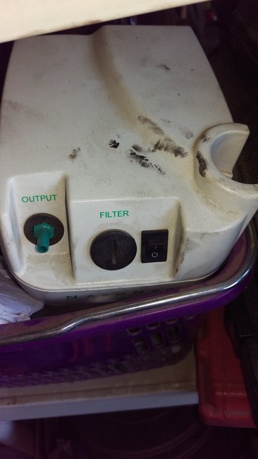

To answer your question the mineral oil smokes it works the same way the one on the tool truck works. Are you using the pump fill car tires with? If so that is way too much pressure you only use very little pressure.
1970GREENOLDS
  • 16 POSTS
okay, yes, but it is a small portable one and takes awhile to air a tire up, so i am thinking it is less powerful then a large portable one or the type you use at a gas station. you just notice it at idle and even then it is not all the time. When the mechanic hooked his scanner up to it (second time) the car was running and he pointed out that it is not doing it all the time. I do not notice any problems when i drive it. the only thing i noticed a couple of times is when you put foot on gas peddle to go it seemed like the motor went engine went back then went. I do not know how else to describe it.
SATURNTECH9
  • 30,869 POSTS
The pump your using is too much pressure. You could damage gaskets parts etc You only use like a fish pump that runs a bubble rock in a fish tank. If it is only really during idle. It is not the wires when they go bad they miss typically under load. If there the original wires it would not be a bad thing to change them.
