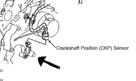

all new cars are controlled by a PCM (computer) every vehicle nowadays tells you where the fault lies by plugging in under the dash ... he won't do any more the autozone did ?? I would be checking the wires to it first before replacing .. but as you can see it's an easy replacement part .. DIY job .. this picture is from a 3.0L 2V let me know which engine you have for another picture .. let me know Crankshaft Position (CKP) Sensor (3.0L 2V)On lower right front of engine. See Fig. 1 . Crankshaft Position (CKP) Sensor (3.0L 2V FFV)On lower right front of engine. Crankshaft Position (CKP) Sensor (3.0L 4V)On lower right front of engine. See Fig. 5 .

Wow, Pictures!
I actually do not know which of those model Ford Taurus' that I have. I know there are no FFV signs on the Fender or Trunk Lid advertising alternate Fuel.
I am sure that it has a 3.0 Liter engine sitting sideways in the engine bay. I am guessing the 2V and 4V designates how many Valves per cyclinder? It is not a "SHO" Model; so I would have to guess it is the 3.0 2V model.
It does have bucket seats and the Automatic Transmission Shifter in the Center Console.
I tried looking on stickers at the front of the engine bay and inside the driver's door, but I didn't see anything that told me anything relative.
I did open the engine bay and standing by the front passenger side fender I saw some electic wiring and a plastic connector hanging down just to the left of the Serpentine Belt that runs to the alternator and other places.
I couldn't hardly get my hand down in there to even touch it, let alone check connections or change anything. It looks like you would have to practically lift the motor out or drill a hole through the inner fender well to get to it. With it hanging so low to the bottom of the engine I can see why it would get a lot of water on it splashed up from the road.
So, I saw this stuff hanging there to the left of the Serpentine Belt, but not knowing what a Crank Sensor looks like, I am not positive about it. Is the Crank Sensor just something that plugs into a wiring harness, or do you have to un-bolt something from the engine?
Thanks for all your help.

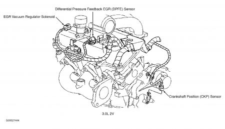

the actual sensor is where my arrow is pointing .. it just bolts on with one bolt .. unplug the connector that the other arrow points at ..as you can see the connector goes onto CKP

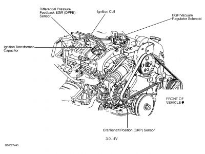

This is a picture of the 3.0L 4V .. it also gives you a better idea of where the CKP is actually located ... it sit's almost connecting to the crank pulley ??

Thanks Dave. It's dark out there now, but tomorrow I'll have to take a better look at it. Perhaps if I pull the car up on a set of ramps and then crawl underneath, I can then get a good look at it and an idea if I want to try tackling the job myself or not.
You don't happen to know what a Crank Sensor might cost me do you? $20.? $50.? $100.?

trust me when you see it .. you will do it yourself .. it's one bolt and unclip the wire's ... because of where it is, it may just need a good cleaning and check of the wires .. ??
OEM dealer(ford) part price is $45.00 ... you can probably get it a lot cheaper at autozone ..
