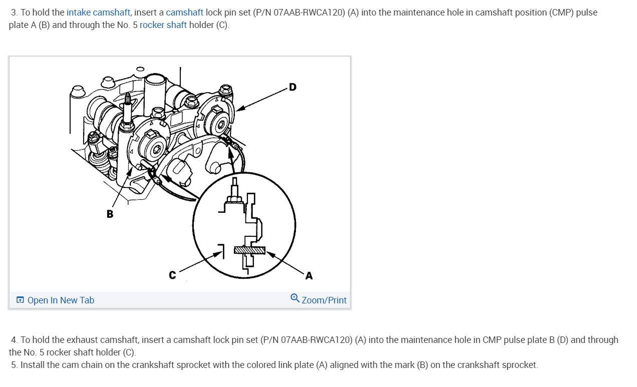

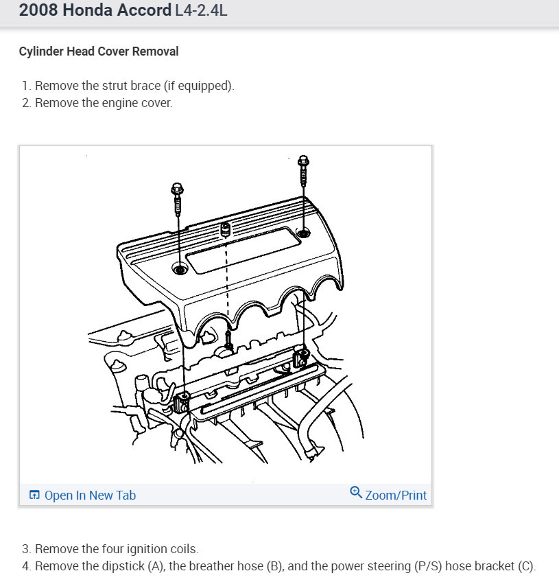

blown head gasket
2008 HONDA ACCORD
70,000 MILES • 4 CYL • FWD • AUTOMATIC
ROSSIANABUDEL

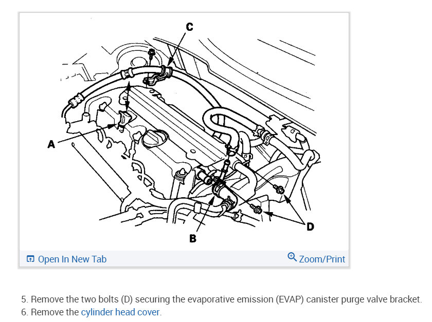

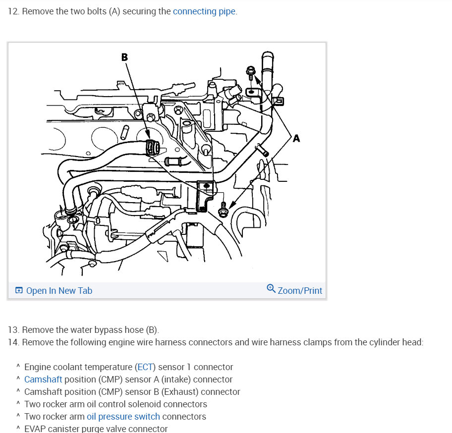

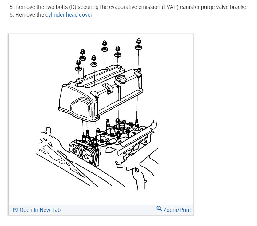

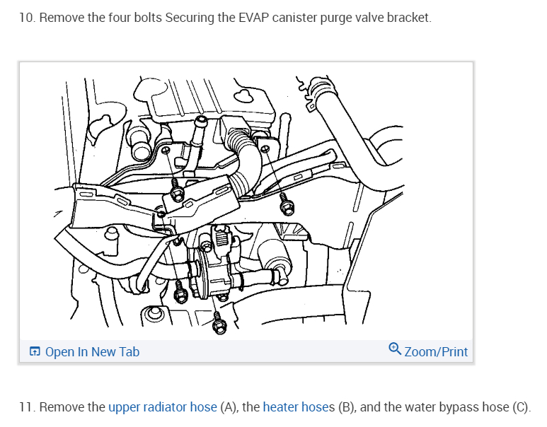

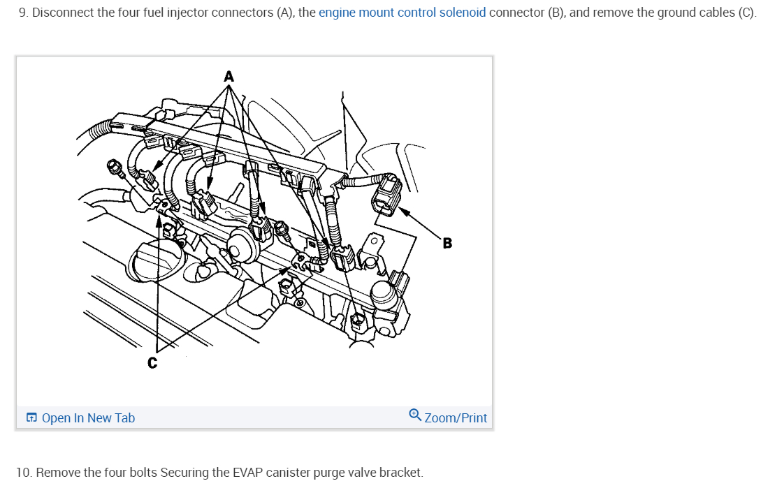

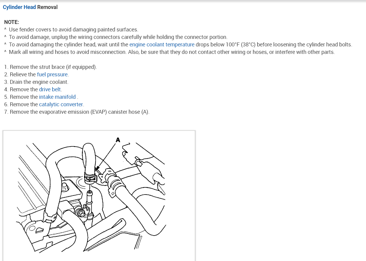

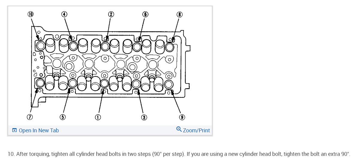

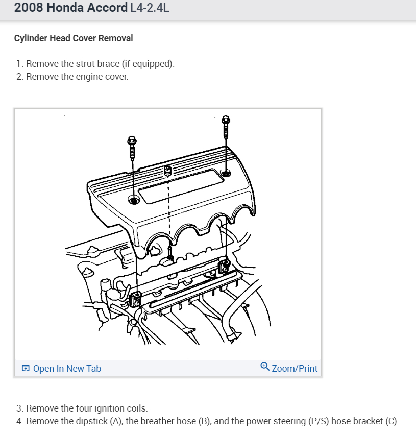

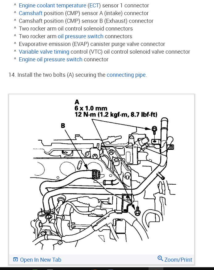

i think the head gasket of my honda accord blew because of a too high pressure bar of the radiator cap which caused overheating of the engine. which steps should i take to replace the head gasket?
Feb 16, 2009 at 4:00 AM
  • 75,992 POSTS
You must start by disconnecting the battery and draining the coolant. Also once the head is off have it remachined so it is flat or the new gasket will fail prematurely. Also change the oil in the engine when the job is complete and remove the timing chain or belt with the water pump as well for w complete job so you can use the car. Here are the instructions and diagrams on how to change the head gasket by removing the cylinder head in the images below. Click to enlarge. Check out the diagrams (Below). Please let us know if you need anything else to get the problem fixed.

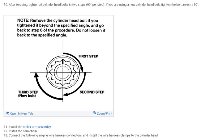

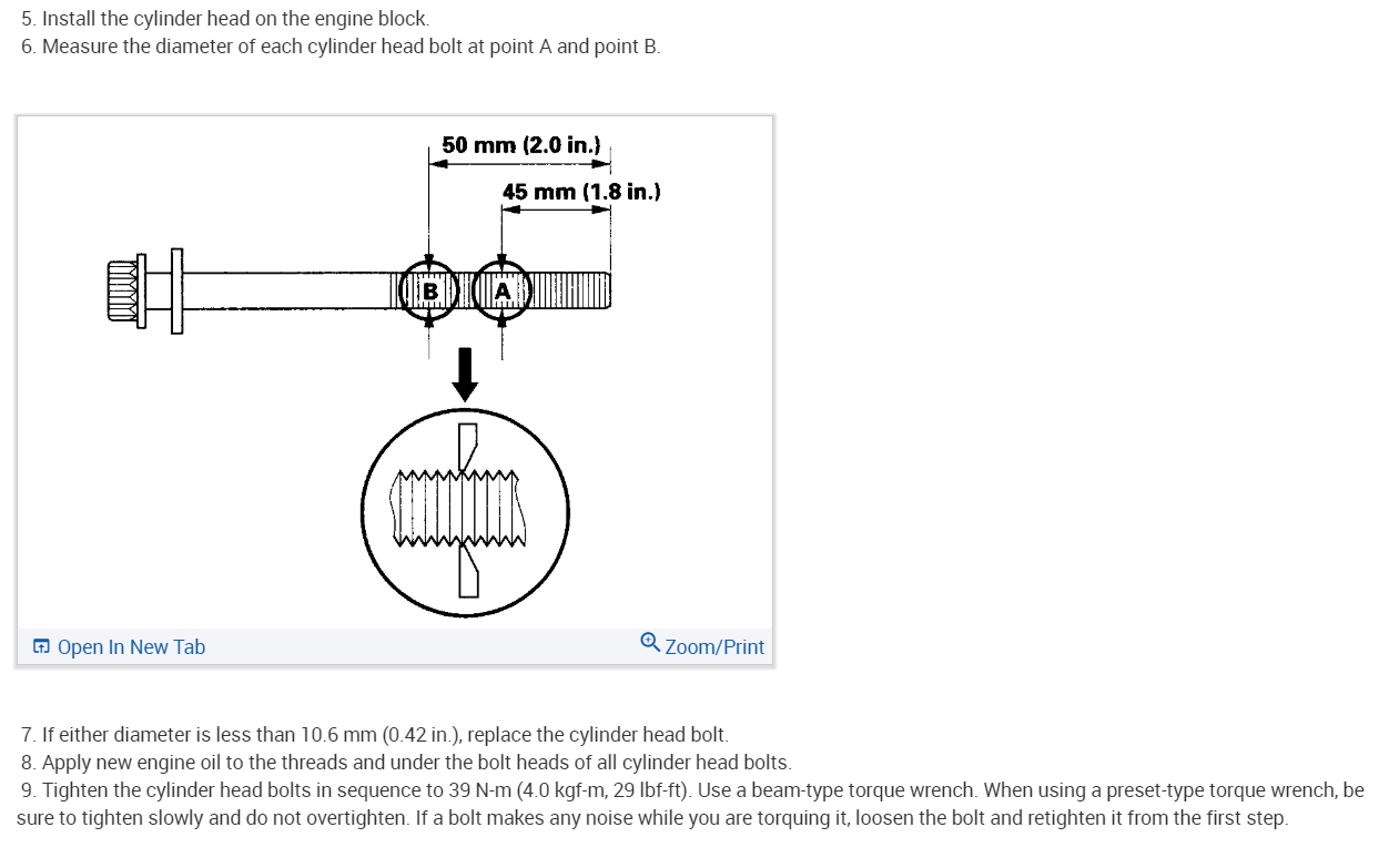

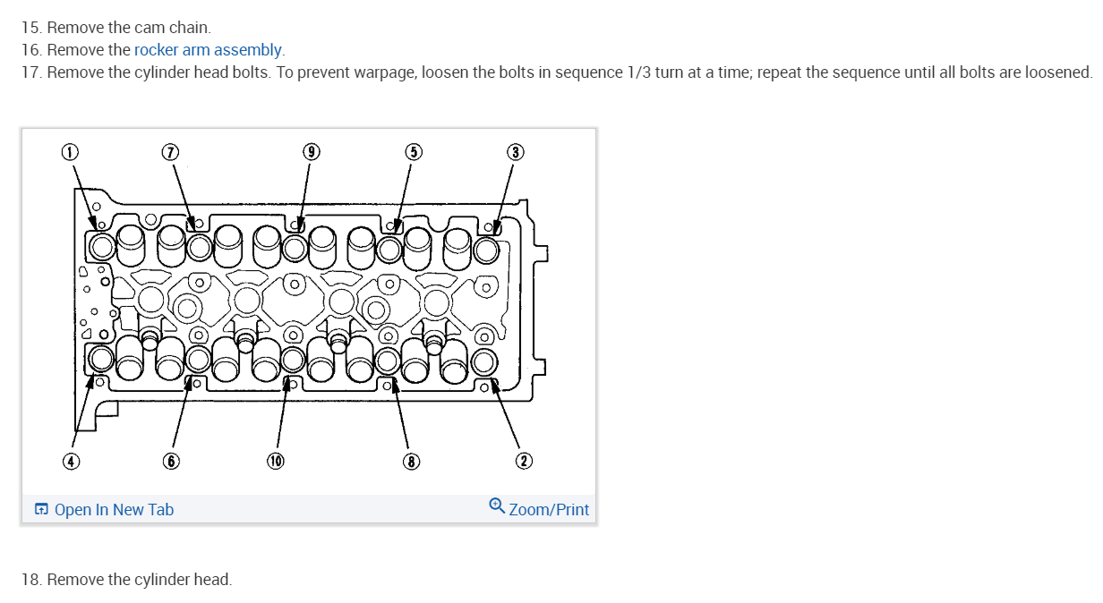

I have a 1999 Honda Accord LX 4cylinder 2.3 liter and the oil is getting into the radiator. I had a back yard mechanic replace the head gasket but just the head gasket and the car did great for about 500 miles and it started to do it again. I think that he did not do it right. Also it has a new radiator and there is no crack in the block so that is not it.
Feb 13, 2019 at 4:16 AM (Merged)
there may be a crack in the block that you cannot see.
did your guy replace the head bolts with new ones?? if not, that most likely may be the cause which means it has to come off again and be re done correctly.
MILTONASHLEY25
  • 8 POSTS
no he used the same old ones....and if that is not it what else could it be
that is it. they are torque to yield bolts and cannot be re used. when you remove the head again, take the time to have a machine shop check it for warpage and cracks.
start there. you need this before going anywhere else.
